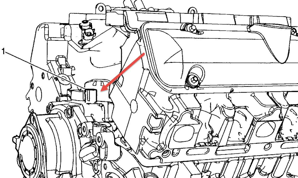

I need a engine variable timing solenoid can I drive car until next month that is when I will have money to get repaired?
Apr 30, 2017 at 12:11 PM
HMAC300
Experienced Mechanic
48,601 POSTS
it may not get very good gas mileage you can check to see if screen is clogged and if it is clean with choke cleaner then reinstall it. See picture.
