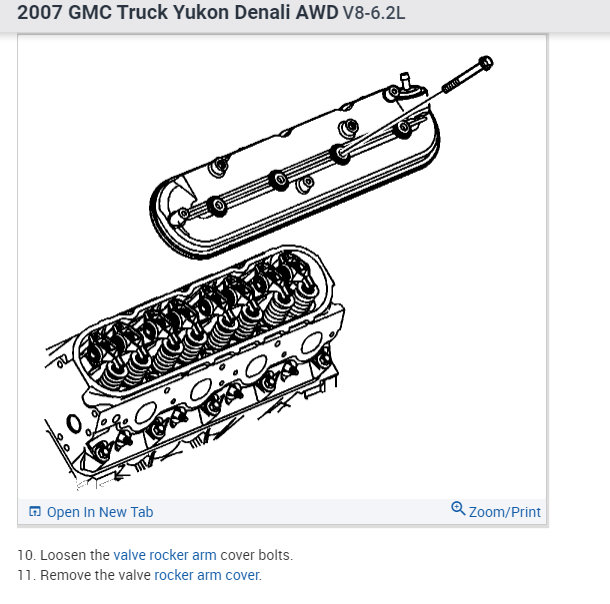

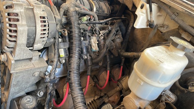

Dear Experts,
I would like to know if I can install Yukon Denali 2009 6.2 valve cover with PCV in my 2007 Denali?
A quick response will be highly appreciated.

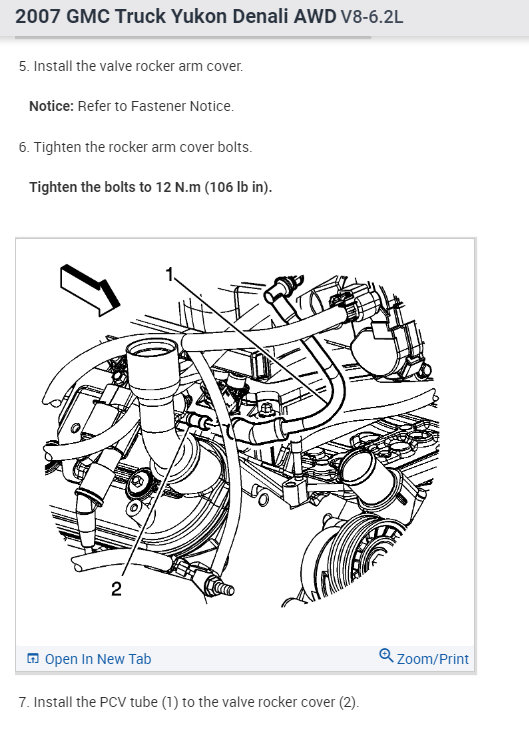

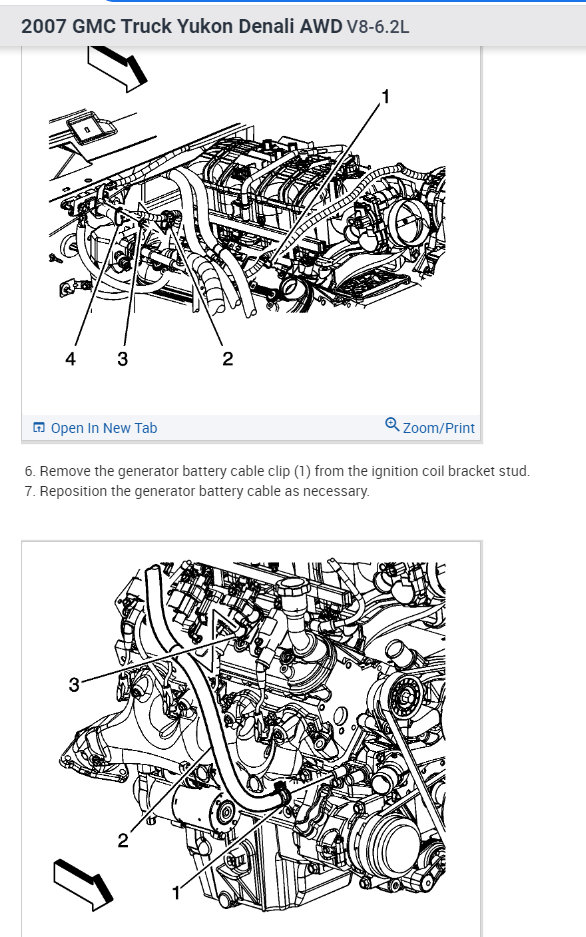

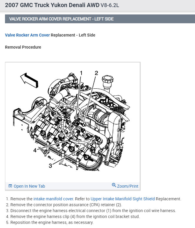

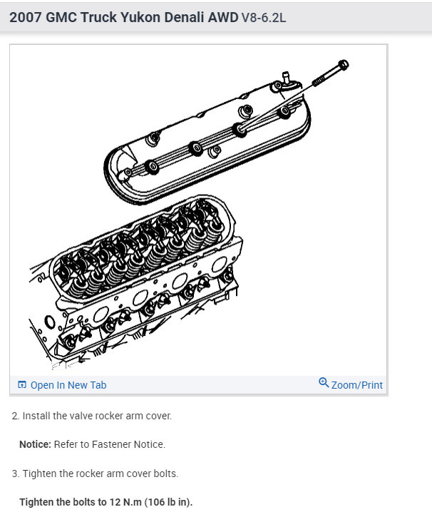

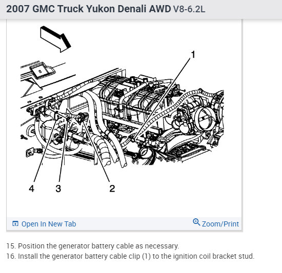

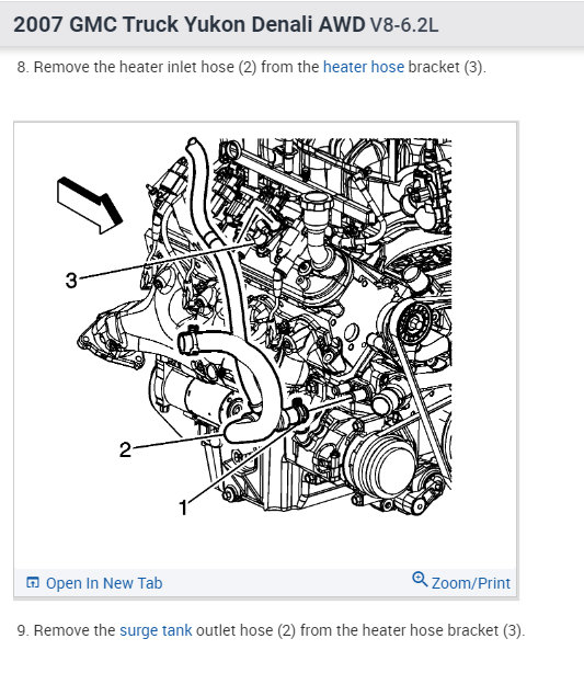

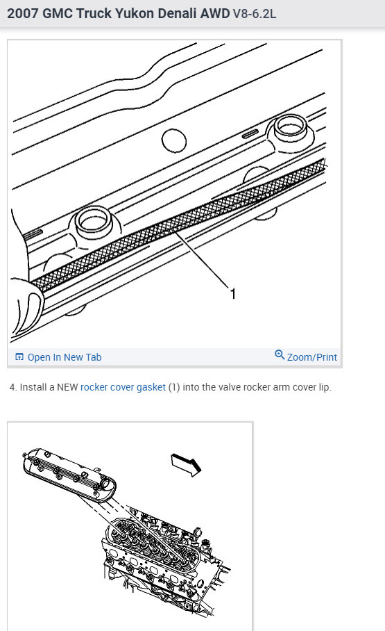

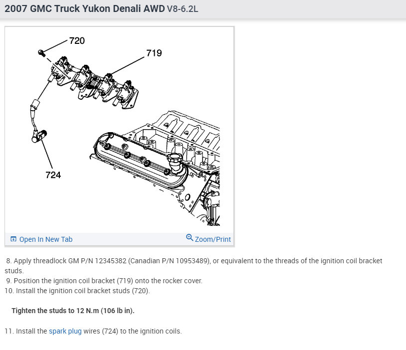

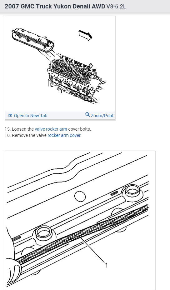

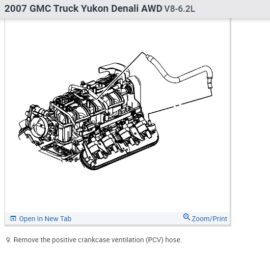

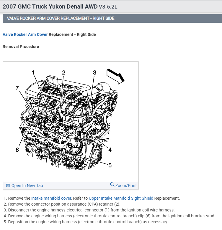

The valve cover from a 2009 Denali 6.2L will not fit the 2007 Denali 6.2L.
They are different with different part numbers.

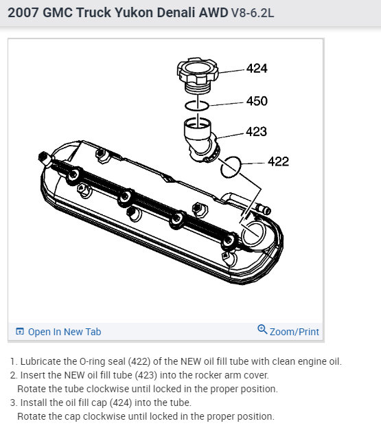

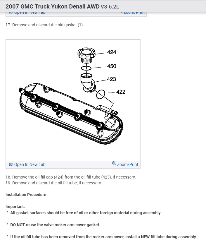

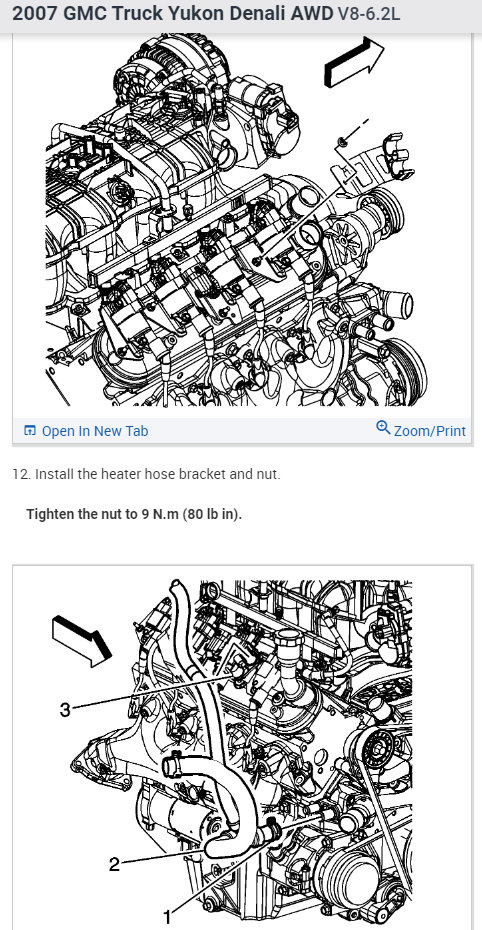

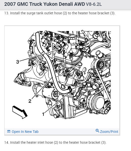

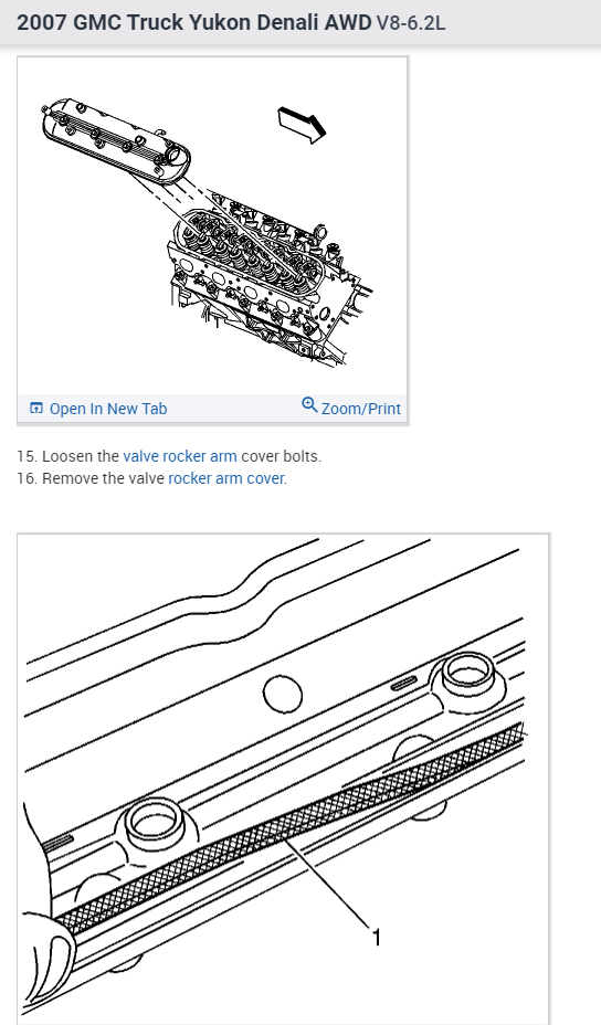

The OEM part numbers for the 2007 Denali 6.2L are 12582224 on the right and 12570427 on the left.

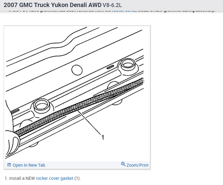

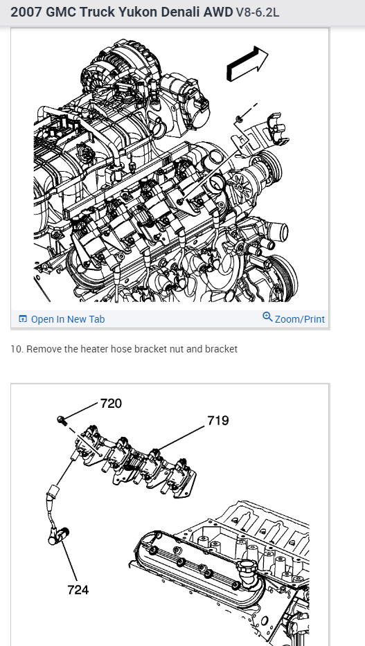

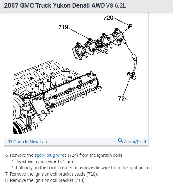

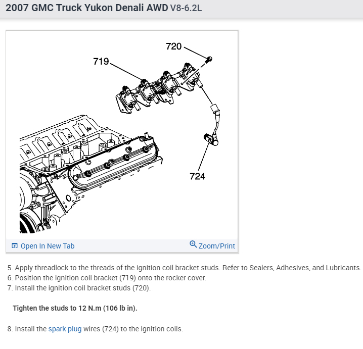

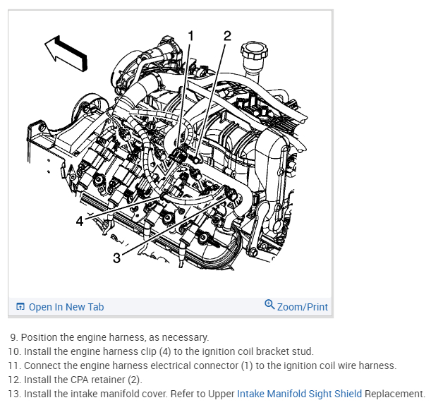

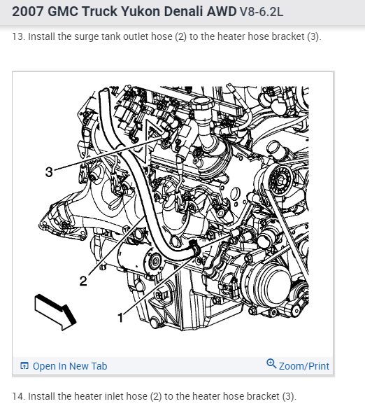

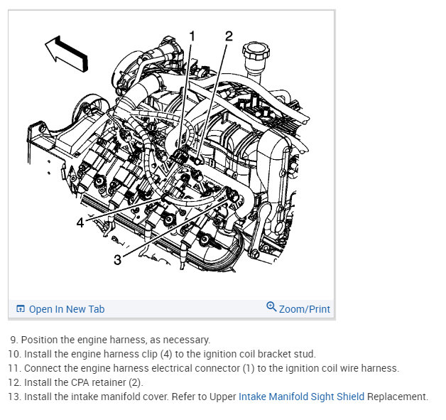

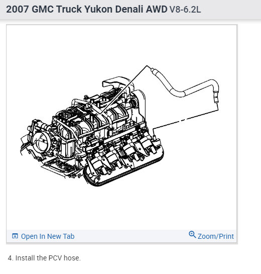

I have attached replacement procedure below for your reference.
Let me know of any questions.
https://www.2carpros.com/articles/replace-valve-cover-gasket

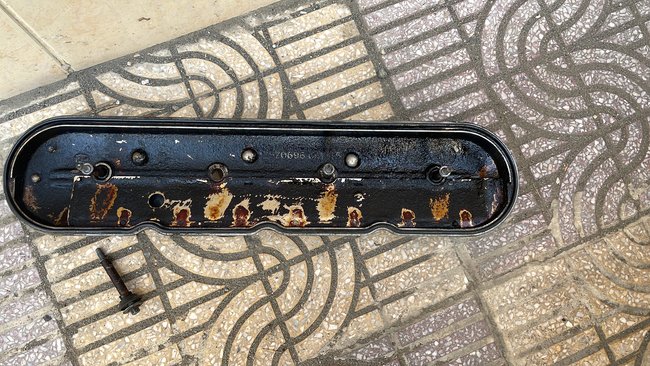

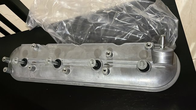

Thanks for your prompt reply. Actually, I bought valve cover of 2009 from one of the guys i know from the spare parts shop. He said there is only difference in PCV valve length that can be altered. I have searched each and every shop in my city and they all are selling for 2009 with updated baffle plate.
I will try to install it and let you know.

Today I changed the valve cover from Yukon Denali 2009 into my 2007. Car started fine no leakage till now. Before my car was running on an old valve cover with variable orifice PCV and now i changed to 2009 upgraded valve cover with fixed orifice PCV valve. No fault codes till now. Running perfect.

Solved the oil consumption issue. Its been 20 days and no trace of oil consumption.
