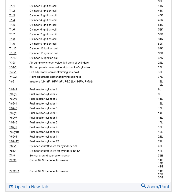

Started the car early morning the engine light came on and the engine vibrated, took the car to MB garage to check said right side cylinders not getting sparks, also the code which came on P0300 and 1,5,3,6,2,4.
Checked the right coil found it is sparking and working.
please help what to do?
Thanks
Ramzi
Apr 9, 2019 at 5:29 AM
  • 55,433 POSTS

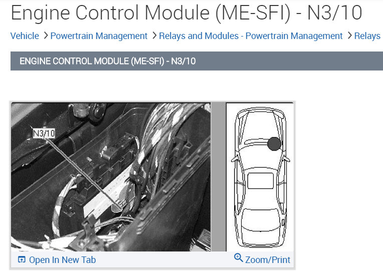

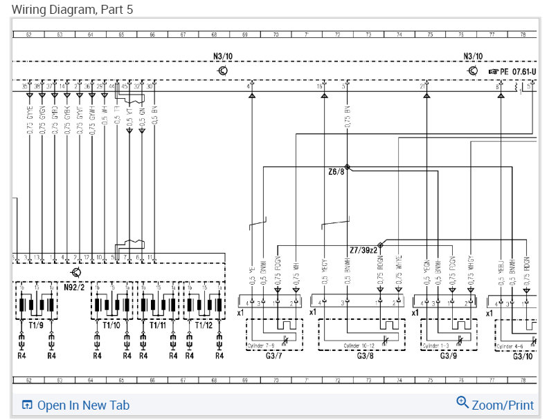

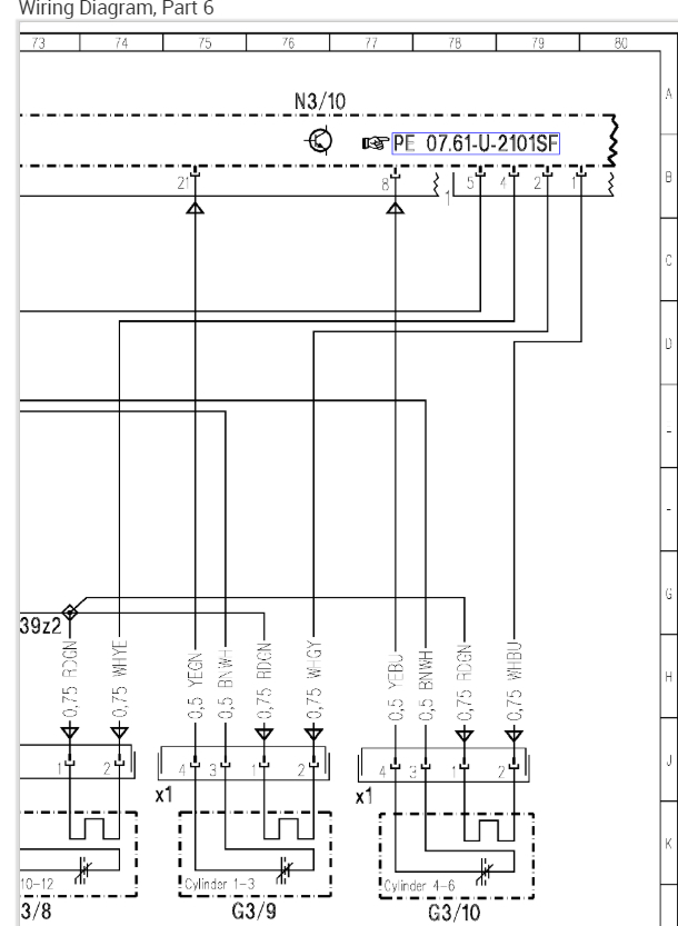

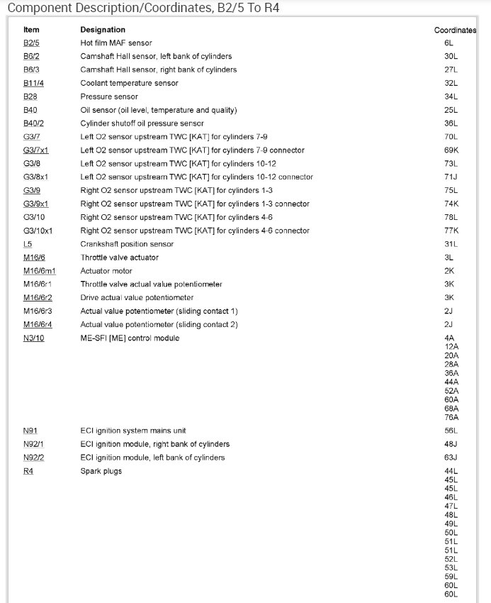

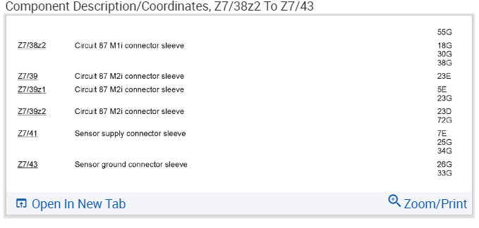

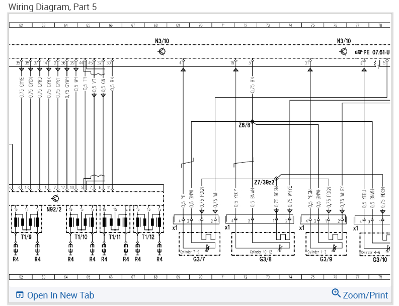

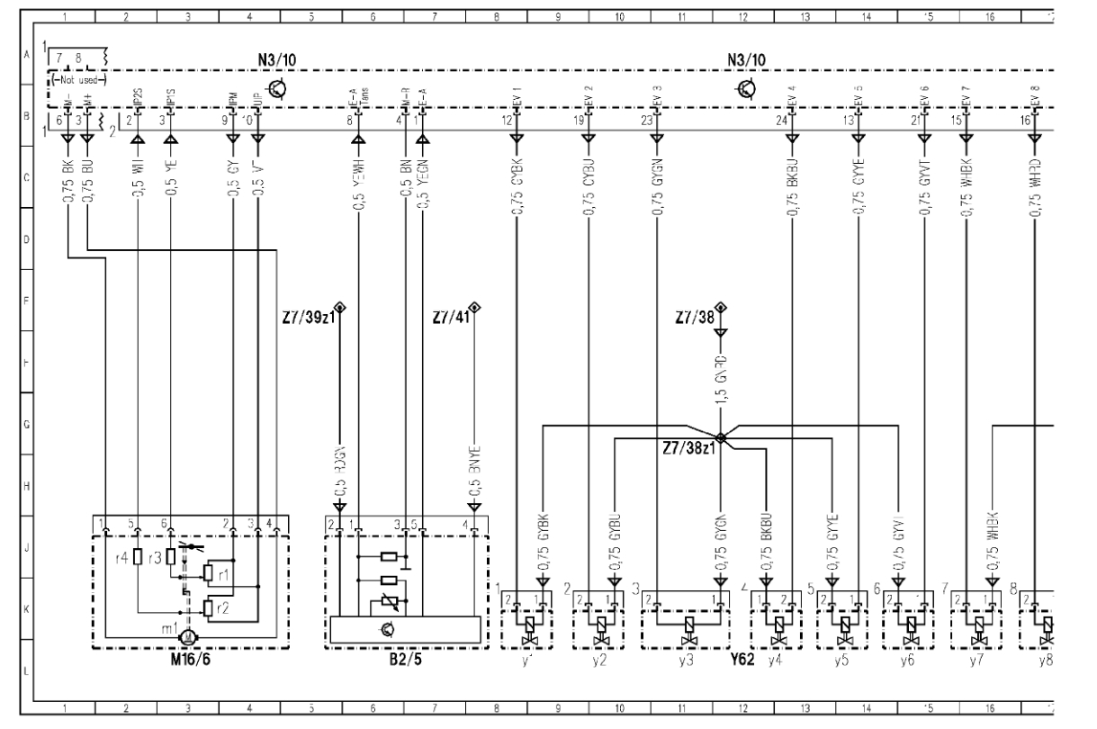

It sounds like you have a bad ground or the ECM when out. here is a guide and the wiring diagrams so you can see how the system works and to test the grounds and connections to confirm the failure:

Half of the ignition system is not working, i am not sure which switch you are talking about did they swap out the ECU?

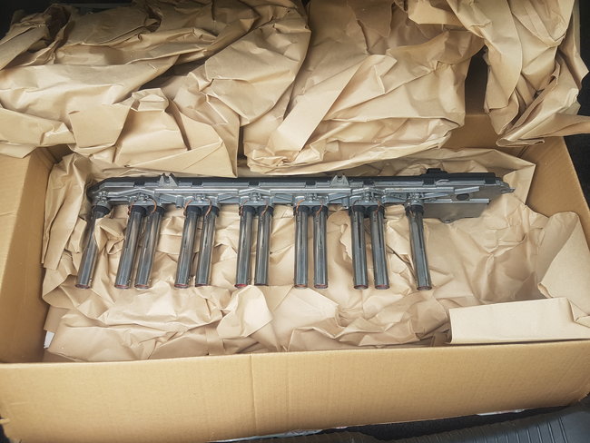

Refer to our conversation regarding my S600 issue, the issue solved by replacing the right coil with Mercedes benz original parts from eBay it cost me USD$682.00 and the spark plugs cost me USD$159.50, now the S600 runs smoothly, no more issues.

RAMZITH1
  • 79 POSTS
Dear Ken,
Please find attached the parts I replaced, of course it is used one.
Ramzi
May 9, 2019 at 9:37 AM
  • 55,433 POSTS
Great find! Glad you could get it fixed, that kind of problem can be tough. Please use 2CarPros anytime we are here to help. This post will help many :)
