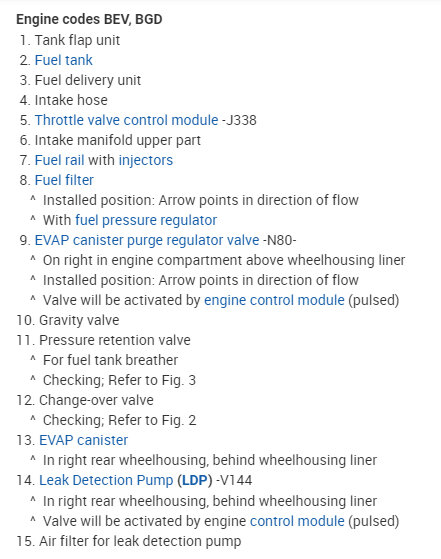

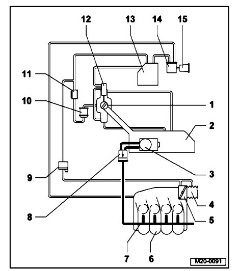

Looking for a diagram of the vacuum lines.

I was able to find a schematic for the vacuum system (EVAP). I attached it below. (See pic 1) Additionally, pic 2 below is the legend for the schematic. Take a look at it and let me know if it helps.
