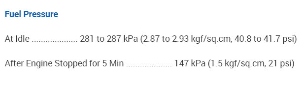

Just here to add my 2 cents. I would strongly suggest to actually test the output-pressure the fuel pump is actually providing.It sounds like you might have a weak or failing fuel pump.Just because you can hear it running doesn't mean it's performing at 100% especially at almost 300,000 miles. If you don't have access to a fuel pressure tester most auto parts stores have a tool loaner program and can rent you one.Here is a tutorial showing what is involved for testing fuel pressure:
After performing the test get back to us with the results and we'll go from there. I have attached a picture below of the pressure specifications for your truck.Hope this helps and thanks again for using 2CarPros.
