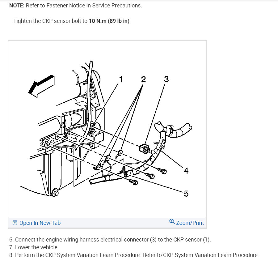

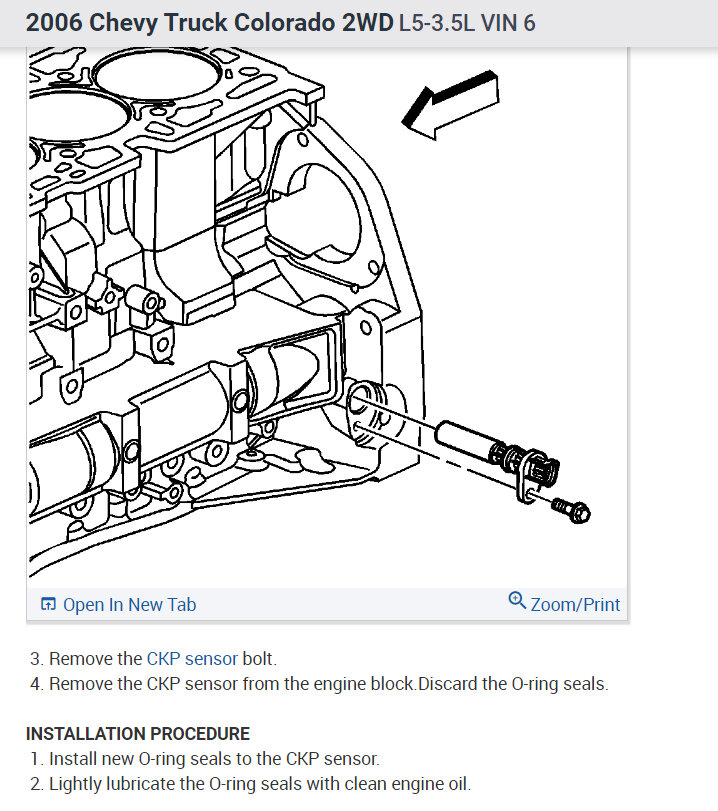

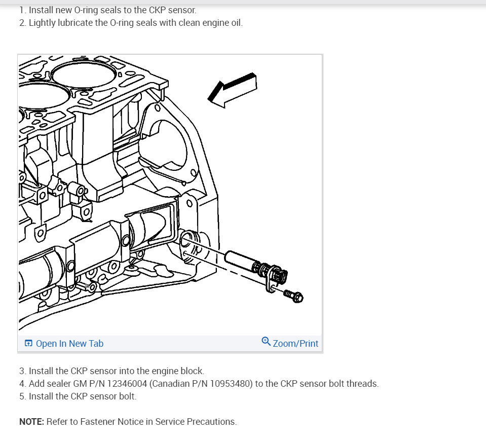

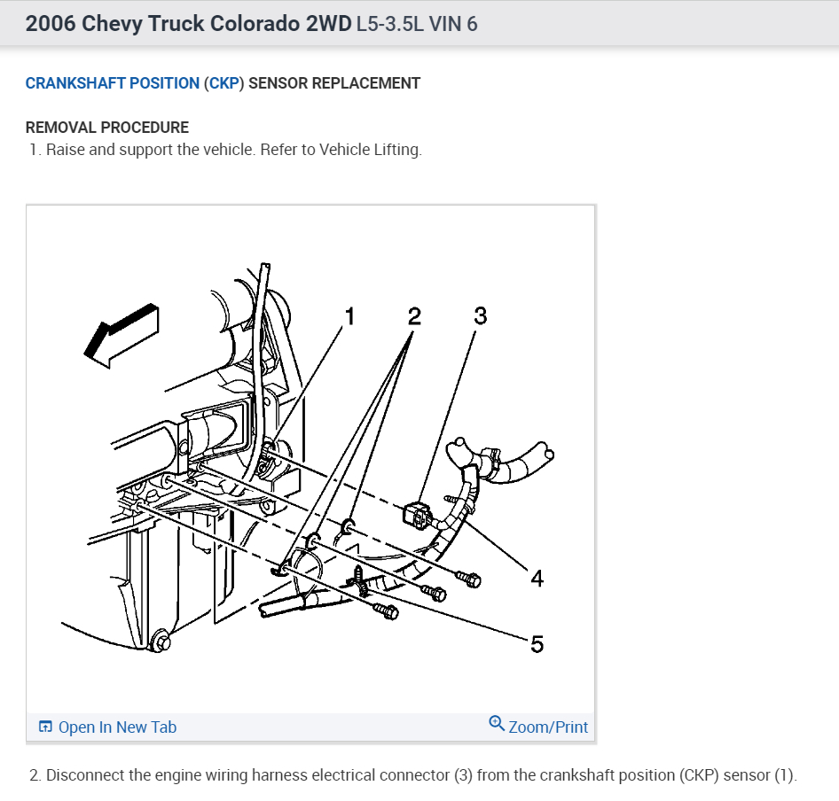

It sounds like the crankshaft angel sensor went out which will not leave a code but to be sure we need to check the ignition system for spark.
This video will show you how:
https://youtu.be/baq_aEWNQ0Y
Here is the location of the crankshaft sensor so you can change it out. Check out the images (below). Please let us know what happens. If it has spark, please upload a short video of the engine cranking over so I can tell if the engine is damaged. Check out the images (below). Please let us know what happens.
