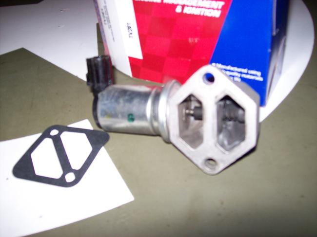

engine tries to stall at stop, not always, but intermittingly. getting worse. sometimes backfires. already replaced rotor cap and button, and new plug wires. any ideas? thanks, bob

i would look at spark plugs and coil out put

if you didn't do it, then replace the plugs. also check for vacuum leaks especially from the PCV tube

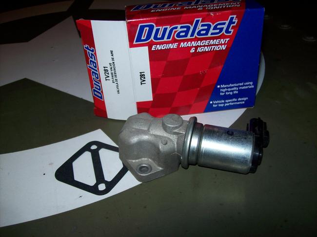

MAYBE IT'S THIS DEALEE?
.............YEAH, YOU GOTTA HEAR THE STORY!

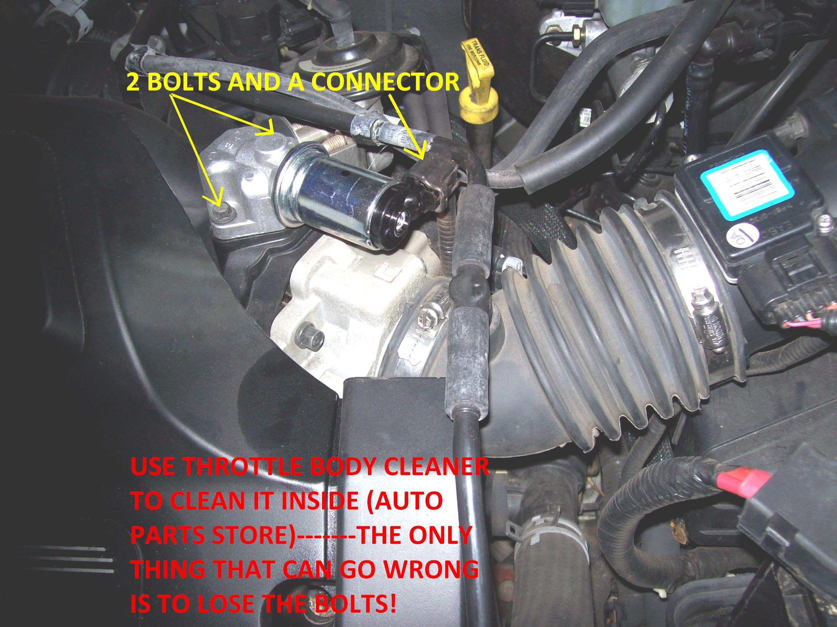

Well ...................here's something to try.......CHEAP AND EZ!
Gonna need a wrench or a socket and some "THROTTLE BODY CLEANER"
MY WIFES FORD ESCAPE THREW NO CODES!
Her Escape would idle low, then it got to point it would die when you stopped. Revving + holding brake was only way to keep it running.
I Took it to fellow R/C airplane pilot,he doubles as a S.C. State HWY DEPT mechanic. ....................When I got to his house , he was repairing a tractor.i
I Told him my sob story.
The Escape was still barely running, I raised the hood............... He said,(and I quote)
.............."It could be the IDLE AIR CONTROL (IAC)", as he pointed to it, and emphasized it with a sharp rap using the wrench in his hand. It straightened right up, and ran darn good!!!
HE SAID IT COULD JUST BE CLEANED, SO WE DID!........it was working fine!
..............That was a 15/16 Craftsman wrench, box end, kinda a medium "smack" LOL!........but true!
.........YES, I visited parts store and replaced it anyway. This is my wife's rig and I take no chances with her. (Or the "Wrath of Margaret"), should she break down during my watch!
I FIGGERED THAT IT HAD BEEN ON HERE SINCE 2002-2003, IT WOULD NOT HURT TO HAVE A NEW ONE, MAYBE IT WAS NOT WORN OUT YET, EVEN IF THIS HAD NOT BEEN THE "FIX" (THAT"S HOW I JUSTIFY STUFF TO MYSELF, ANYWAY)
The Ford was right on top, 2 bolts, unplug the wires.........so EZ to remove.....or Replace!the only thing that will be hard, is if you accidentally drop the bolts!
YES, I KNEW SOMEONE WOULD WANT TO SEE HOW "DIFFICULT" THIS WAS, SO I TOOK A FEW PICS MYSELF!
SHOULD YOU FIGGER THIS IS YOUR PROBLEM (FROM THE CLEANING), BUT STILL WANNA REPLACE IT....THIS MAY HELP THE OLE POCKETBOOK.......SEE THIS LINK

Here's the pics
REMEMBER THIS IS A FORD ESCAPE W/3.8L-----YOUR IAC LOOKS ALMOST IDENTICAL....JUST NOT IN THE SAME SPOT
