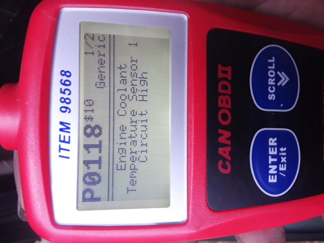

The car still starts and drives but the issue is the water is returning to the reservoir. I replaced the thermostat like the mechanic said.

Good afternoon,
The thermostat is not the issue.
You either have a failed head gasket or a bad water pump not circulating coolant in the engine.
https://www.2carpros.com/articles/water-pump
Is the car overheating?

I would say no. Gets hot but no overheating. Got a code P0118, Engine coolant temperature sensor circuits high.

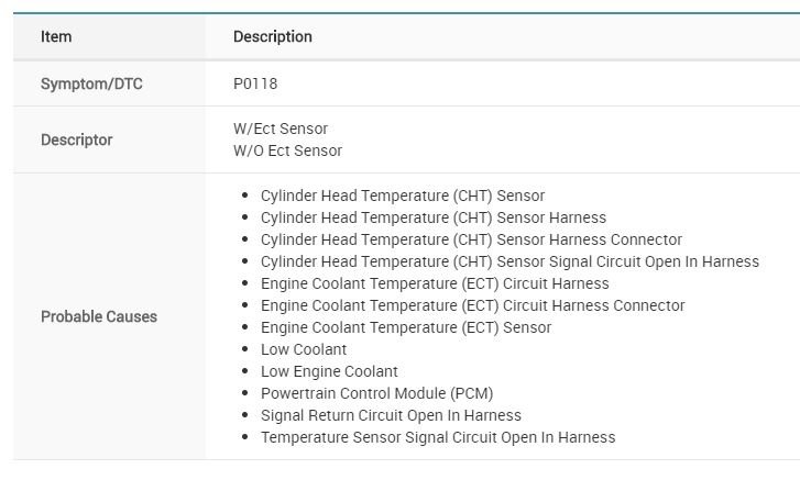

Okay, I attached the possible issues for the 118 but it has nothing to do with the coolant backing up. It is warning you the engine is hot only.
