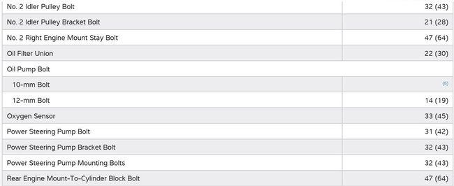

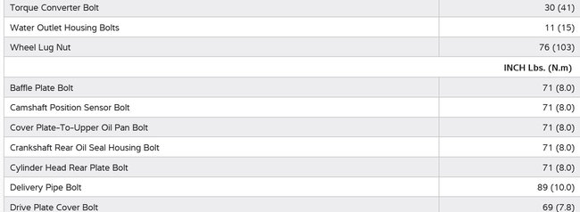

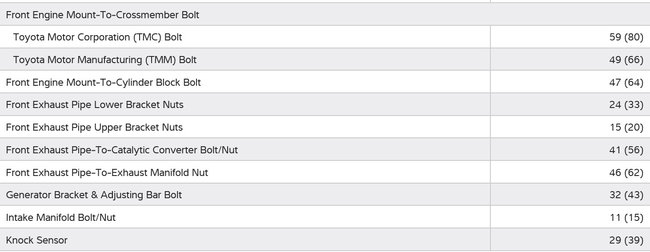

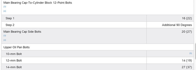

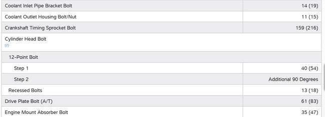

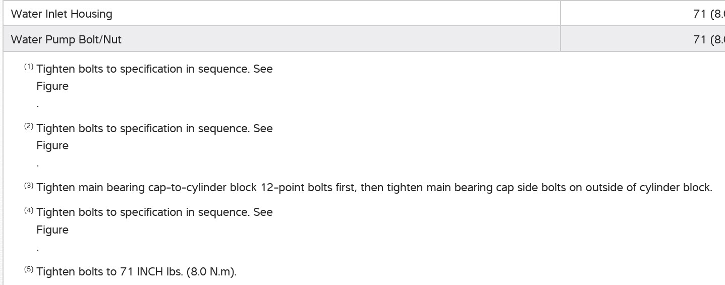

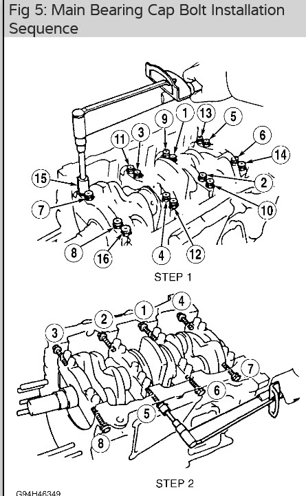

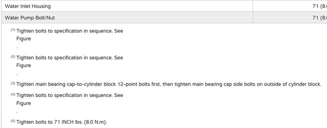

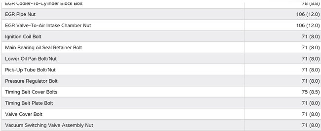

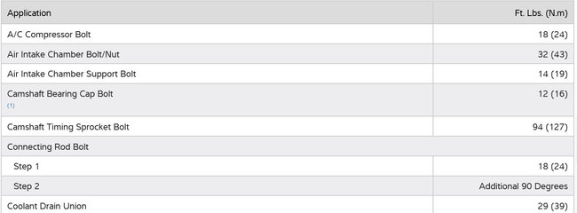

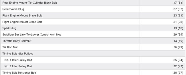

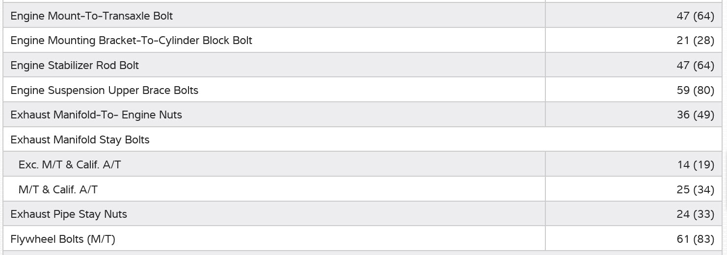

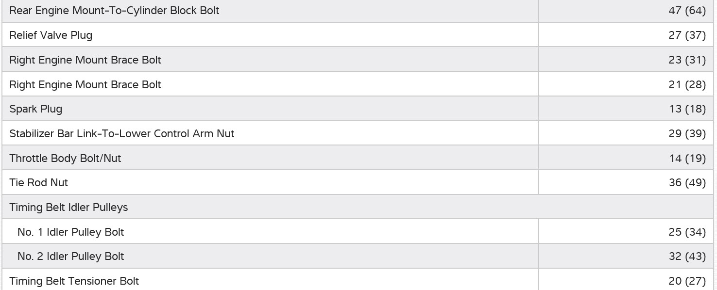

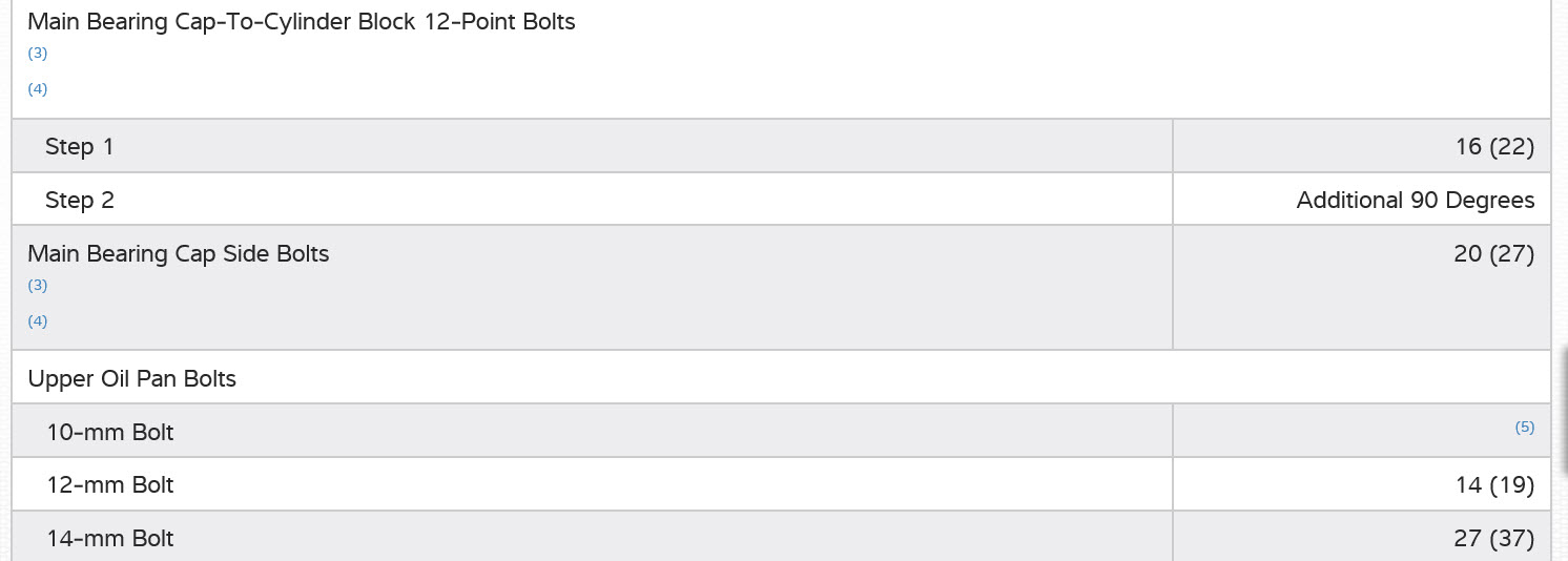

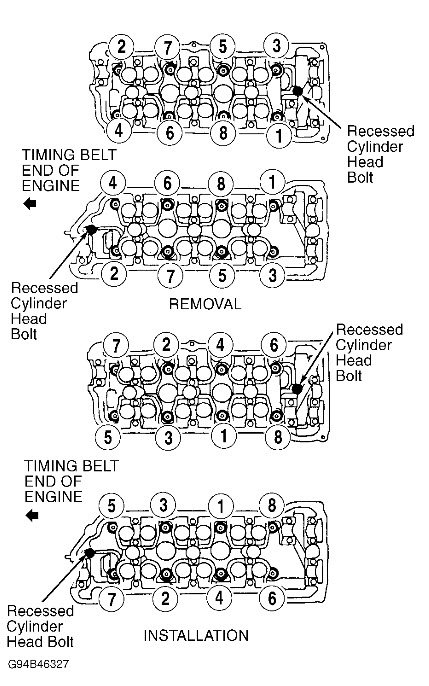

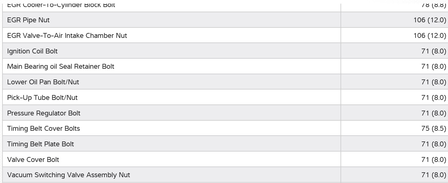

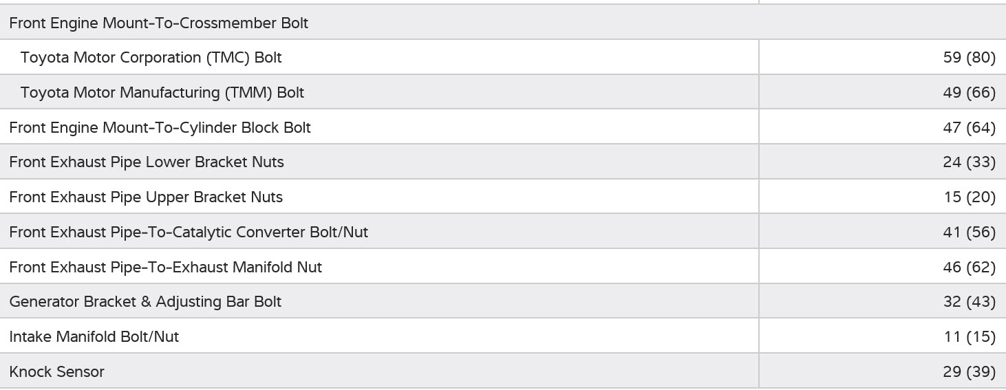

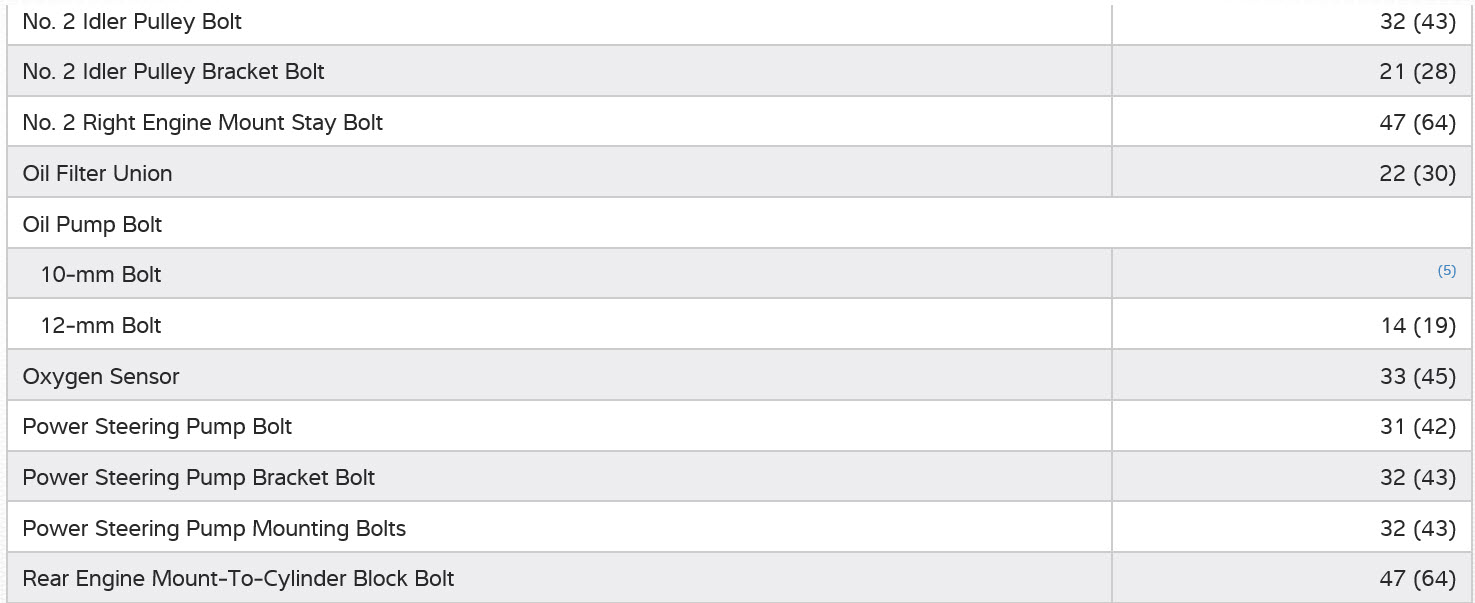

I have to rebuild a 3.0 L 1MZ-FE V6 in a 1st gen 99 Avalon. What are the torque specs for this motor?
Apr 9, 2016 at 2:24 PM
HMAC300
  • 48,601 POSTS
see pics two emails
Apr 10, 2016 at 2:01 AM
HMAC300
  • 48,601 POSTS
see pics
Apr 10, 2016 at 2:02 AM
GOTDUNES
Thanks for the pics HMAC300! Just need to get the motor out with a friend's engine hoist and stand and I'll have it back on the road the ride on another day!
