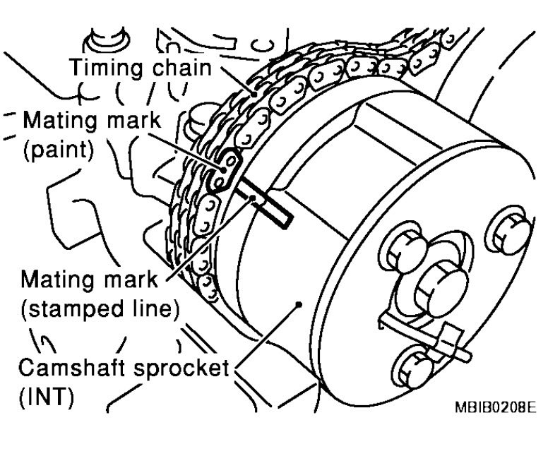

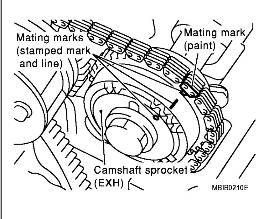

engine timing marks
80,000 MILES • 1.8L • 4 CYL • FWD • AUTOMATIC
ROBERTO VASCONCELLOS ROCHA JUNIOR
My intake camshaft sprocket is not as describe on manual.
Need to know how many links between intake and exhaust sprocket marks?
Aug 22, 2016 at 6:18 AM
HMAC300
  • 48,601 POSTS
new chains are painted marks or colored links. if you are using the old one we have no data on how many links if you did not paint it before you removed it.
