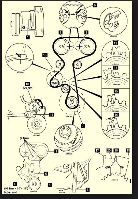

How do I go about timing the engine? because the bearings are seized they can't be rotated. How do I go about this? I am confident I can replace all the parts just the timing I am unsure how to go about that?

I found the timing belt timing marks in the diagrams below. Can you please shoot a quick video with your phone so we can see what's going on? that would be great. You can upload it here with your response. Check out the diagrams (below). Please let us know what happens.
