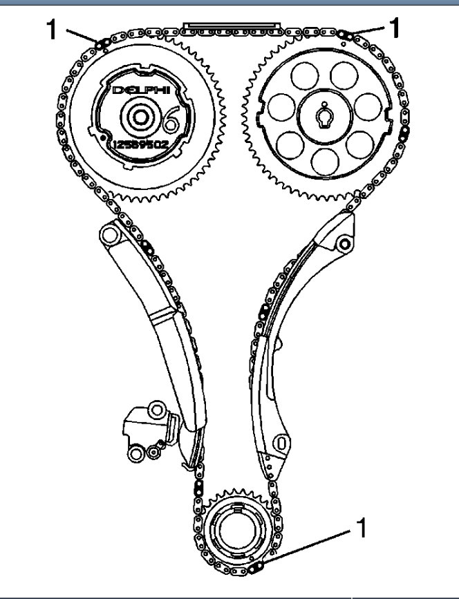

Hey, I was just wondering how I find top dead center on this motor 4.2 6L. I put a rag in the first cylinder cranked motor by hand no pop or do I just keep cranking it? I'm so confused, I haven't touched or pulled the timing gears off or chain. I see they had there is a punch and l mark but just confused wanted to pull chain out and gears. How do I know if I'm at top dead center without knowing I'm on compression stroke?
