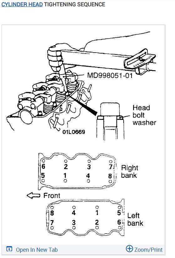

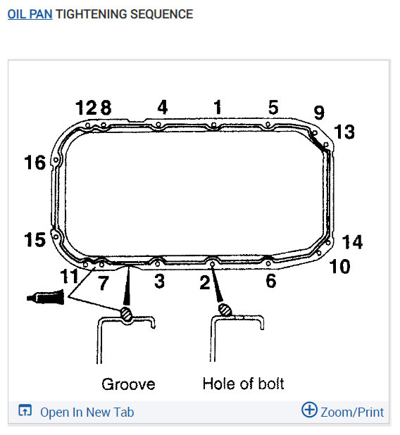

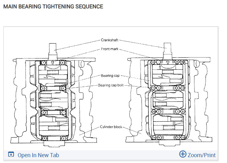

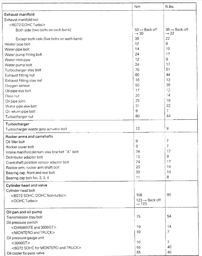

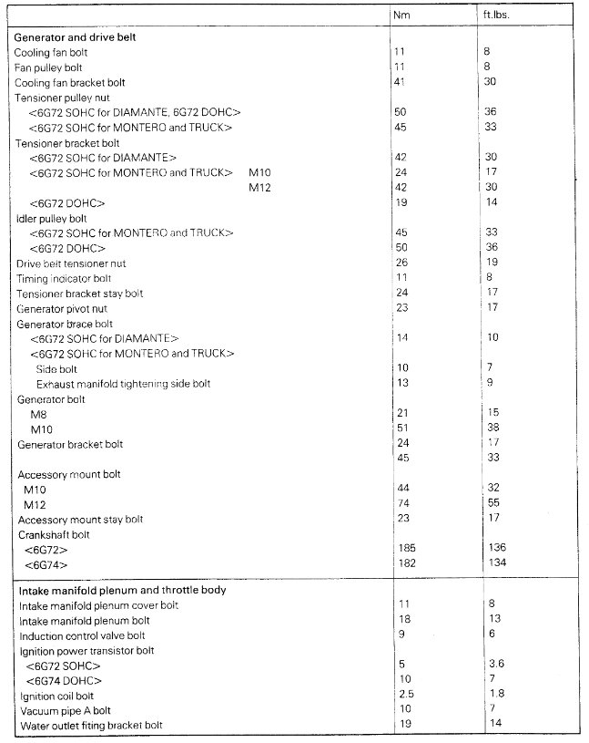

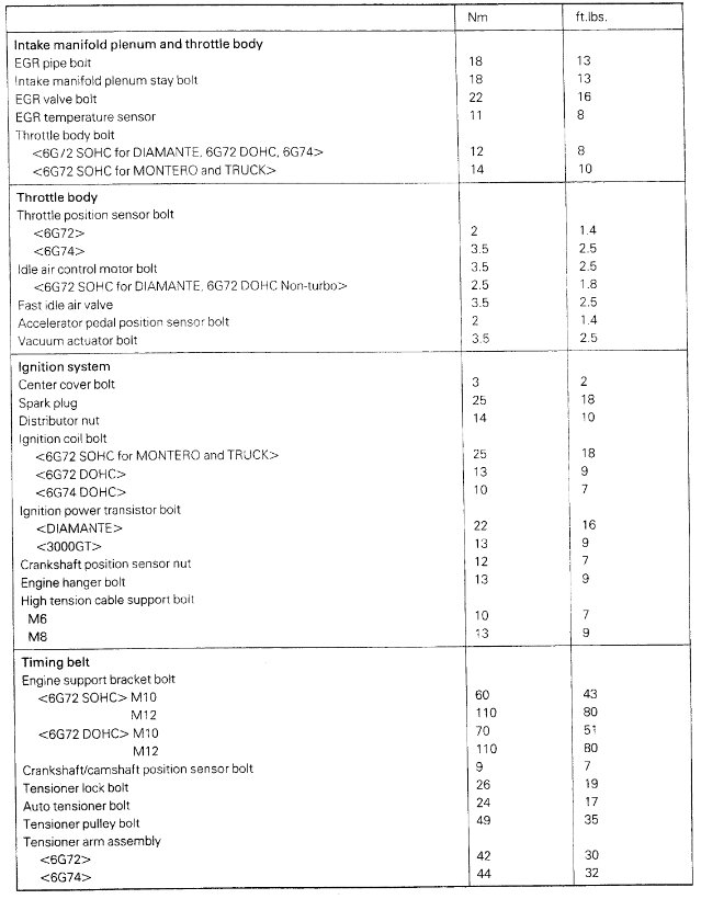

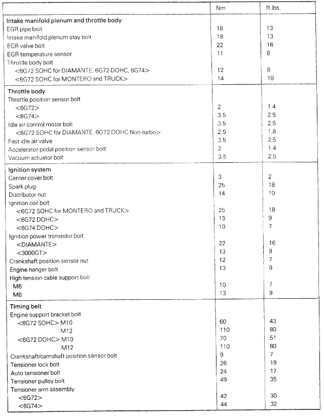

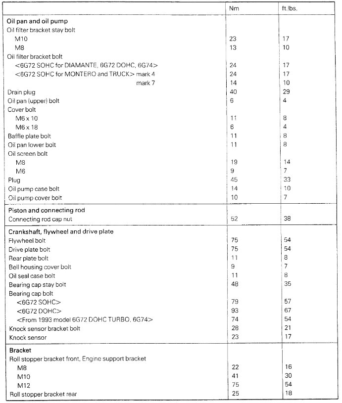

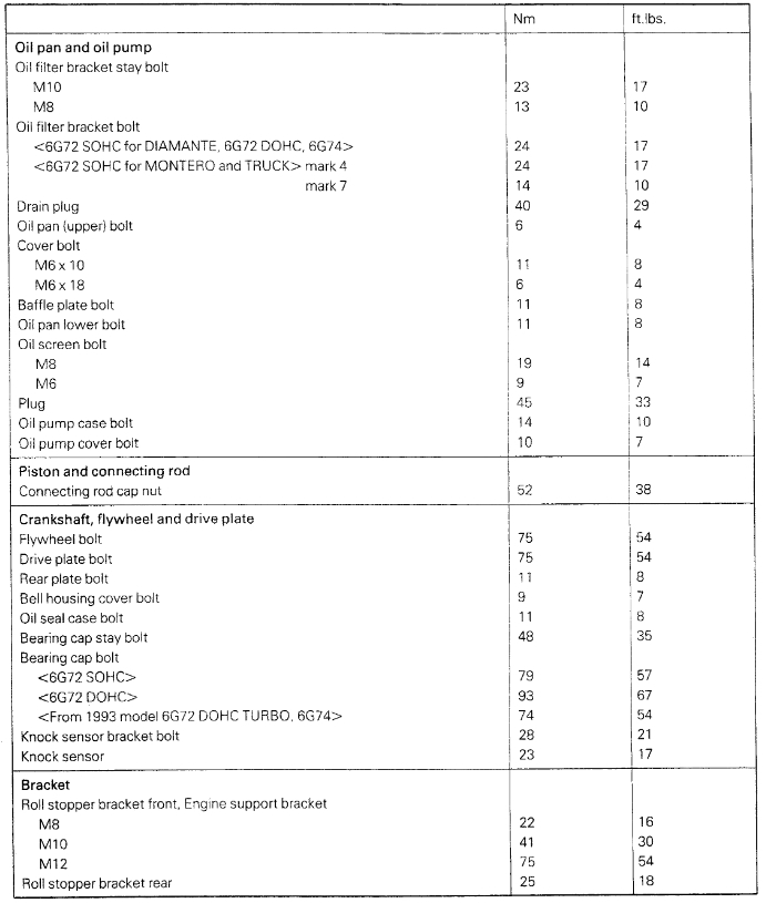

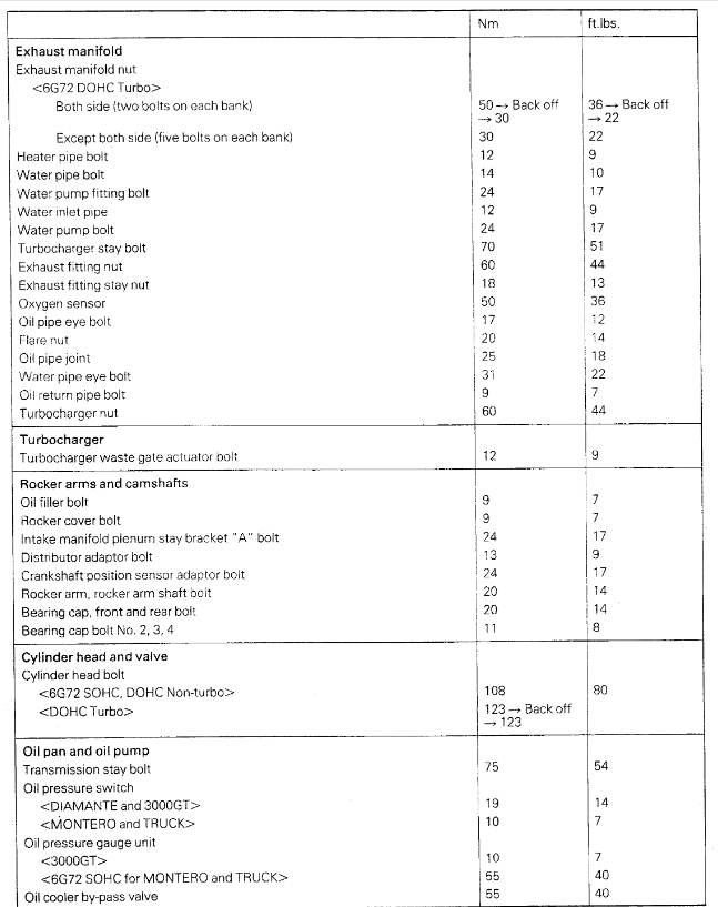

What is the engine tightening torque specifications for the vehicle listed above mini Pajero 4A30 engine?
Dec 24, 2023 at 7:56 AM
Experienced Mechanic
55,721 POSTS
Sure, here are the complete engine tightening torque specs and the sequence. Check out the images (below). Let us know if you need anything else.
