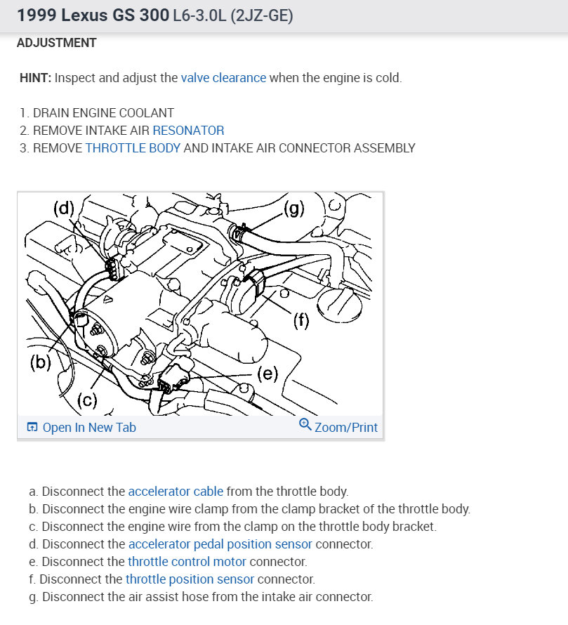

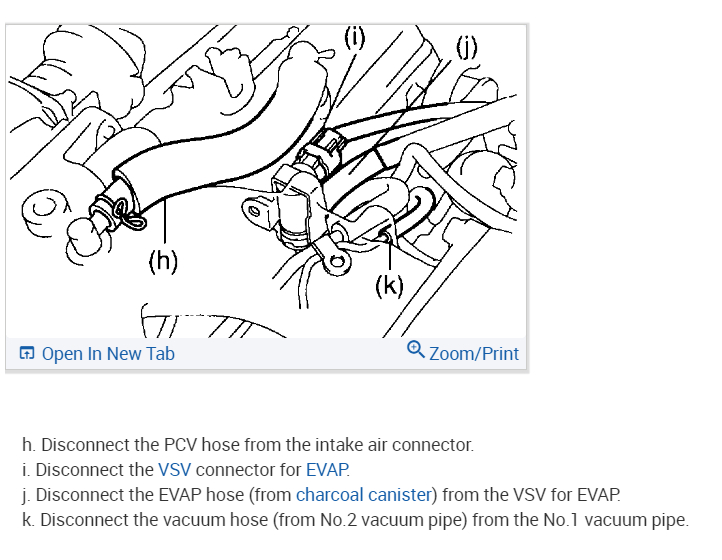

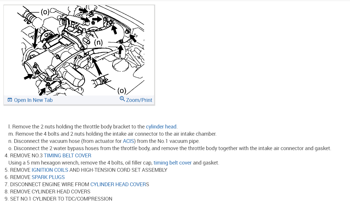

When I turn on the car the ticking starts right away and continues while idling, when i press down on the throttle the speed of the ticking noise increases with the throttle I give. I really don’t know what it could be. I replaced the oil and filter, I’m new to cars so any info helps.

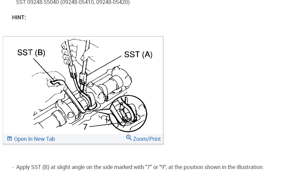

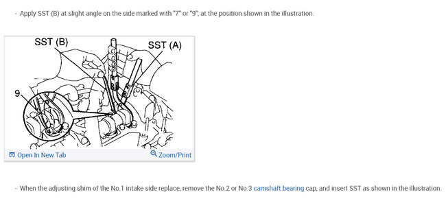

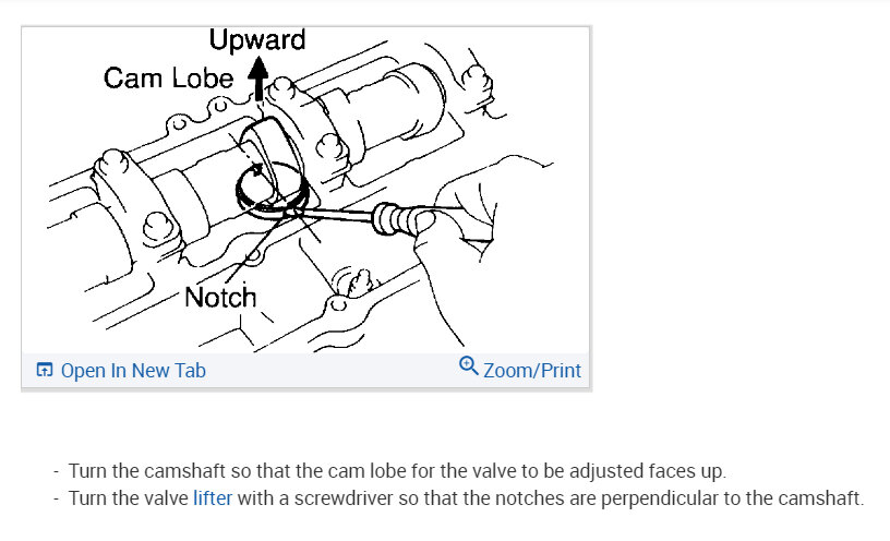

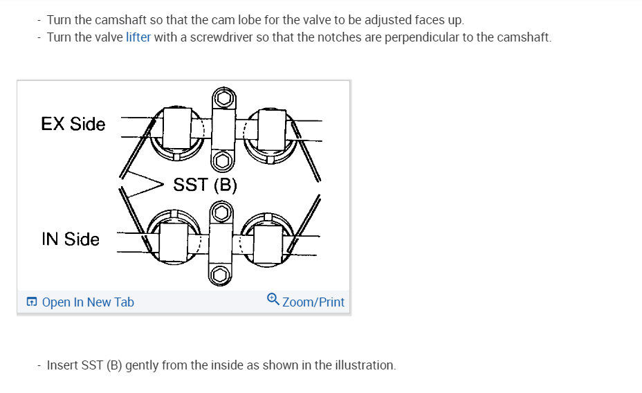

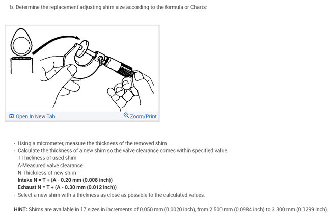

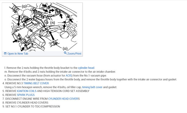

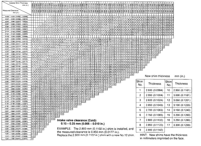

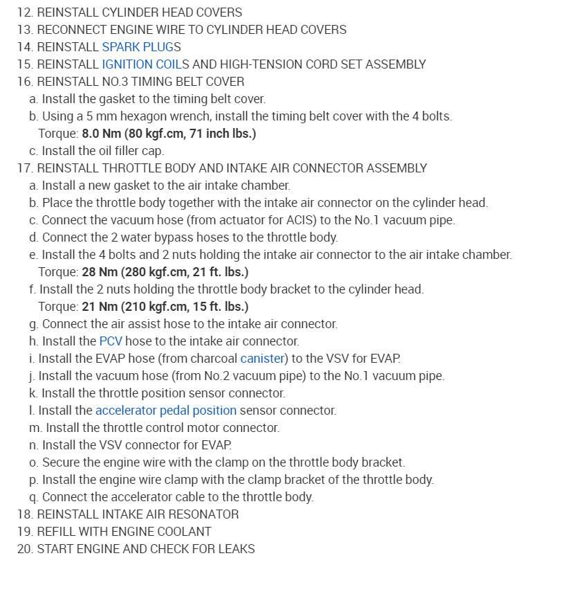

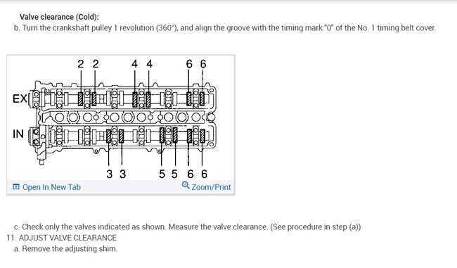

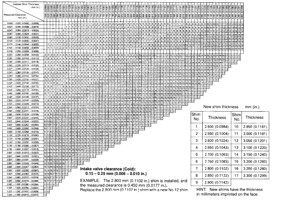

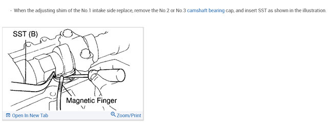

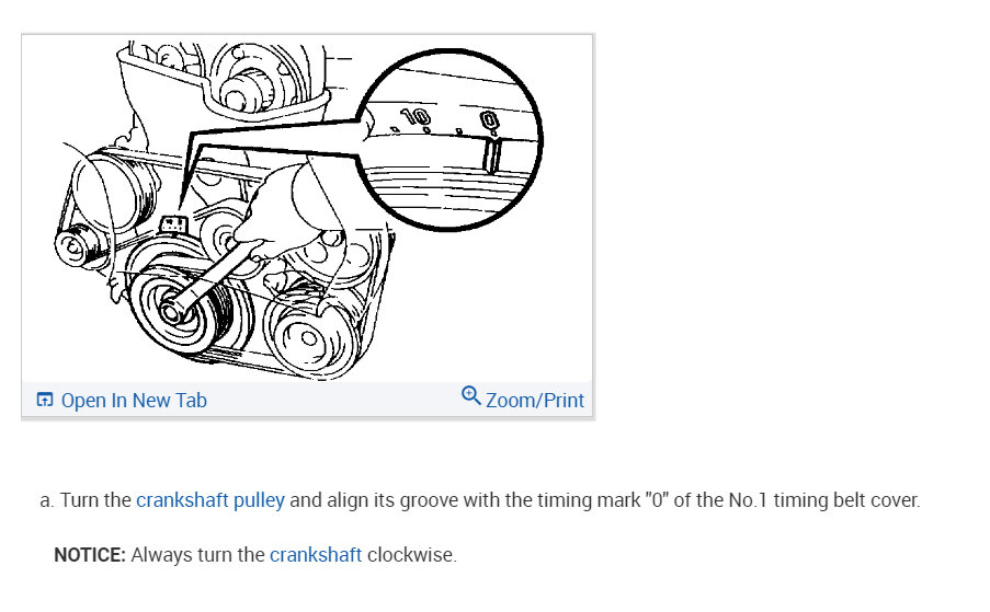

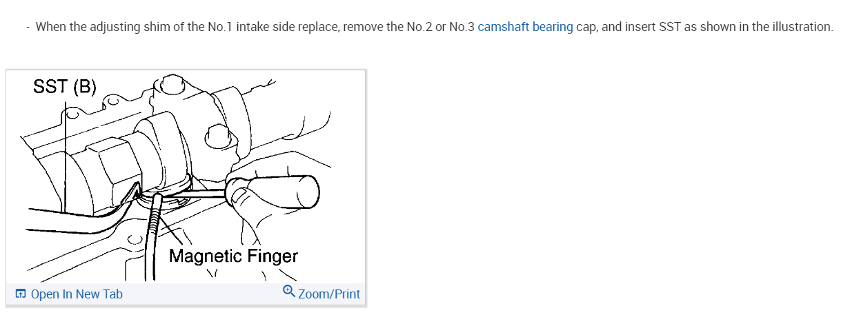

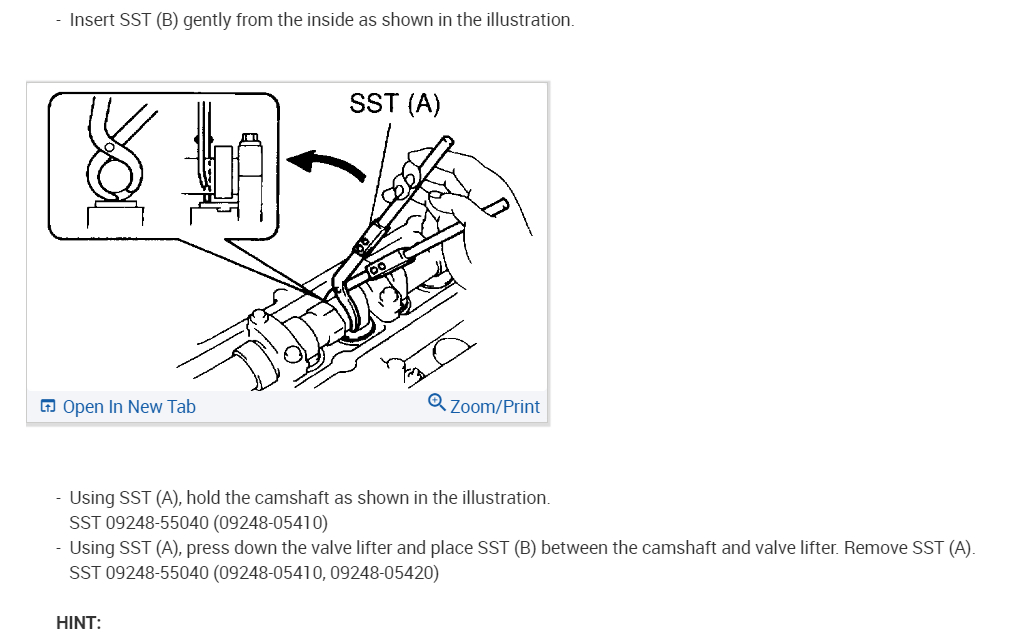

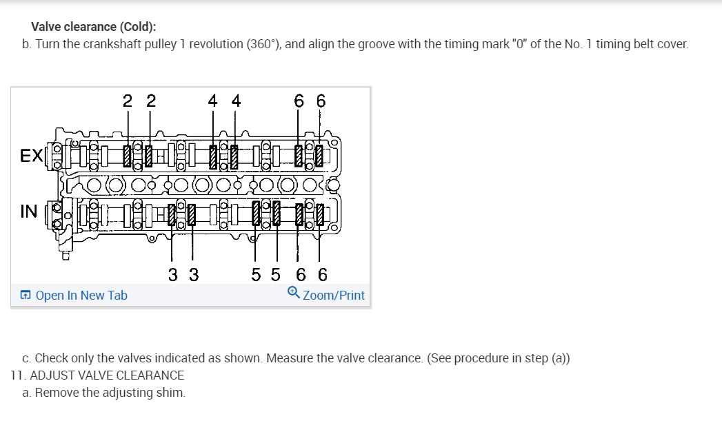

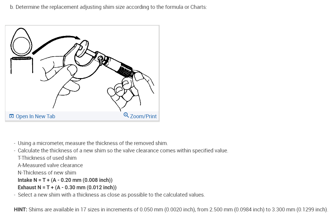

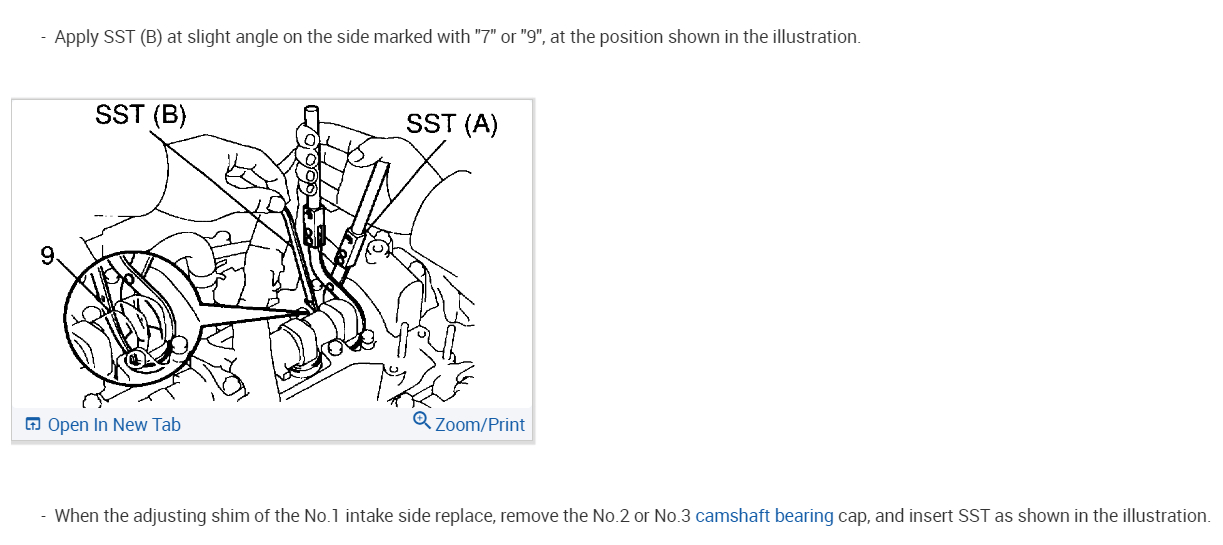

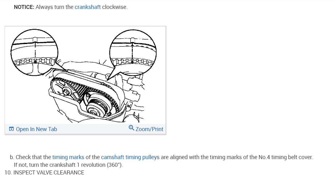

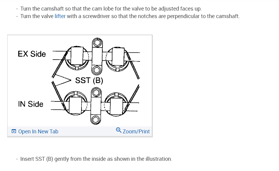

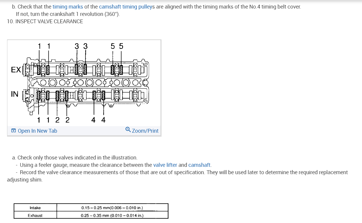

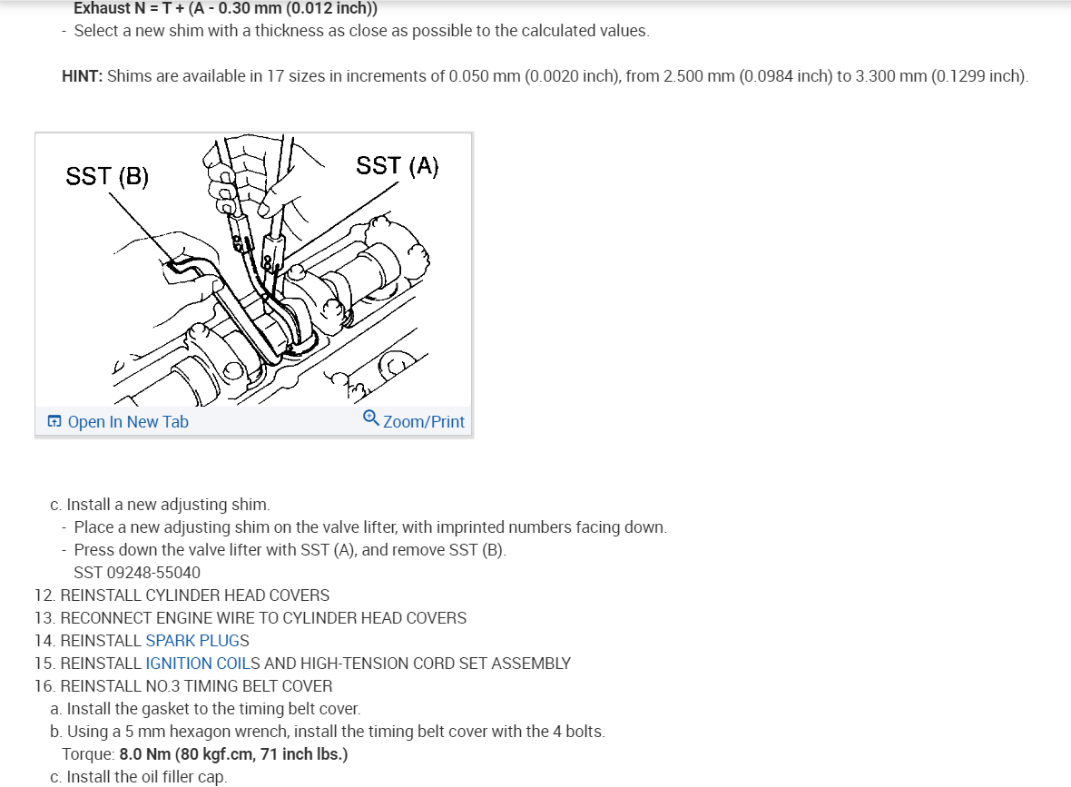

Thanks for the video. That is definitely lifter/valve train noise. This could be wear on the camshaft or you have to adjust the valves. Let's remove the valve cover for inspection. Here are instructions on how the job is done in the images below. Can I ask what weight oil you used when you did the oil change? Check out the images (below). Please let us know how it goes

Okay, then it is back to the valve adjustment procedure, when the valve cover is off, please check out the lobe wear on the camshafts as well. You can upload an image if you have any questions about wear.
