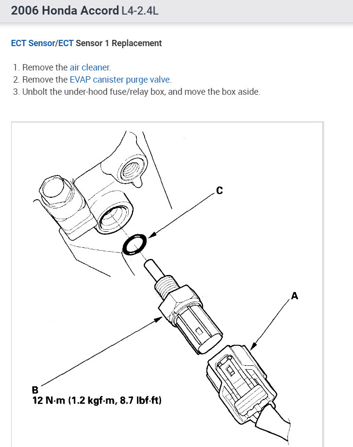

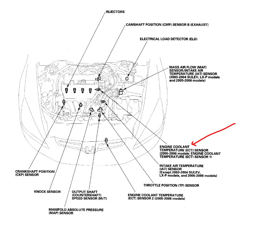

My temperature gauge is all the way up beyond the "H" mark even when the vehicle has been sitting overnight it jumps there immediately.
I would like to ask which sensor/switch would be potentially responsible for inaccurate temp readings so that I may replace the parts for new.
A diagram would be greatly appreciated. Thanks in advance!
Jun 9, 2023 at 5:15 PM
  • 55,456 POSTS
sure, this car has two engine coolant temperature sensors one is in the bottom of the radiator which is for the cooling fan operation and the other is near the valve cover here is the location of the sensor and how to replace it in the images below. Please let us know if you need anything else to get the problem fixed.
