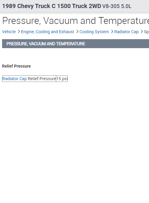

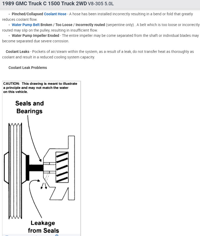

I have a 1989 GMC Sierra with 5.7l rebuilt. I might have a overheating issue, the temperate raises to about 230 when I start it up and drive , then it drops to 190, at first I thought the gauge wasn't reading correctly but I came to a conclusion it could be the radioator cap I have a 18 pound cap right now. Should I put a lower psi cap?
Jan 26, 2016 at 6:31 AM
SQM
  • 6,383 POSTS

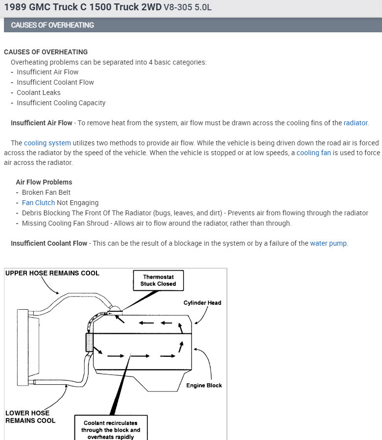

The recommended radiator cap is 15 PSI for this truck.
https://www.2carpros.com/articles/symptoms-of-an-overheating-engine

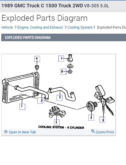

The cap could be the culprit. Keep in mind that many times when it only overheats while stationary it is due to the cooling fan not working properly. As the fan does not flow sufficient air through the radiator. But as the vehicle start to move the air flow brings down the temperature.
This could be due to a bad fan clutch.
https://www.2carpros.com/articles/fan-clutch-symptoms
