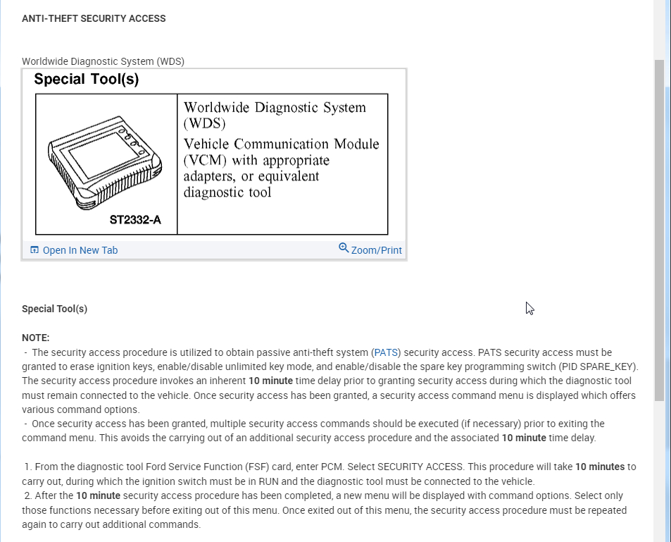

Just to be clear, your theft light is blinking once every 5 seconds and when you turn the key to the start/on position it doesn't do anything?
Try putting the key in the ignition and leave it sit in the on position for 30 minutes or the light turns off.
It sounds like you have an active theft system so we need to try and deactivate it.
If this does not work we are most likely going to need to have the OEM or compatible scan tool go through the process to deactivate it. I attached this process.
When you unplug that connector the vehicle thinks someone is trying to steal the vehicle so we need to tell the vehicle that it is not and it will reset.

i left it in 30 minutes and nothing bud. and i put obd scanner in and saying failed to connect.
Oct 2, 2020 at 6:41 AM
TERRY L MENESES
  • 33 POSTS
Thanks. got lucky and was a fuse 28 PCM ! it works now.
Oct 2, 2020 at 11:28 AM
Haha. That was exactly where we were going next with the scanner not communicating. Great catch and I am glad you figured it out. Thanks for the information and please come back net time you need some help.
