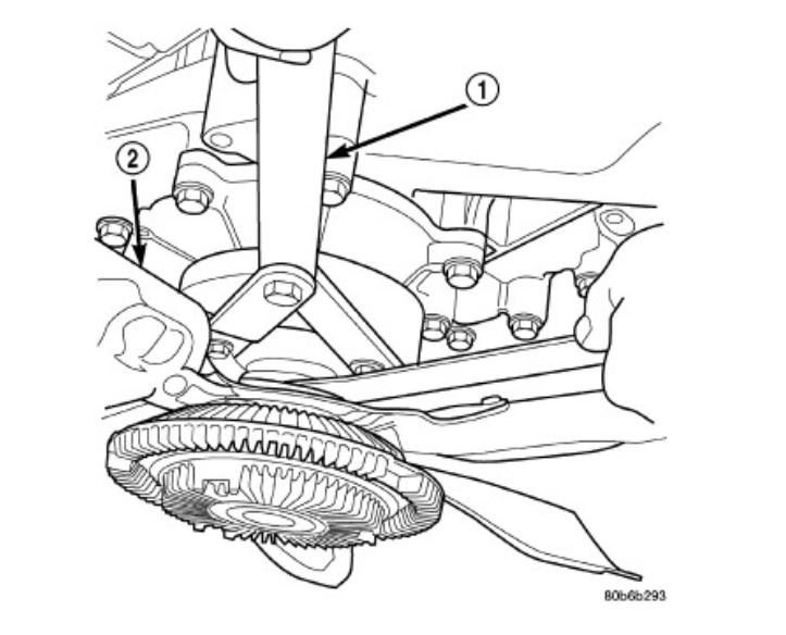

Caution: If the viscous fan drive is replaced because of mechanical damage, the cooling fan blades should also be inspected. Inspect for fatigue cracks, loose blades, or loose rivets that could have resulted from excessive vibration. Replace fan blade assembly if any of these conditions are found. Also inspect water pump bearing and shaft assembly for any related damage due to a viscous fan drive malfunction.
Note: Viscous Fan Drive Fluid Pump Out Requirement: After installing a new viscous fan drive, bring the engine speed up to approximately 2000 rpm and hold for approximately two minutes. This will ensure proper fluid distribution within the drive.
1. Install fan blade assembly (2) to the viscous fan drive. Tighten the bolts to 24 Nm (18 ft. lbs.) torque.
2. Position the fan shroud, electric cooling fan and the fan blade/viscous fan drive assembly (2) to the vehicle as a complete unit. See: Radiator Cooling Fan > Removal and Replacement > Electric Radiator Fan - Installation
3. Install the fan shroud.
4. The thermal viscous fan drive/fan blade assembly is attached (threaded) to the water pump hub shaft. Install the fan blade/viscous fan drive assembly to the water pump by turning the mounting nut counterclockwise as viewed from the front. Threads on the viscous fan drive are LEFT-HAND. A 36 MM Fan Wrench (1) should be used to prevent pulley from rotating.Tighten mounting nut to 50 Nm (37 ft. lbs.).
5. Connect the negative battery cable.

I have additional information. Yesterday I took a closer look at my truck and discovered the low fan shroud was not re-installed correct a few weeks ago after a water pump installation. My guess is the fan is pull air around and not through the radiator. My fan will currently turn close to a 1/4 turn with the engine off by hand, so I am assuming the clutch is holding and the issue is more related to the damage cause to the shroud by my local garage. Do you think the missing lower shroud would cause the stop and go heating issue?
Aug 28, 2018 at 5:53 AM
Yes, the shroud has to be intact. Fix that first.

So, I took the truck back to the shop and they installed a new lower shroud. They informed me my fan clutch was in fact bad. I am not big on co-incidents, but they believe my clutch went out a week after they changed the pump. My concern is at some point the fan was jammed up against the lower shroud and could not turn. Could this potentially damage the clutch since the input shaft was turning but the fan itself could not turn due to being jammed by the damaged lower shroud?
They are willing to replace the clutch, but I believe in being honest and would not expect a shop to loss money on a job if it is just normal wear. I had them inspect the fan and there was no sign of damage so it appears the shroud got caught on start up and the fan only turned a rotation of two.
Aug 29, 2018 at 1:13 AM
Yes, I agree. I bet the lower shroud trapped the fan and failed the clutch.
