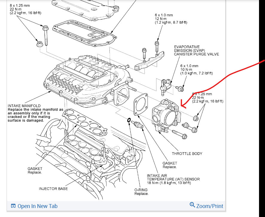

Typically, when I go to crank my van, it will turn over for 1-2 seconds before firing up. But Past 2 days I've noticed that when my van is cold (not ran in many hours) and I go to crank it, the engine turns over for 3-5 seconds before it fires up. If I shut it off and crank it again, it fires right up in like 1-2 seconds like before.
I suspect this is an issue with fuel not getting to the injectors fast enough after it's been sitting a while and everything "drains out". Would this be a bad/clogged fuel filter, or a failing fuel pump? What else could cause this particular issue?

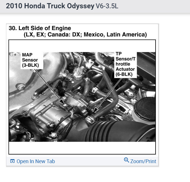

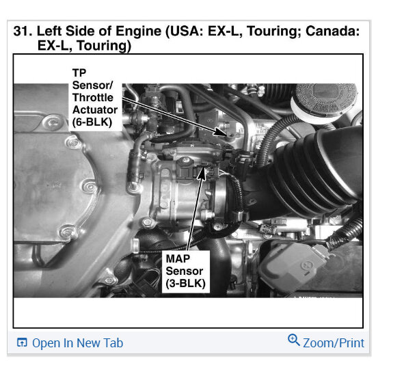

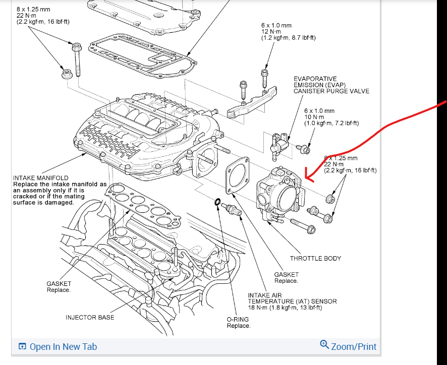

Yes, it could be the fuel pump but before we suspect that let's do a throttle bore service and check for vacuum leaks. Please follow this guide to do the service which I have included instruction below for your car and follow the vacuum leak guide when the engine is cold only:
and
This hard starting guide can help you understand the problem as well:
https://www.2carpros.com/articles/engine-cranks-excessively-before-starting
Check out the images (below). Let us know what happens and please upload pictures or videos of the problem.

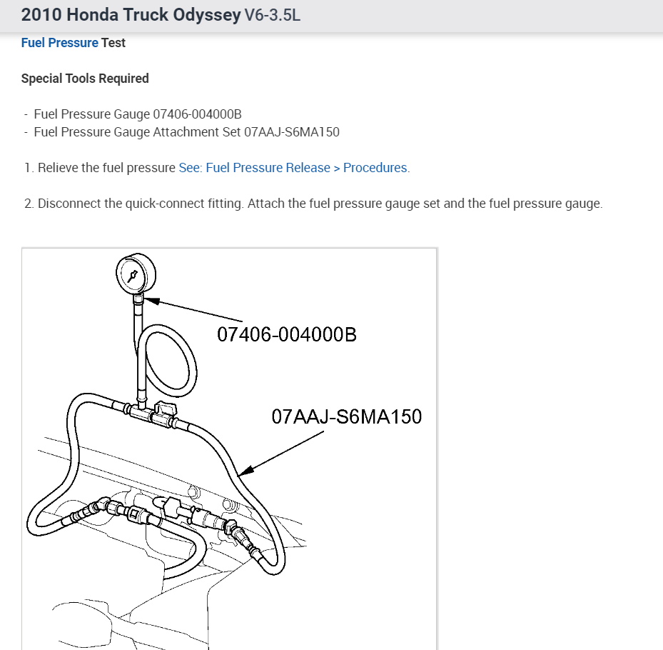

Thanks, I have access to a fuel pressure gauge, and I believe the throttle body was just cleaned around 50,000 miles ago I'll have to check the records.

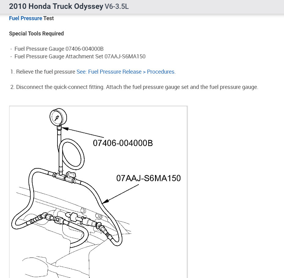

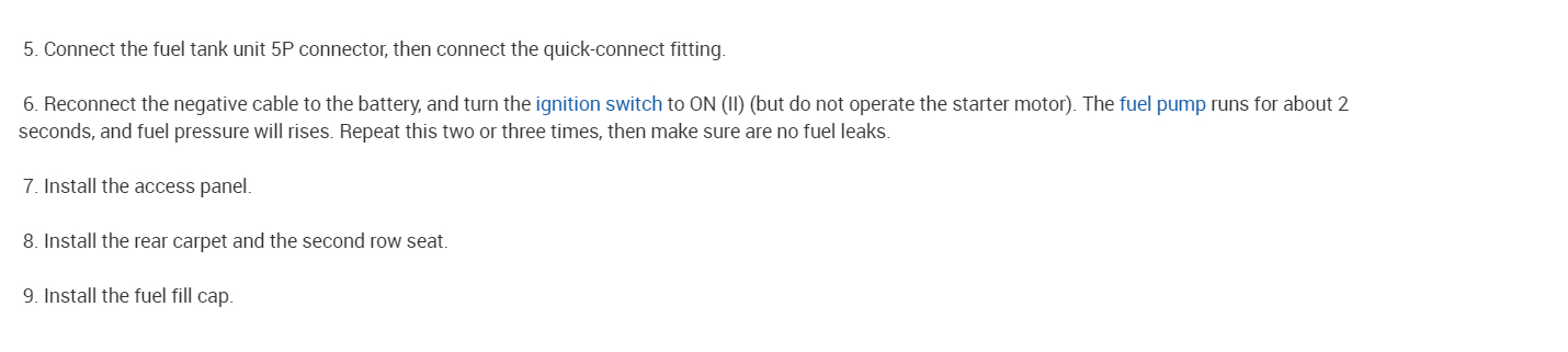

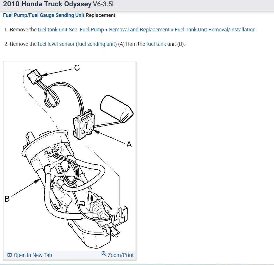

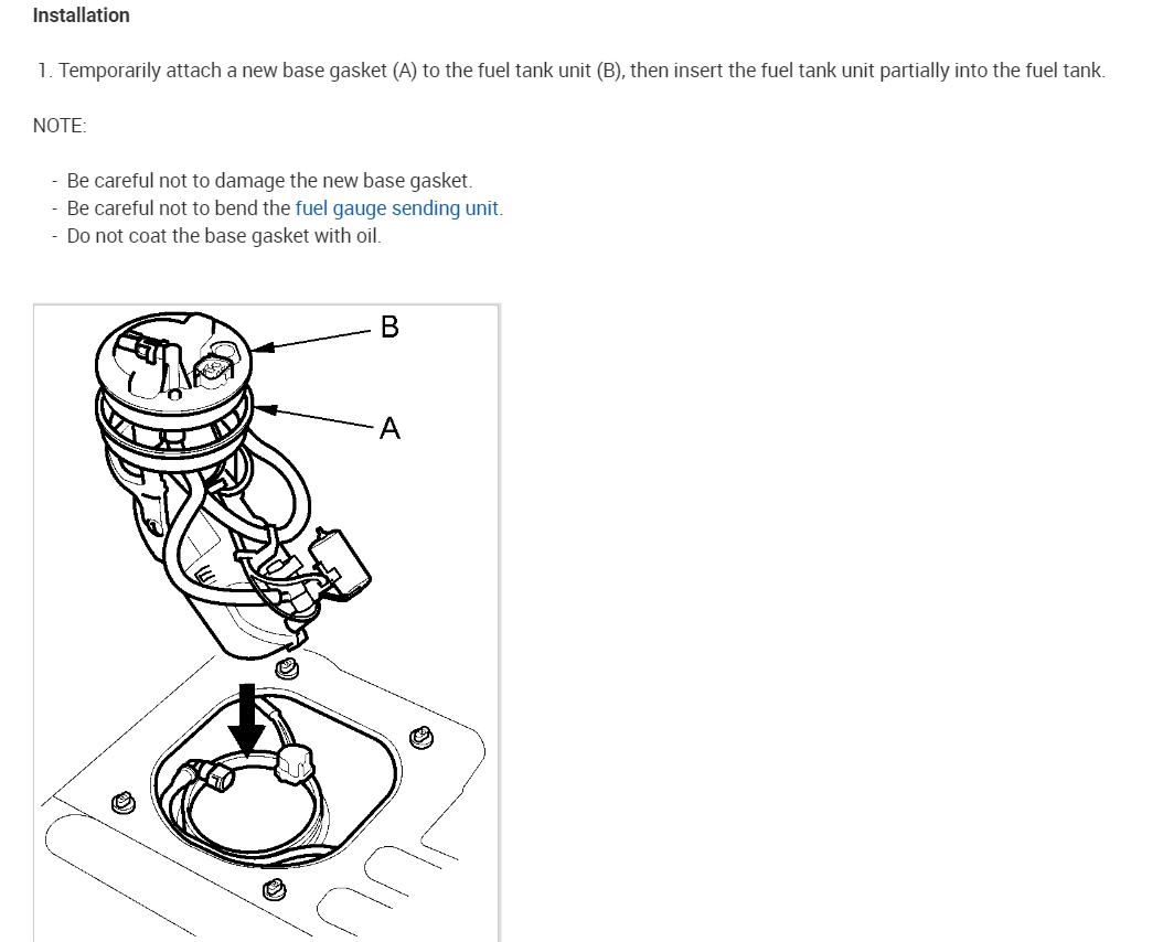

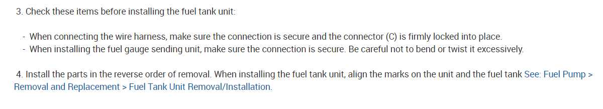

Sounds good. here is how to test the fuel pressure and I have included how to change out the fuel pump just in case you need it:
Fuel Pressure Test
Special Tools Required
- Fuel Pressure Gauge 07406-004000B
- Fuel Pressure Gauge Attachment Set 07AAJ-S6MA150
1. Relieve the fuel pressure See: Fuel Pressure Release > Procedures.
2. Disconnect the quick-connect fitting. Attach the fuel pressure gauge set and the fuel pressure gauge.
3. Start the engine, and let it idle.
- If the engine starts, go to step 5.
- If the engine does not start, go to step 4.
4. Check to see if the fuel pump is running: Listen to the fuel filler port with the fuel fill cap removed. The fuel pump should run for 2 seconds when the ignition switch is first turned to ON (II).
- If the pump runs, go to step 5.
- If the pump does not run, do the fuel pump circuit troubleshooting See: Fuel Pump > Component Tests and General Diagnostics > Fuel Pump Circuit Troubleshooting.
5. Read the fuel pressure gauge. The pressure should be 380-430 kPa (3.9-4.4 kgf/cm2, 55-63 psi).
- If the pressure is okay, the test is complete.
- If the pressure is out of specification, replace the fuel pressure regulator See: Fuel Pressure Regulator > Removal and Replacement and the fuel filter See: Fuel Filter > Removal and Replacement, then recheck the fuel pressure.

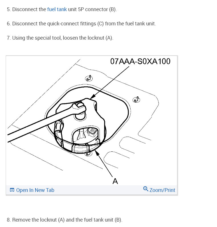

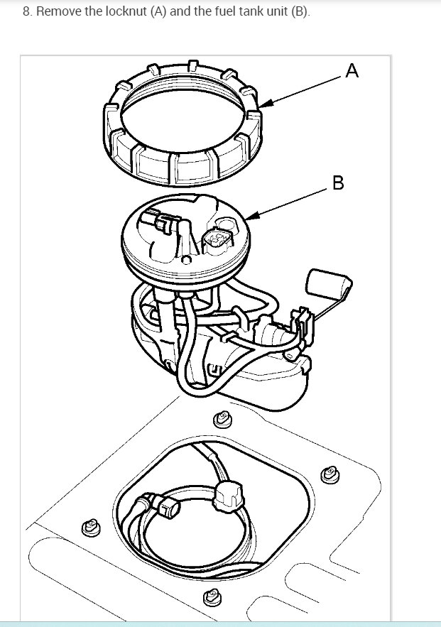

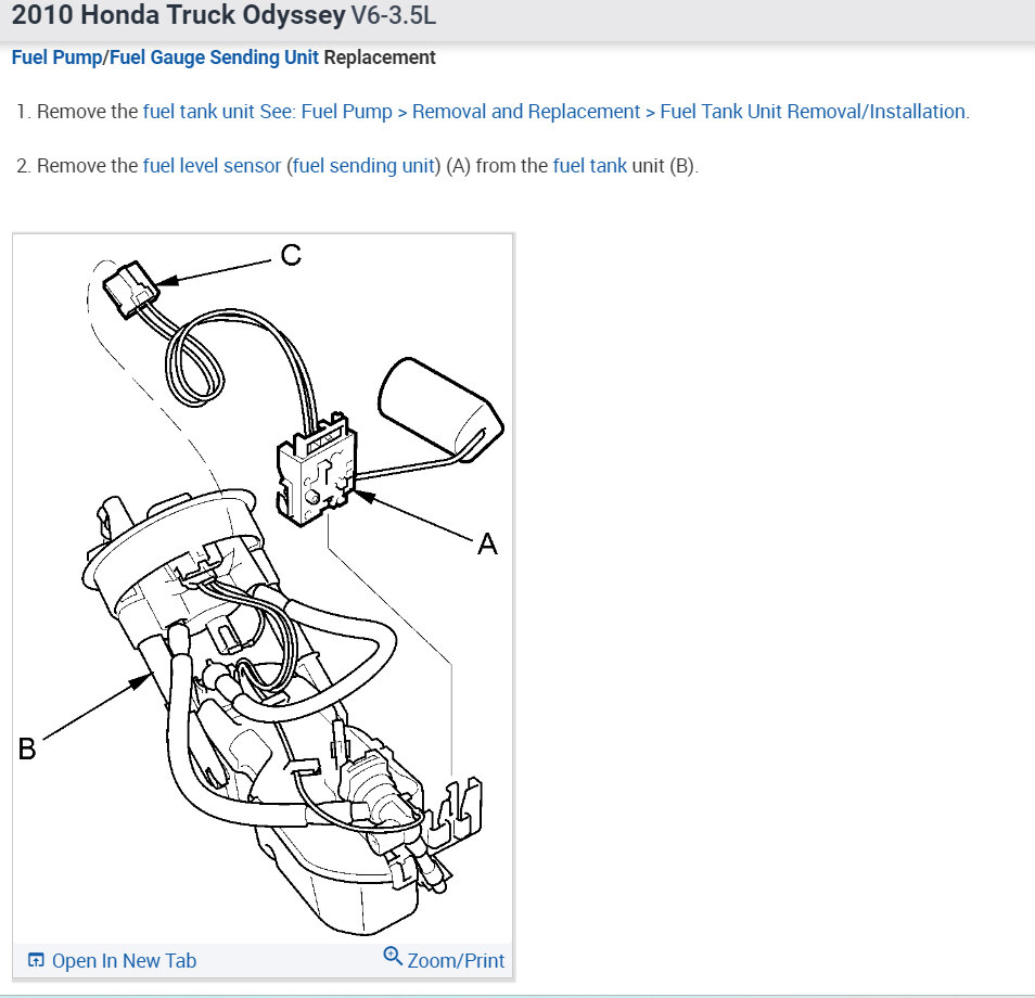

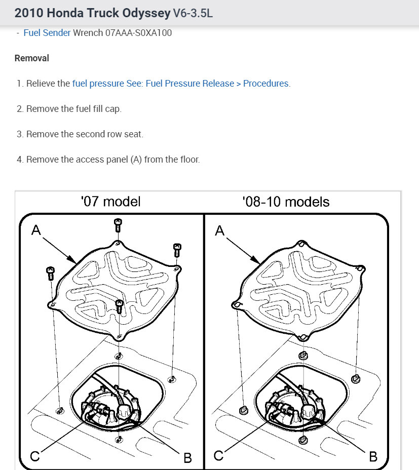

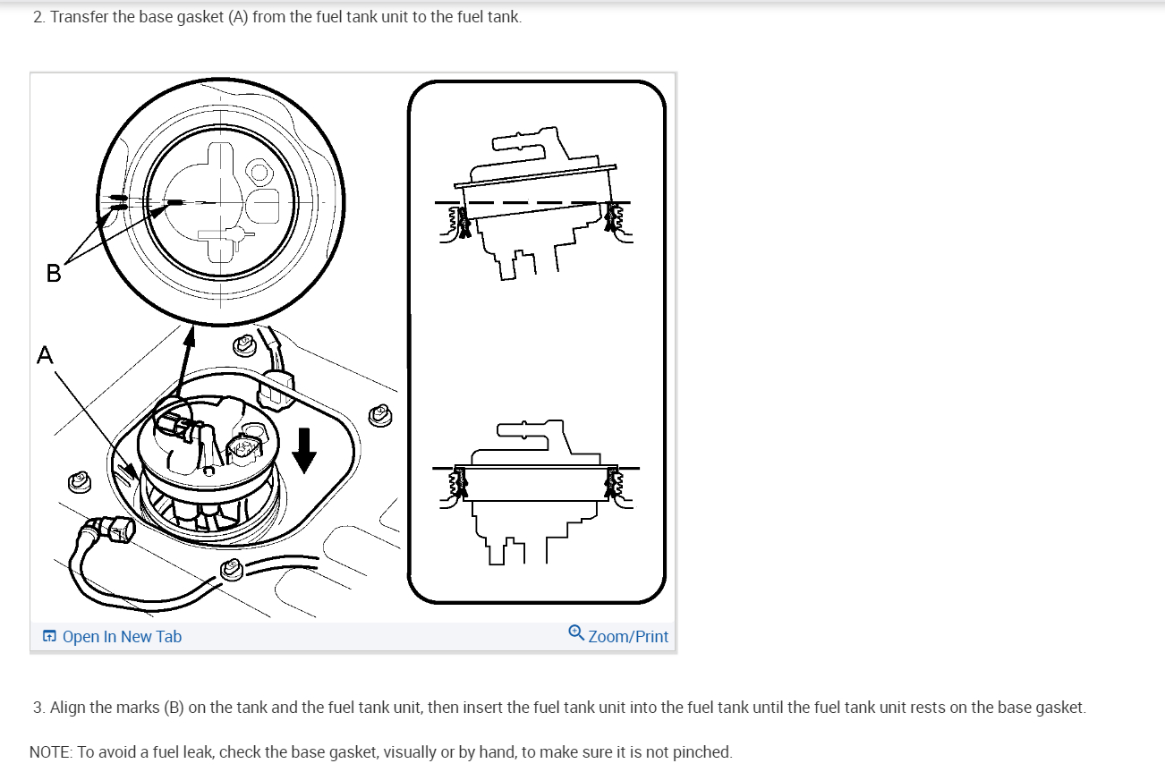

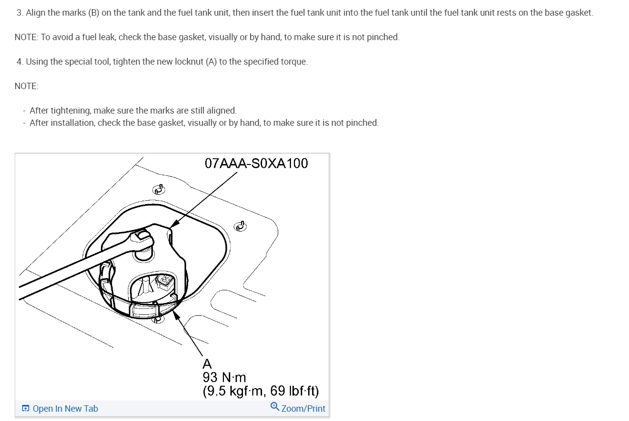

Here is how to change out the fuel pump as well. Please let me know how it goes. Check out the images below.

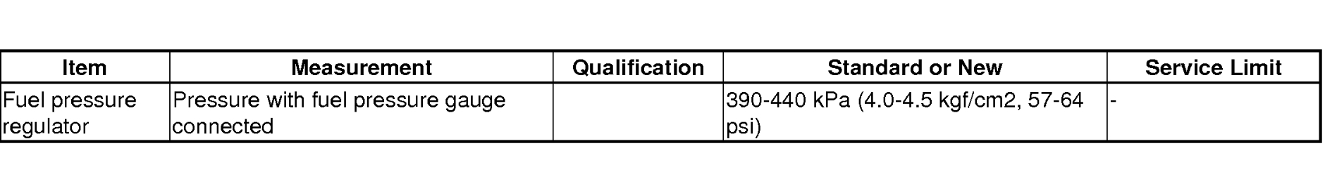

Yes, the pump runs one to prime when the key is turned on, and then it runs continuously when the engine is running. It sounds like the pump check valve is stuck open which causes it to lose it prime. You can confirm the issues if you do a fuel pump pressure test, here is a guide to help:
You can rent a gauge from the local auto parts store. Check out the images (below). Please let us know what you find. We are interested to see what it is.
