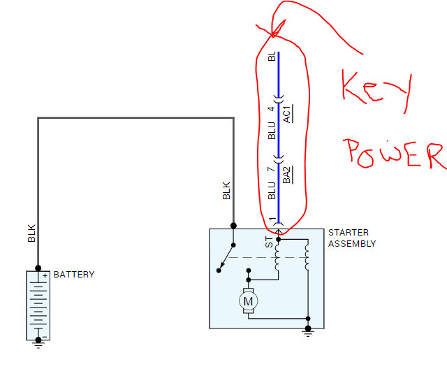

Does the starter engage when trying to start the vehicle? I attached the starter circuit wiring schematic below. I'm not sure if it is working so I thought I would add it.

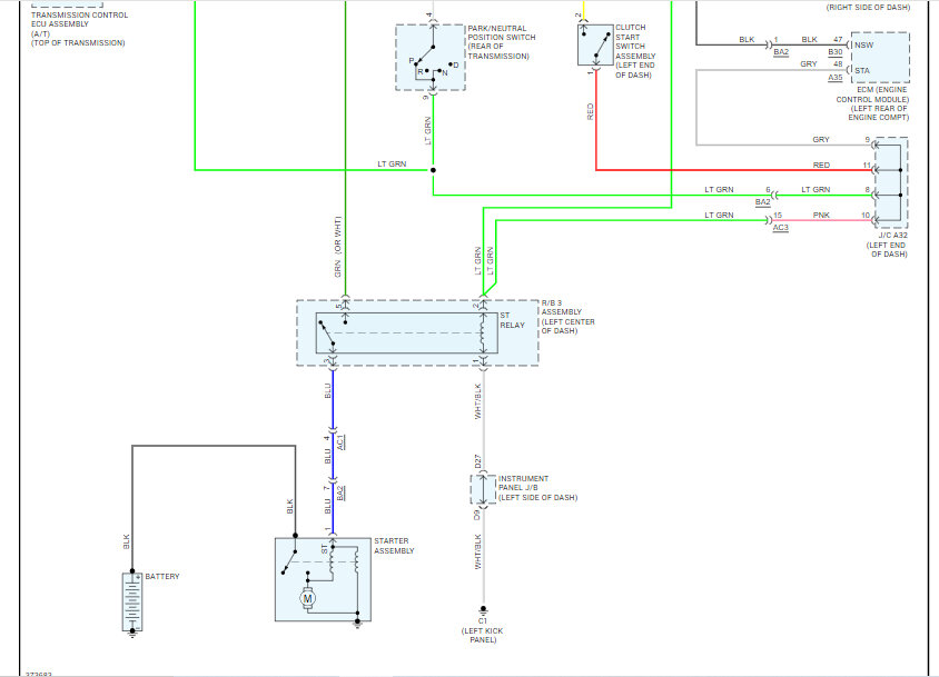

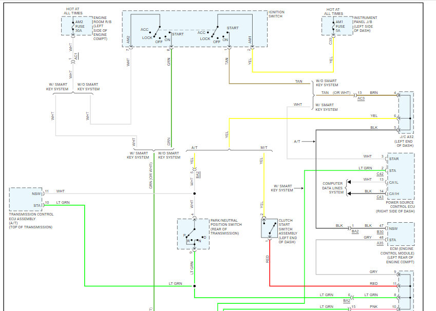

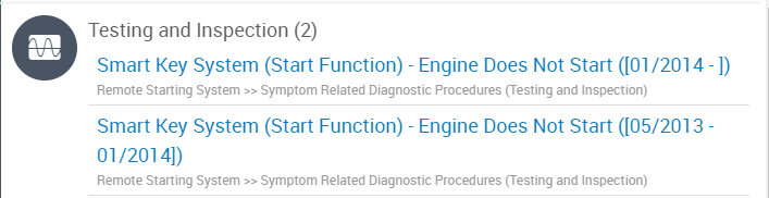

Also, are you able to connect with a scan tool to the PCM and does the vehicle have a smart key system? If you look at pic 3, you'll understand why I ask.

Okay, if the scan tool does turn on, are there any codes? Also, since the starter won't engage, that tells me you have power at the larger gauge black wire but the smaller gauge wire, blue, doesn't have power.
When the key is in any position other than start, the blue wire will not have power. When you turn the key to the start position, it should have 12v. Can you check that for me and let me know if that is what is happening? If it is, the starter is an issue. Regardless of the CEL, the starter motor should turn the engine.
See pic below. Note that the starter motor has a hot wire (black) directly from the battery. The blue wire is the trigger wire that engages the starter. It comes from the starter relay.

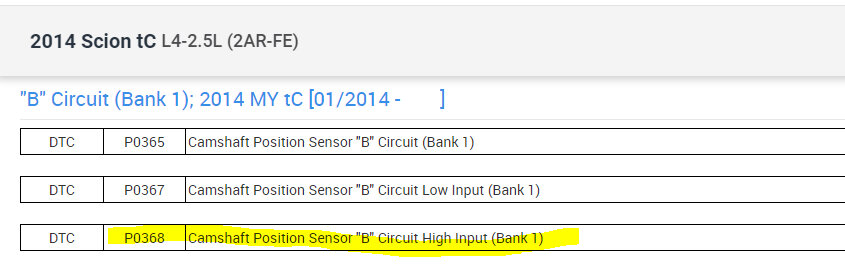

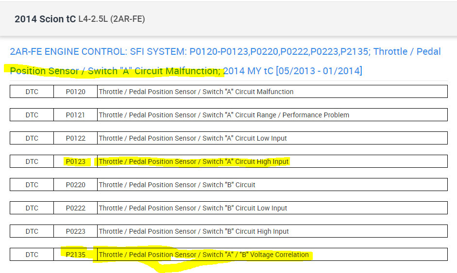

The codes you have (P0123 and P2135) are related to the throttle position sensors. See pic 1. The P0368 is related to an exhaust camshaft position sensor (high input). That is usually an indication to a short to power. So, there could be a connector issue, or something is shirting and sending 12v to the sensor.

Tell me more about the smart key. Is it possible to have unplugged the ECM for as long as I did a whole week actually, we can have that if it was a smart key, it wouldn't work anymore? The thing to get to me is the key does unlock and lock the doors by pushing the buttons so if it is a smart key I can't see it doing that and not communicating with ECM.
Sep 30, 2024 at 1:35 PM
JAY VEYLUPEK
  • 11 POSTS
Well, I do have a smart key. There is a security light on my dash just over by the clock and it flashes we're in the car is locked I get in the car it goes out, so the ECM is recognizing the smart key it's not that. I was able to call and talk to a Toyota technician and he said it's something to do with my wiring harness I need to find the short somewhere in there there's something shorting out or not plugged in properly that is what he said without looking at it wish me luck I'm going to pull the brain harness out and go through the whole thing.
