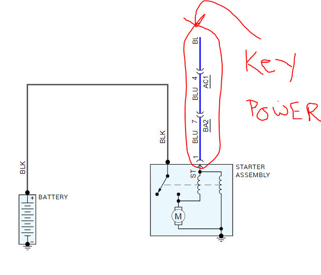

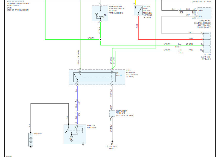

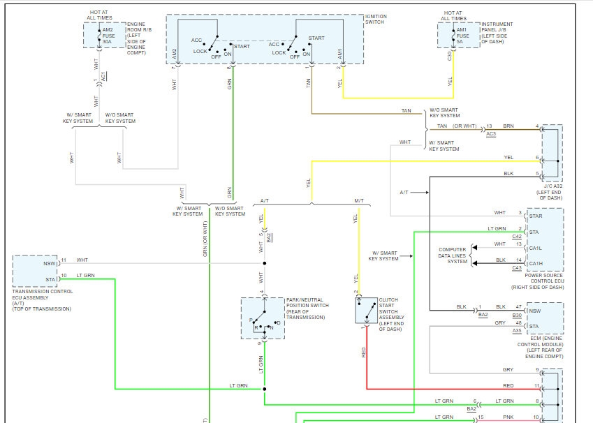

Does the starter engage when trying to start the vehicle? I attached the starter circuit wiring schematic below. I'm not sure if it is working so I thought I would add it.

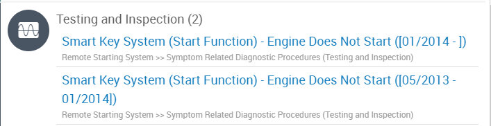

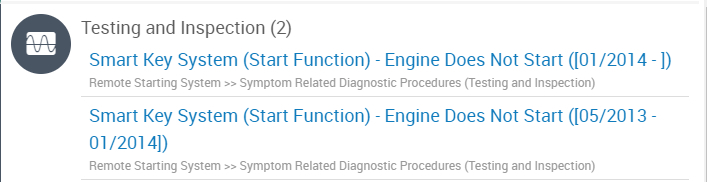

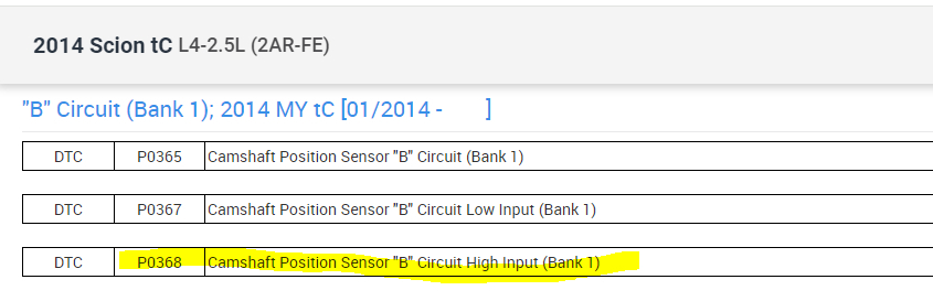

Also, are you able to connect with a scan tool to the PCM and does the vehicle have a smart key system? If you look at pic 3, you'll understand why I ask.

Okay, if the scan tool does turn on, are there any codes? Also, since the starter won't engage, that tells me you have power at the larger gauge black wire but the smaller gauge wire, blue, doesn't have power.
When the key is in any position other than start, the blue wire will not have power. When you turn the key to the start position, it should have 12v. Can you check that for me and let me know if that is what is happening? If it is, the starter is an issue. Regardless of the CEL, the starter motor should turn the engine.
See pic below. Note that the starter motor has a hot wire (black) directly from the battery. The blue wire is the trigger wire that engages the starter. It comes from the starter relay.

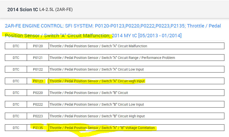

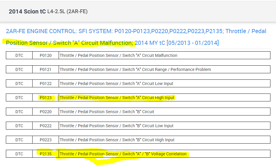

There are three codes p0123 p2135 and p0368.
First two are throttle body position sensor and the third one is circuit wiring short something like that now when I have the key turned on to the on position and throttle body plugged in I have noticed that there is a sound coming from my ECM when I unplug the throttle body with the key in the on position and the sound goes away as well as the third code p0368.

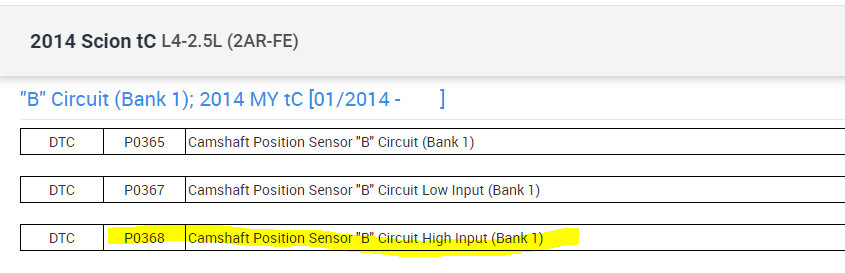

The codes you have (P0123 and P2135) are related to the throttle position sensors. See pic 1. The P0368 is related to an exhaust camshaft position sensor (high input). That is usually an indication to a short to power. So, there could be a connector issue, or something is shirting and sending 12v to the sensor.
When you installed the engine, did you use the original throttle body? Did you inspect the wiring to make sure it was the same at the connector as well as the cam sensor?

I found it. Oh my God, I found it stupid ground wire that's all it was.
Wednesday, October 2nd, 2024 AT 12:36 PM
JAY VEYLUPEK
  • 11 POSTS
I was actually going through a checklist and this is how I found it I figured you needed power you need ground you need all your wiring and I knew the wiring harness was good I knew the ignition switch was good I need the starter was good all of this stuff was working before and it's all one big circuit so I have a good power I started going through every ground and found a background wire and got one little thing it was so frustrating. I do appreciate all your help and insight. Thank you so much and if there's any time, I can help you. Let me know.
