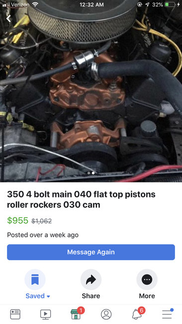

I got a guy saying the heads on the engine are 1979. Does that tell me anything about fitting in my car or do I need more information on it?
Dec 2, 2018 at 1:30 PM
DALTON SIGMON
  • 33 POSTS
It is for a 350 I am buying.
Dec 2, 2018 at 1:31 PM

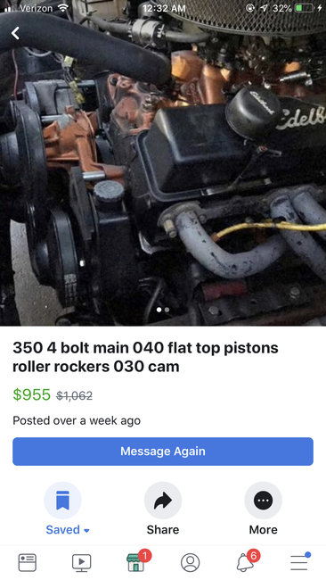

That is good. Can you snap a picture of the engine for me to view?
Dec 2, 2018 at 8:18 PM
DALTON SIGMON
  • 33 POSTS
There is two.
Dec 2, 2018 at 8:25 PM
It looks good. The fact that it is black tells me it is a GM target motor.

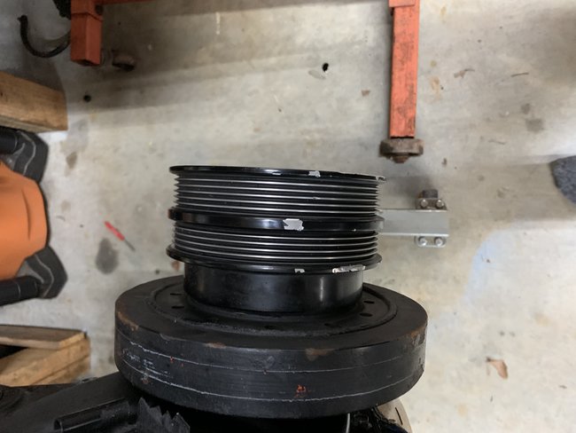

As you can see this engine has a double groove pulley, does that mean it came out of a vehicle with power steering, and if so what all do I need to put power steering on it
Jan 27, 2019 at 2:43 AM
No, not at all. You can leave it like this and just not use that part of the pulley.
Jan 27, 2019 at 2:48 AM

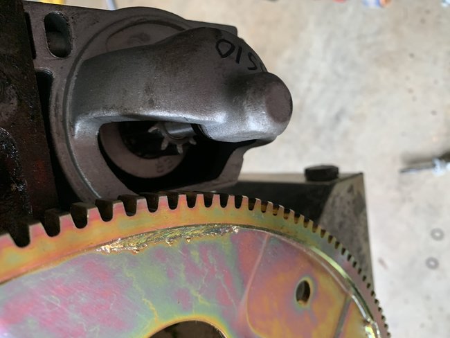

I’m pretty sure I need to buy a bigger flex plate ,but was just going to make sure if this one would work or not because I have searched everywhere and I can’t find a perfect fit.
Feb 6, 2019 at 4:38 AM
What about the old one on the old engine?
Feb 6, 2019 at 5:44 AM
DALTON SIGMON
  • 33 POSTS
Too small.
Feb 6, 2019 at 6:40 AM

I think I found one for it.
Feb 6, 2019 at 7:34 AM
Okay, If you can find out what year it came from, I might be able to help you find one.

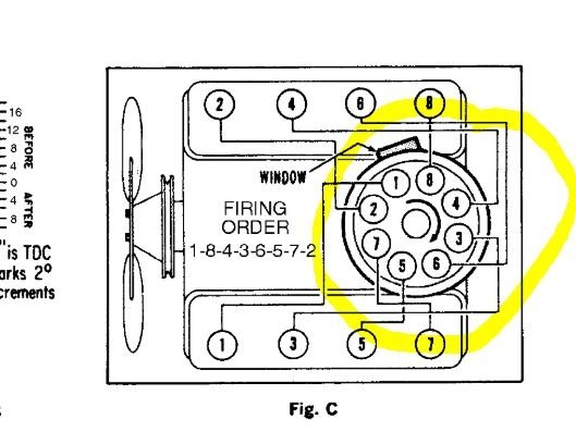

How do I set the park plugs?
Feb 9, 2019 at 5:24 AM
DALTON SIGMON
  • 33 POSTS
The wires specifically.
The plugs gt gaped at .035. Use a spark plug gapper.
Wires and the cap setting attached.

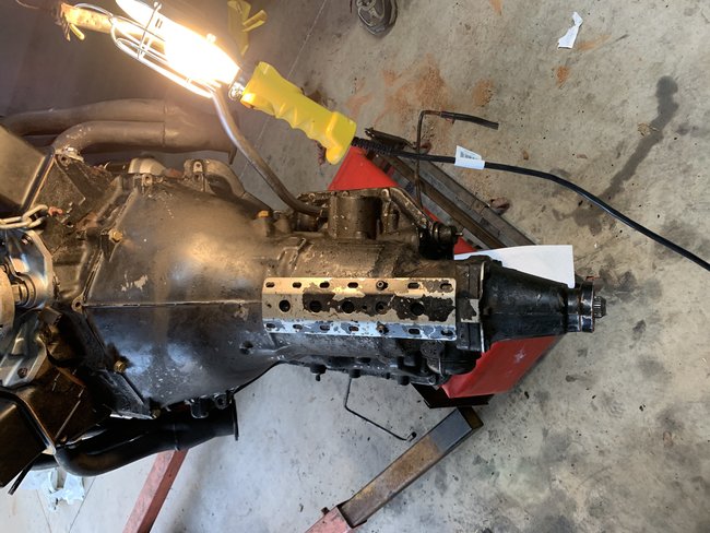

Might be a long shot but I’m putting this 350 turbo transmission on but don’t know anything about the linkages. is there anything I need to buy new? not sure what the old transmission was but I know the dipstick doesn’t fit.
Feb 9, 2019 at 6:34 AM
You had a powerglide.
You now have the turbo 350.
You need the correct dipstick for that transmission.

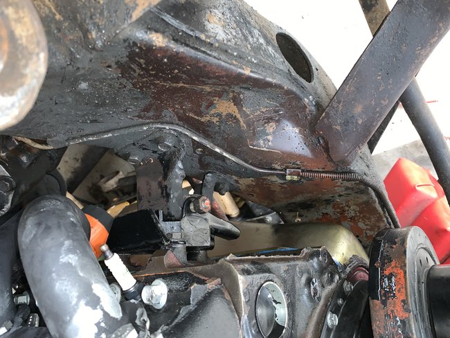

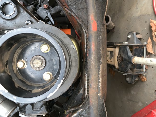

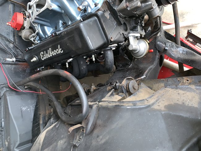

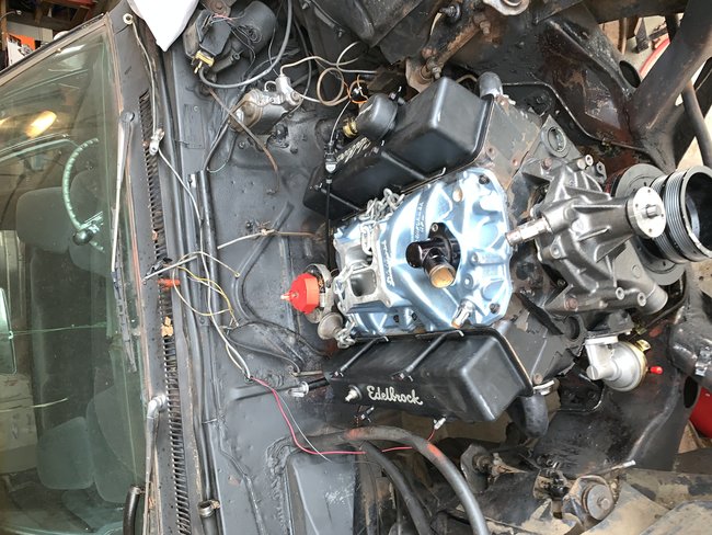

I don’t think it’s just me but it looks as if my engine is sitting too low, what should I do about this?
Feb 28, 2019 at 11:39 AM
From your pictures, it all looks good.
