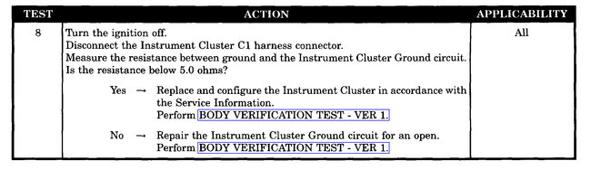

Well, I have the engine installed. The truck starts and runs but my instrument gauges, radio, and A/C are not working. The needles on the gauges move just a little when the key turns on but they are not doing anything else.
Nov 19, 2020 at 11:59 AM
  • 110,194 POSTS
If none of them are working, something is disconnected, we have a ground issue (unlikely), or a blown fuse.

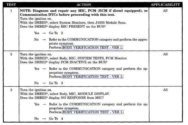

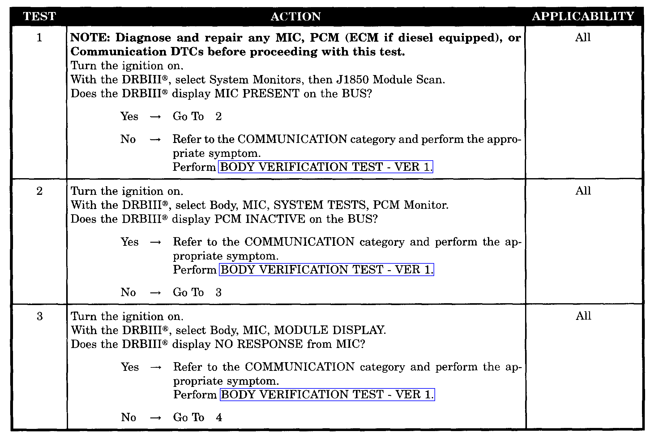

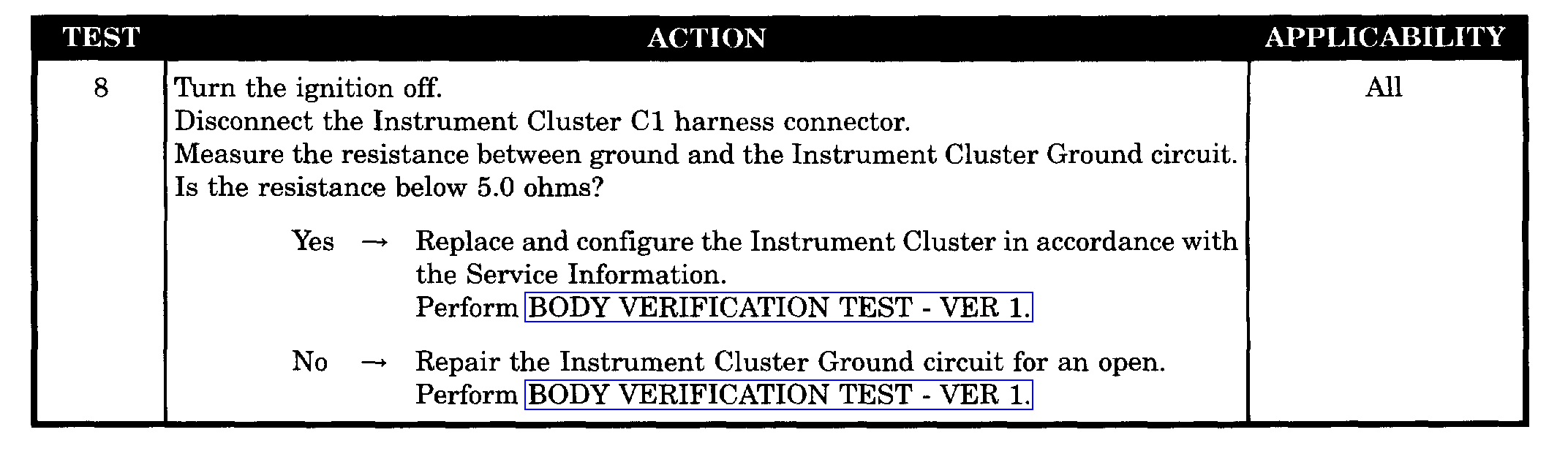

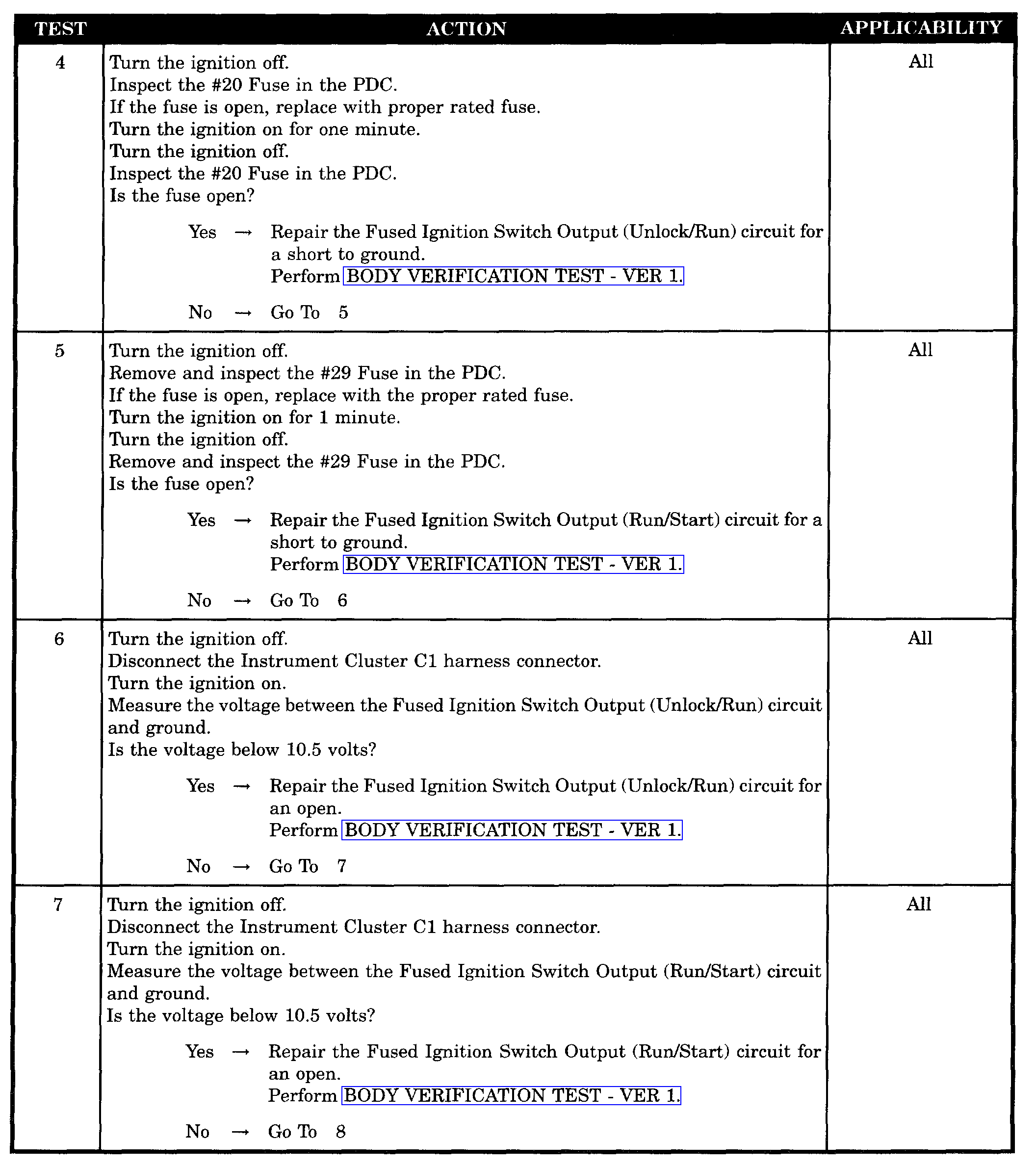

Here are the diagnostics for no gauges working. The attached pics are the actual diagnostics.
_______________________
2002 Dodge or Ram Truck RAM 1500 Truck 2WD V8-4.7L VIN N
All Gauges Inoperative
Vehicle ALL Diagnostic Trouble Codes ( DTC ) Testing and Inspection Manufacturer Code Charts Instrument Cluster All Gauges Inoperative
ALL GAUGES INOPERATIVE
Tests 1 - 3
Pic 1
Tests 4 - 7
Pic 2
Test 8
Pic 3
SYMPTOM
POSSIBLE CAUSES
- No response - PCI BUS
- PCI Bus - powertrain control module
- PCI Bus - instrument cluster
- Fused ignition switch output circuit (unlock/run) short to ground
- Instrument cluster ground circuit open
- Fused ignition switch output (run/start) circuit open
- Fused ignition switch output (run/start) circuit short to ground
- Fused ignition switch output (unlock/run) circuit open
Let me know if that helps.
Nov 19, 2020 at 6:36 PM
GARYDJENNINGS
  • 8 POSTS
I dont have a drb...
Nov 20, 2020 at 3:07 PM
  • 110,194 POSTS
That is Chrysler's scan tool with the software for their vehicles. By any chance can you get your hands on one? Also, you should be able to do it with a different tool if you have one that can actuate things and get into the different modules.

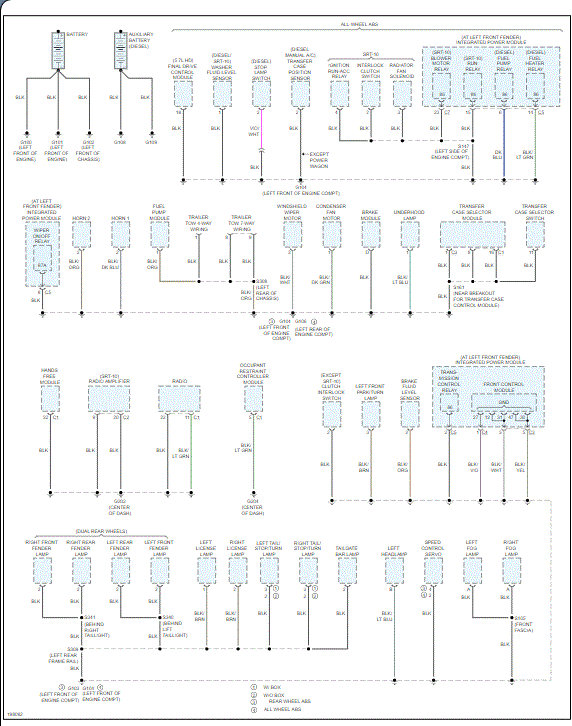

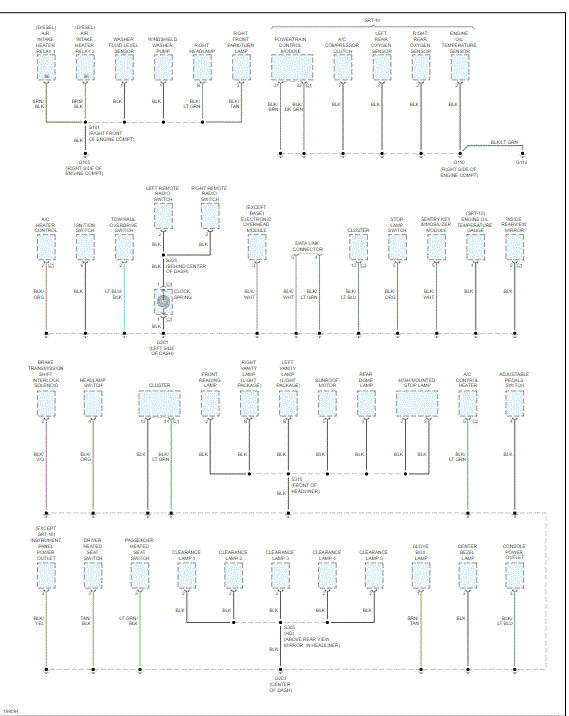

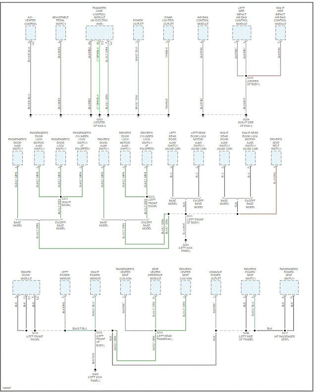

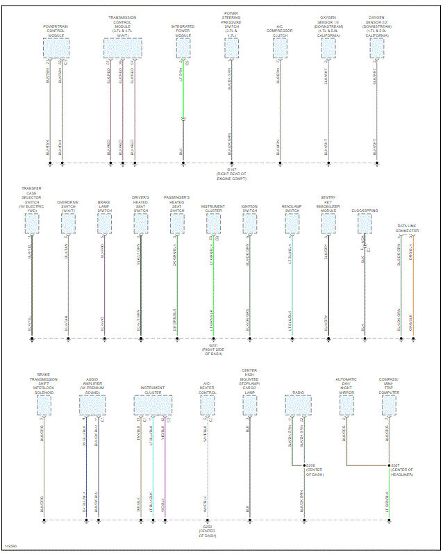

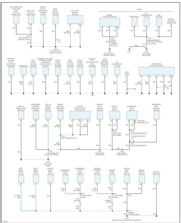

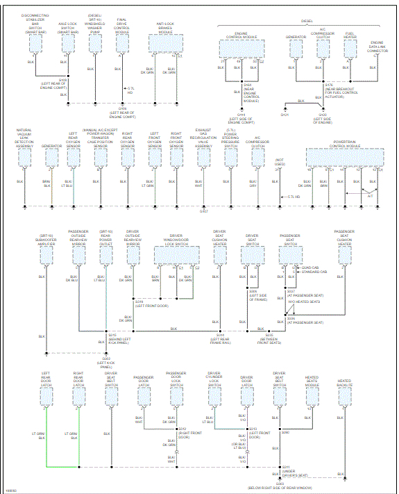

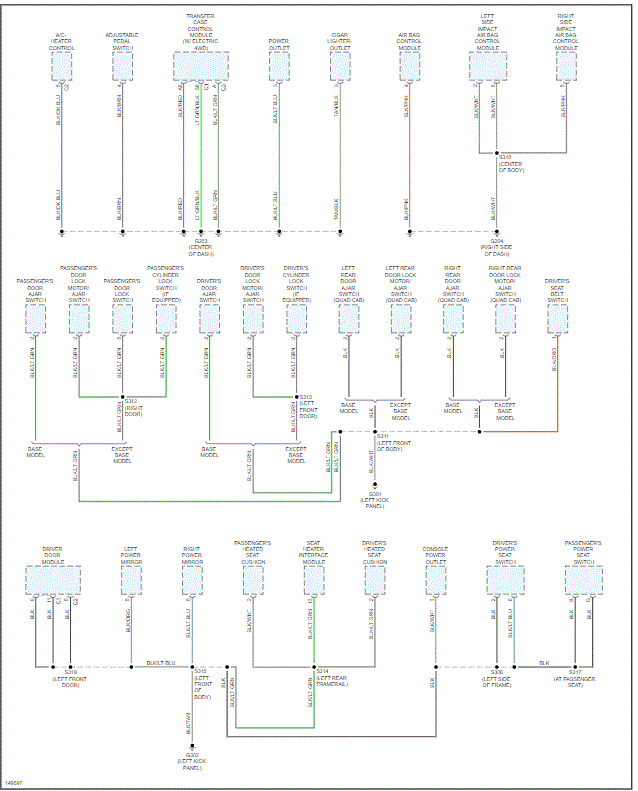

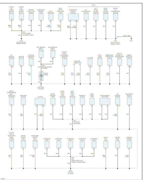

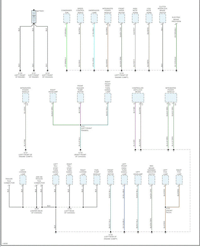

Okay, I think I found one that'll work. I've found some wiring diagrams and it seems that the 2005 has an extra ground wire that wasn't in the 2002. G203... when in look at the 2002 diagrams it isn't in there. If I can find the g203 wire under the dash and ground it. do you think that will fix my problem?
Nov 23, 2020 at 11:58 AM
GARYDJENNINGS
  • 8 POSTS
2002 diagram I looked at only has a G201. There are G202-G204, G302 and 303 also missing in the 2005.
Nov 23, 2020 at 12:03 PM
  • 110,194 POSTS
Try providing a ground and see if it helps.
The first three pics below are all the ground locations for the 02. The last three are for a 2005. See if anything there helps.
