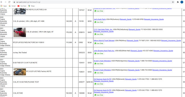

my car is FWD and i needed to know if i could swap a engine from a car or if that would not work or if there is any extra work needed or if i need to pull a engine from a FWD car.
Oct 23, 2020 at 5:03 PM
Good morning,
If you need a motor replaced, it is best to stay with the year, model and exact engine size.
Some of the exact same size motors may not work due to engine mounting for the mounts.
If you need a motor, I check with car-parts.com.
I attached a page as an example of the engines available for you to view.
I also attached a YouTube video of removing the motor.
