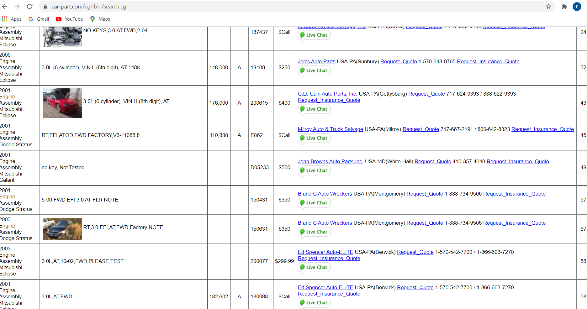

Good morning,
If you need a motor replaced, it is best to stay with the year, model and exact engine size.
Some of the exact same size motors may not work due to engine mounting for the mounts.
If you need a motor, I check with car-parts.com.
I attached a page as an example of the engines available for you to view.
I also attached a YouTube video of removing the motor.
