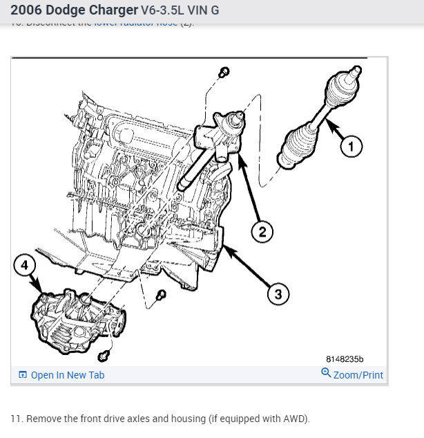

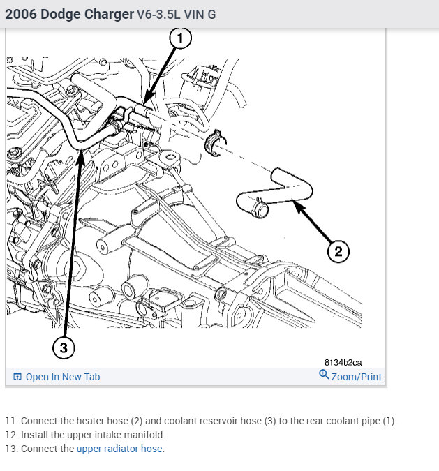

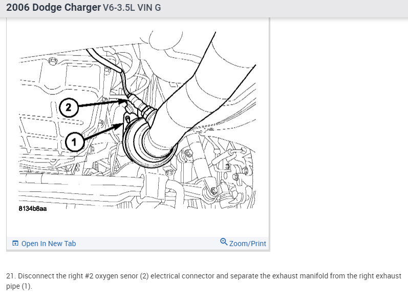

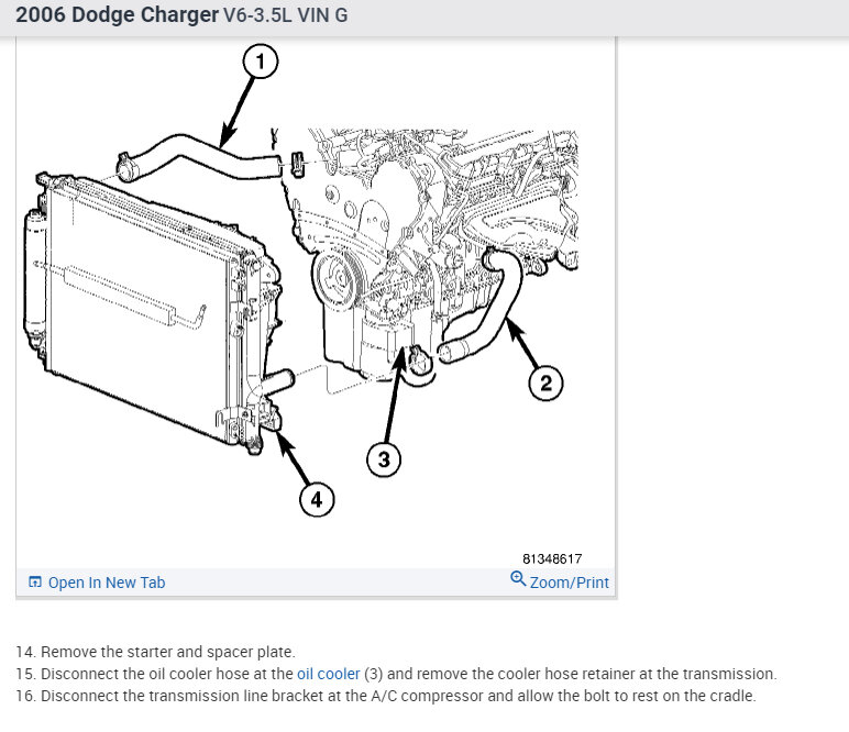

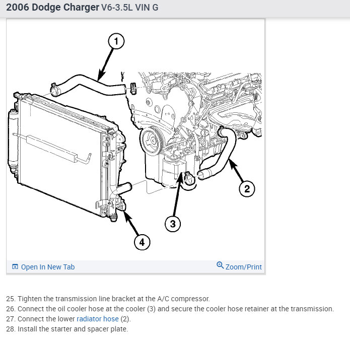

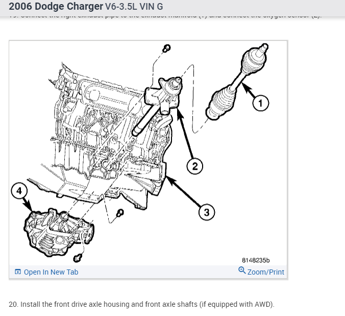

Can a 3.5 from a 2010 Chrysler 300 be swapped into my 06 Dodge charger 3.5? If so, what else would need to be changed?
Dec 16, 2022 at 4:31 AM
SQM
  • 6,383 POSTS

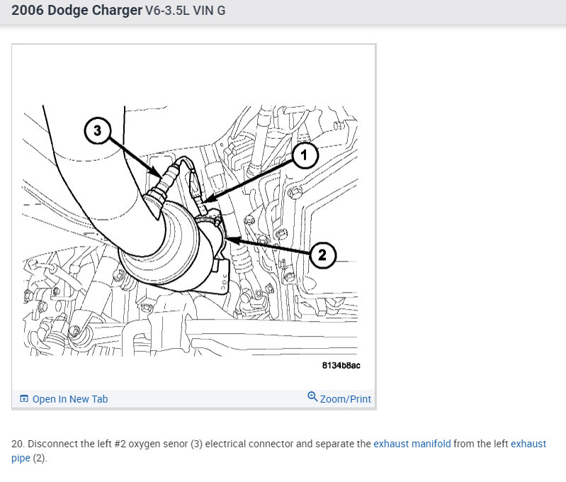

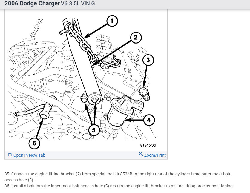

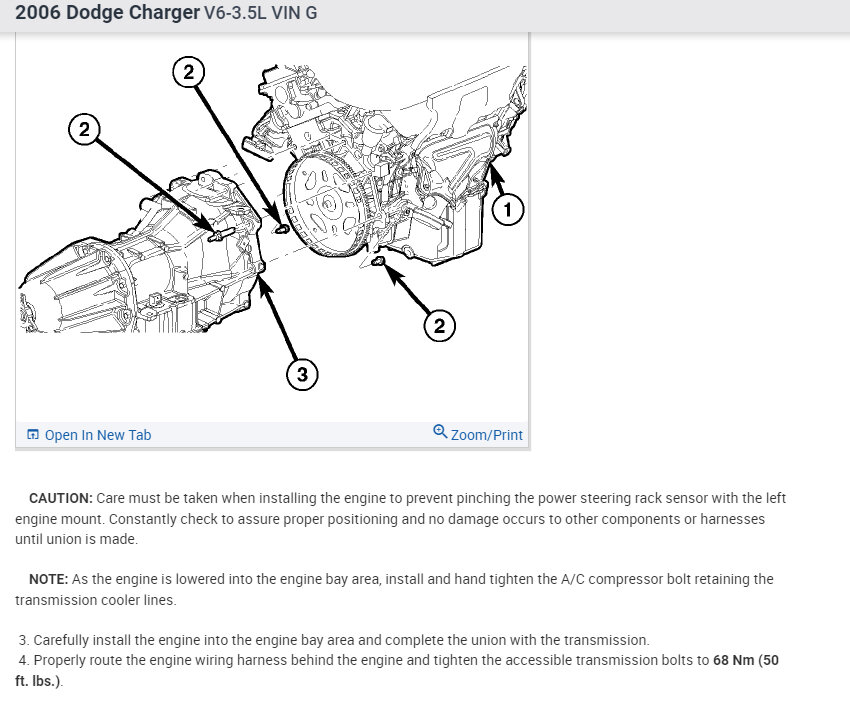

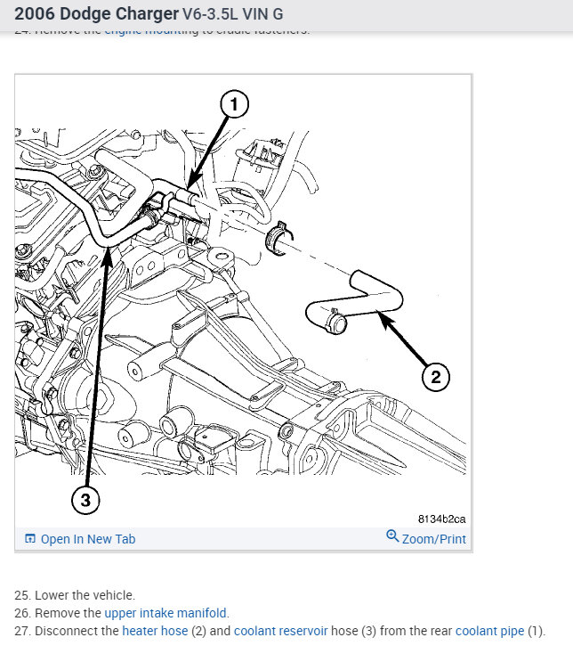

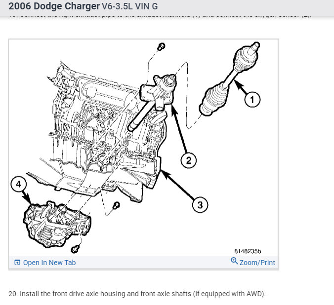

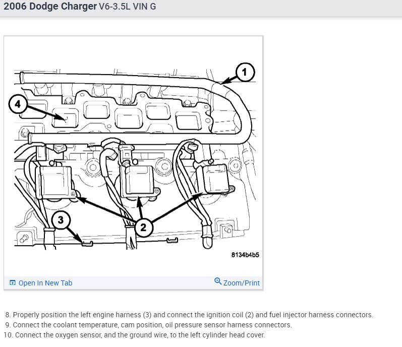

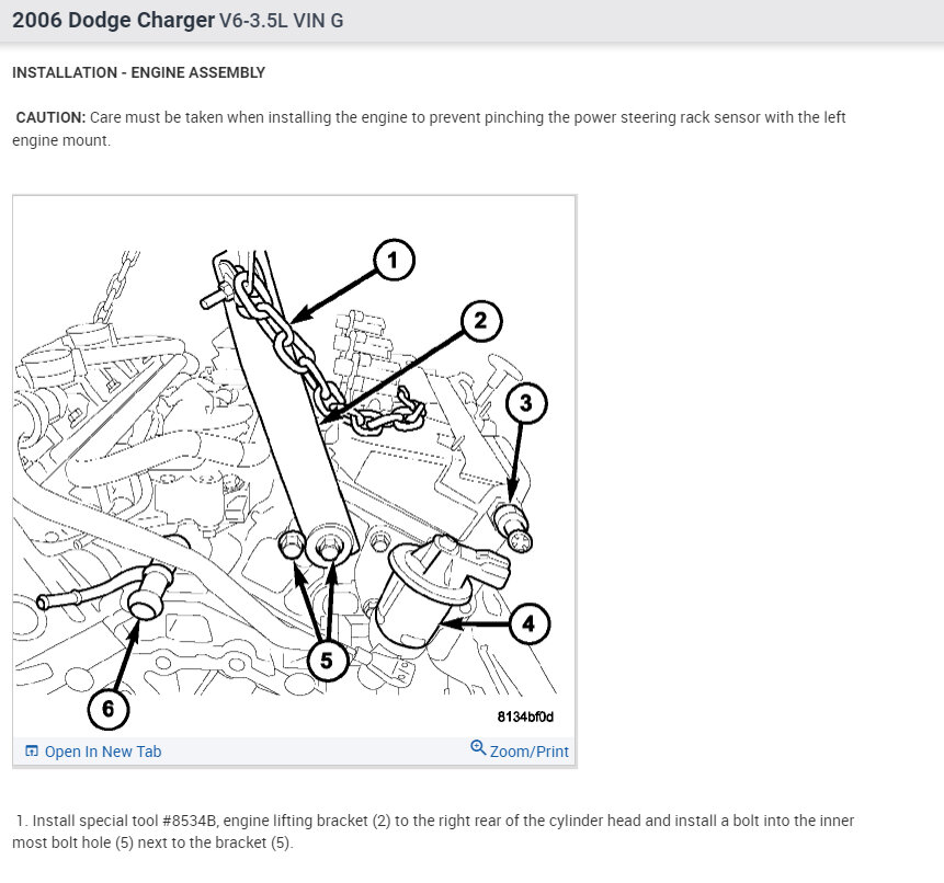

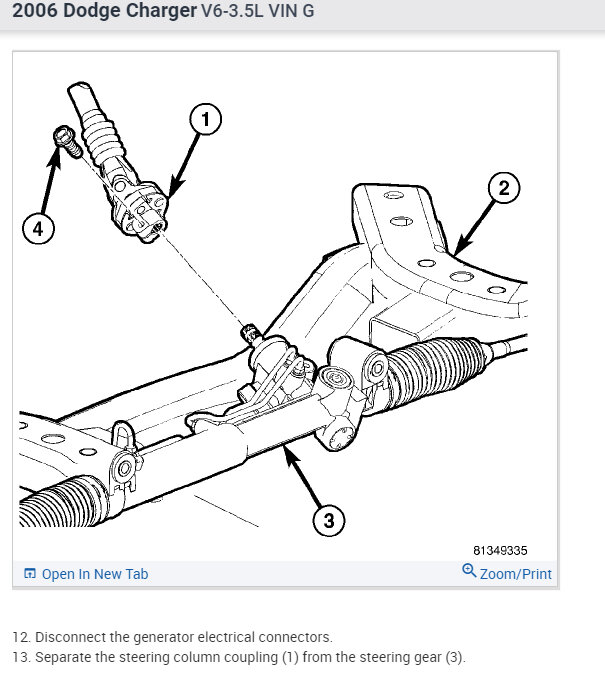

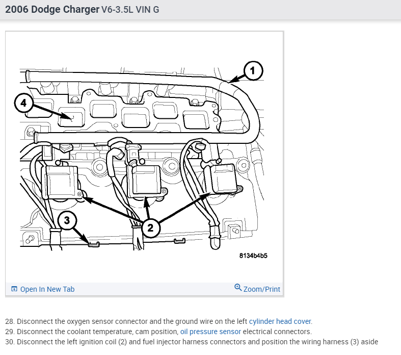

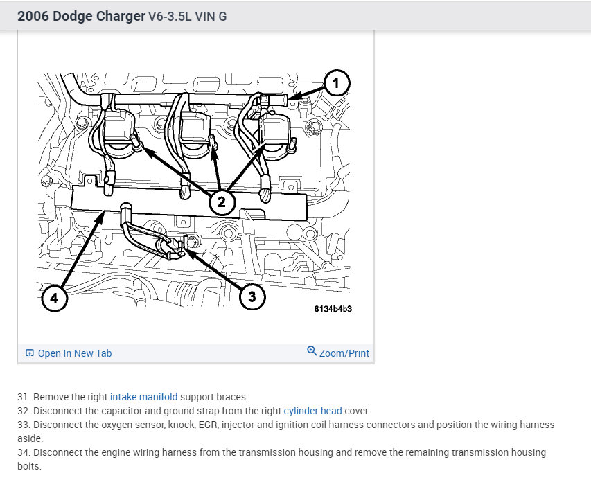

Those engines are not interchangeable.
These cars use same engine for 2006 and 2007 model year.
Also, the donor car will need to have G as the engine code.

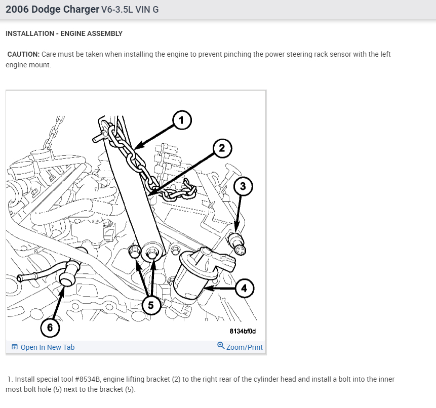

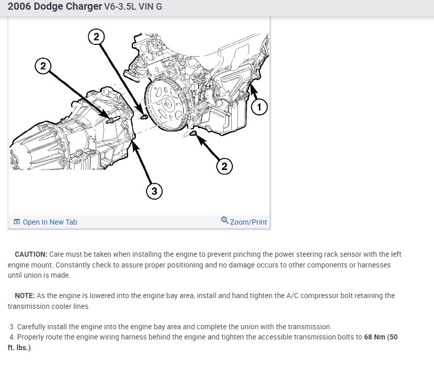

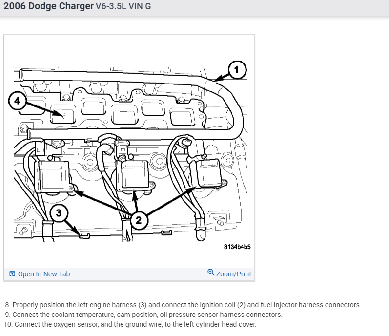

Here is a basic engine replacement tutorial:
https://youtu.be/zy1CozLgWUQ

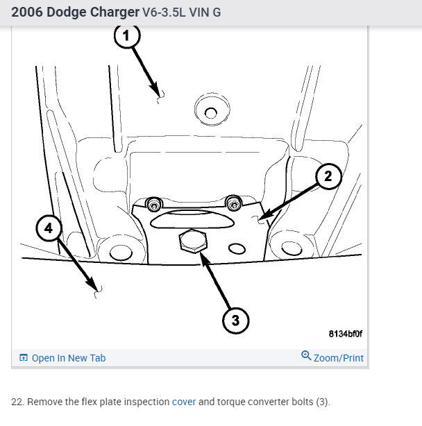

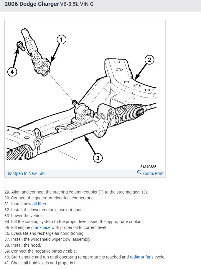

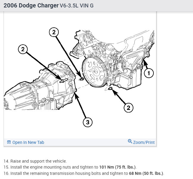

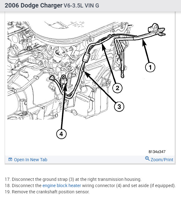

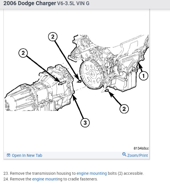

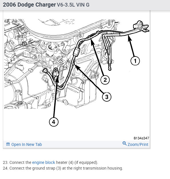

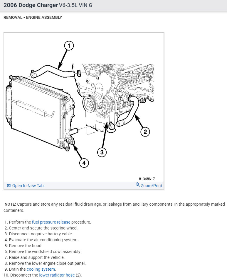

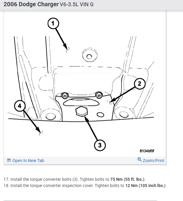

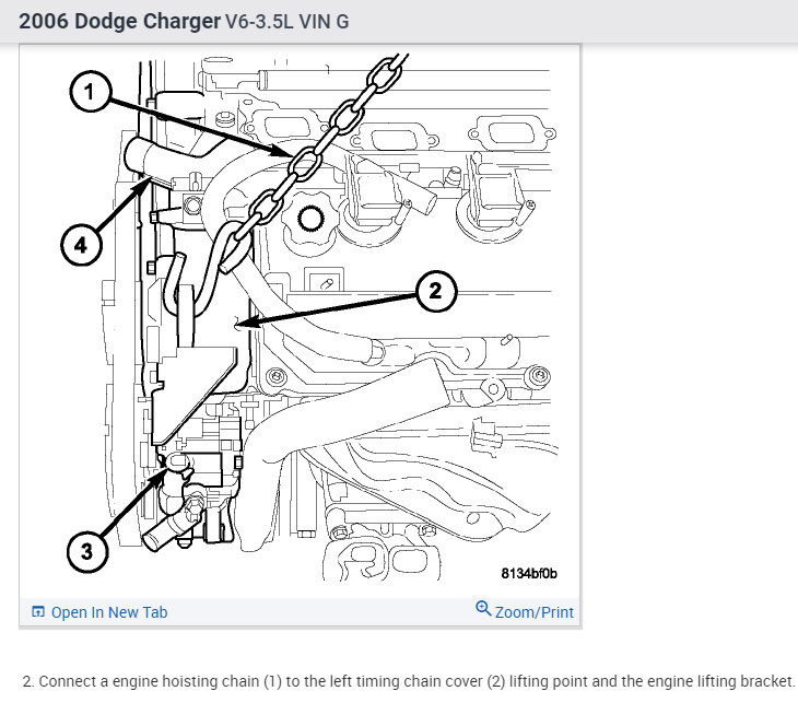

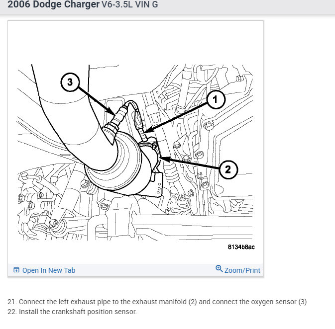

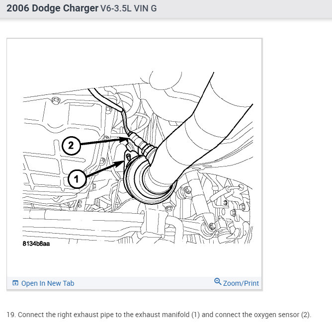

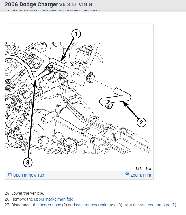

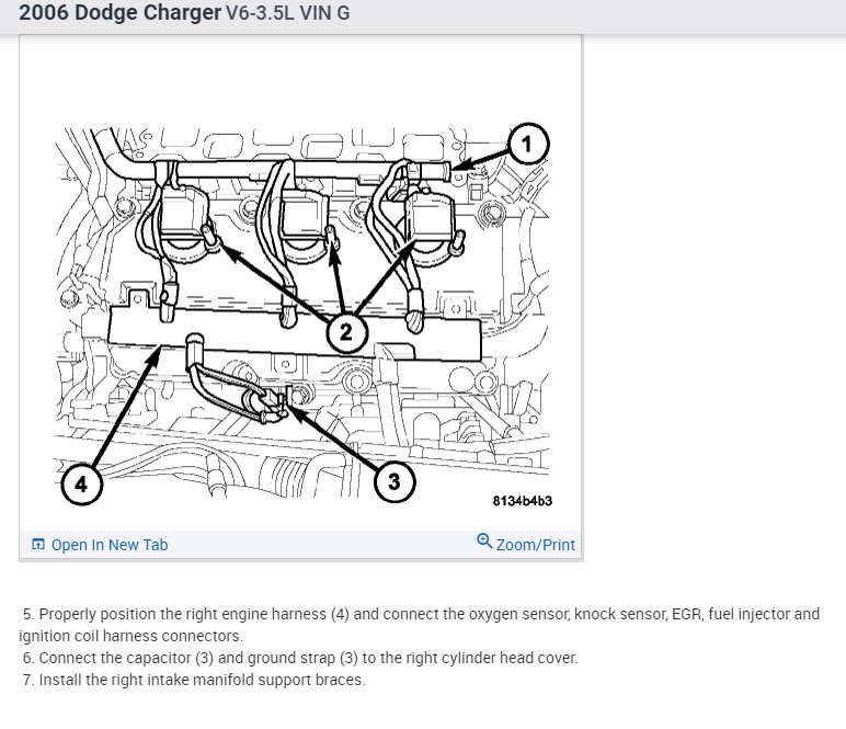

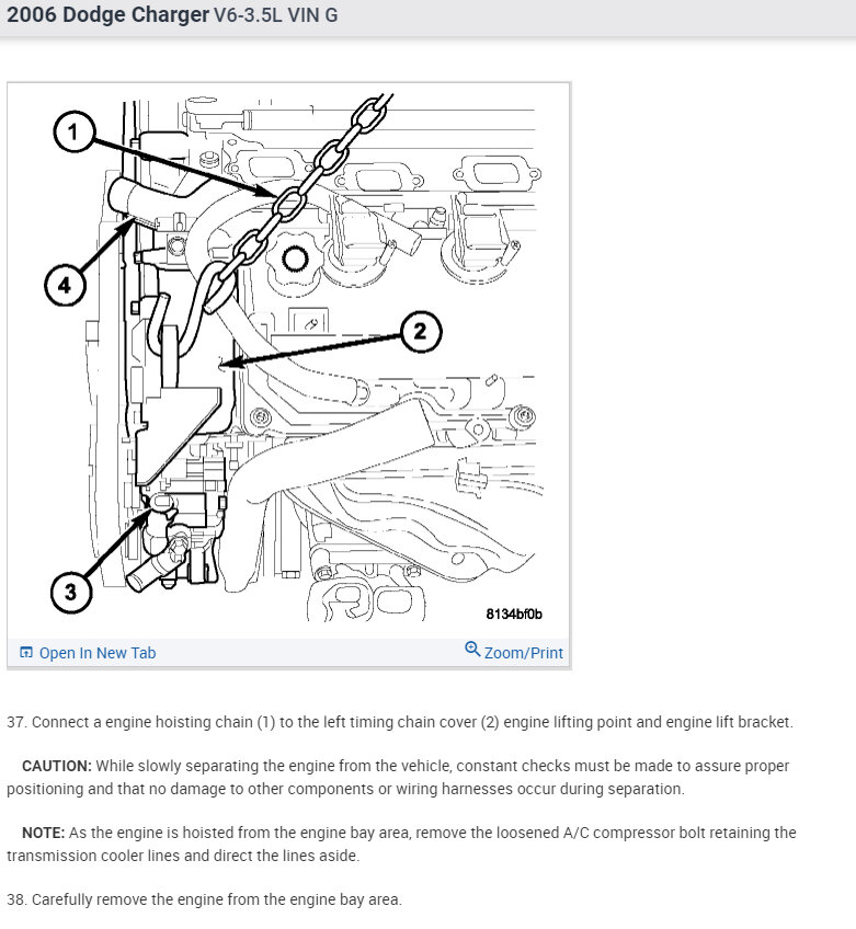

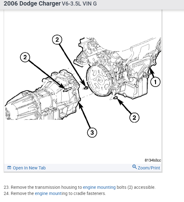

I have attached the engine replacement procedure below for your reference.
Let me know if you have any questions.
