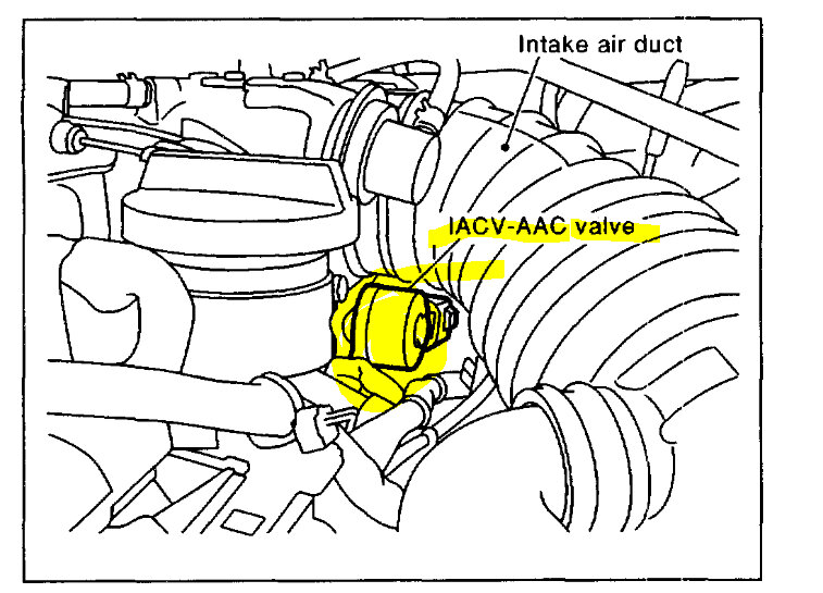

While warming, the engine revs and drops every 2 to 3 seconds repetitively, but when warm, the engine idles normally. Just had U tube above header replaced when Ammco performed valve cover replacement. Said only U tube cracked and needed to be replaced. Checked, and there were no vacuum leaks. Actually started problem after another shop replaced struts with Monroe Quickstruts, sway bar linkages, control arms, and rear shocks. This should have nothing to do with vacuum hoses or header work by Ammco).

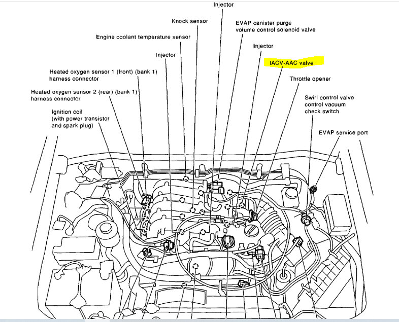

The idle speed is controlled by what is called an idle air control valve (IAC). Based on your description, that is where I would start.
I attached two pics below to help you locate the part. First, confirm the connector is tight, undamaged, and free of corrosion. If that appears good, then we need to remove it and check to see if there is a carbon build-up in the pintel and the intake. Take a look at this link. It explains in general how to service the IAC.
https://www.2carpros.com/articles/idle-air-control-valve-service
Additionally, if you want a better understanding of this component, take a look through this link:
https://www.2carpros.com/articles/how-a-idle-air-control-valve-works
Let me know your thoughts or if you have questions.,
