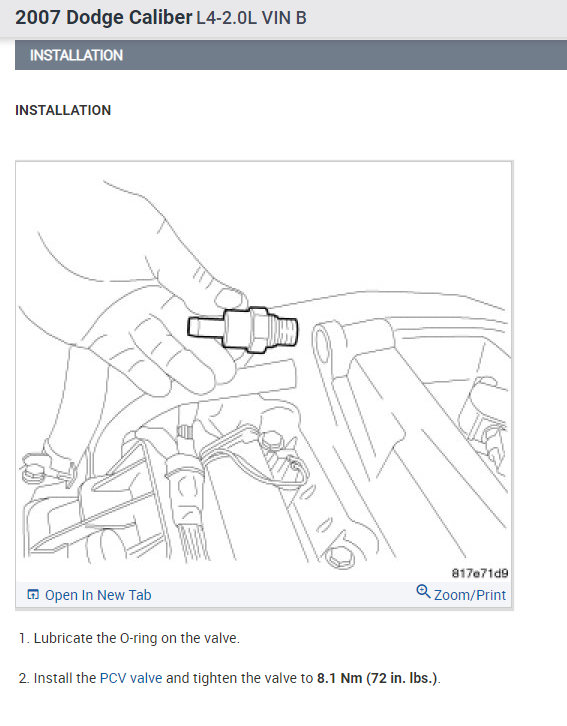

My question is, starting my car the hose coming from the intake manifold to the PCV/ valve blew out. Now my engine surges at idle and lightning bolt light comes on until I press the gas and then it goes off. Can someone please help me diagnose this problem? My diagnostics tool is not throwing a code???

If the PCV is not connected, there will be a large vacuum leak. That is likely the cause of the idle issue. Have you repaired it?
I attached the directions for installing a new PCV. Let me know if you have done this.

One of the common causes of surging is due to vacuum leak.
As you mentioned that the PCV valve blew out, you will have to replace the valve as well as the hose (if it has any cracks).
That should fix the surging issue as the vacuum leak will be fixed.
https://www.2carpros.com/articles/engine-surges
I have attached PCV replacement instructions for your reference.

Hi Joe. I ordered it today. I took it out and cleaned it and reinstalled it. Upon doing that it cracked. But I was able to get it back in. The ball inside the valve didn't seem to be stuck. It did rattle when I shook it. JC

Wow, I would have thought that would be hard to get. Make sure when you install the new one that the rubber brake hose isn't damaged, cracked, or dry-rotted. Also, make sure the hose isn't plugged.
Let me know how things turn out for you. If I recall, this PCV screws into the VC. I can't imagine how it popped out for you.

Hi Joe. I'll explain the valve itself didn't pop out but the hose that comes from the intake manifold is what popped out. Upon starting the car. I replaced it today and now it runs fine again. No more surging when idling. Looks like everything is good for now. Except my ABS light is on but it's been on since I bought the car 1 1/2 years ago. The girl I bought it from said she paid some guy to replace the front pads and when she got the car back the ABS light was on. The brakes are good, but I notice a scraping noise when backing out of my driveway. I've looked things over but don't see anything abnormal about the
