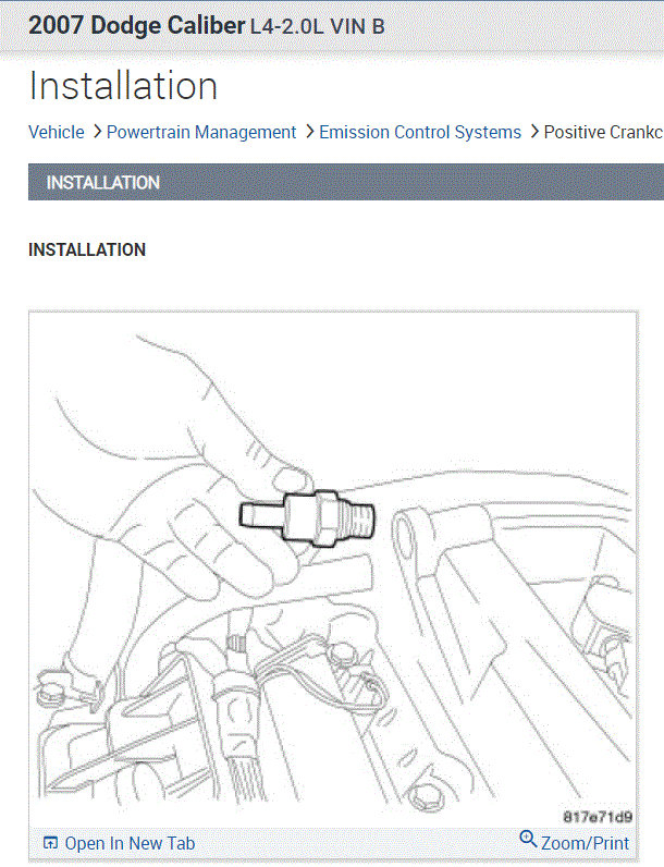

My question is, starting my car the hose coming from the intake manifold to the PCV/ valve blew out. Now my engine surges at idle and lightning bolt light comes on until I press the gas and then it goes off. Can someone please help me diagnose this problem? My diagnostics tool is not throwing a code???

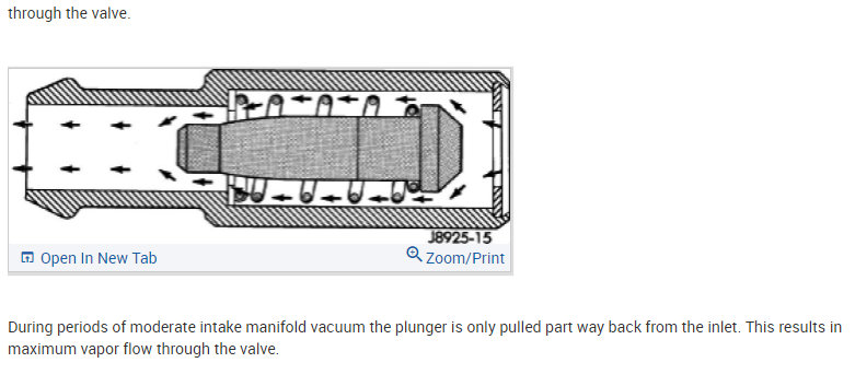

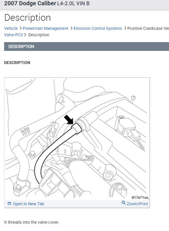

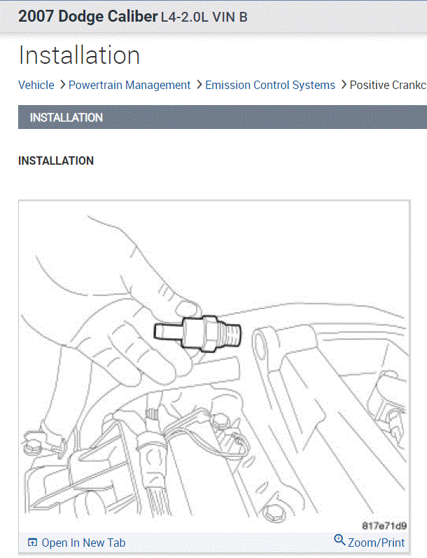

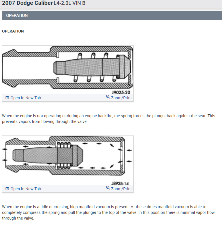

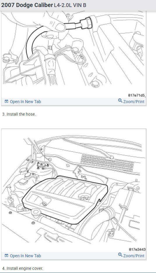

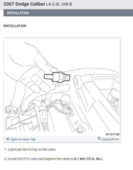

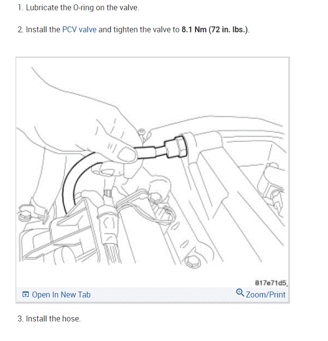

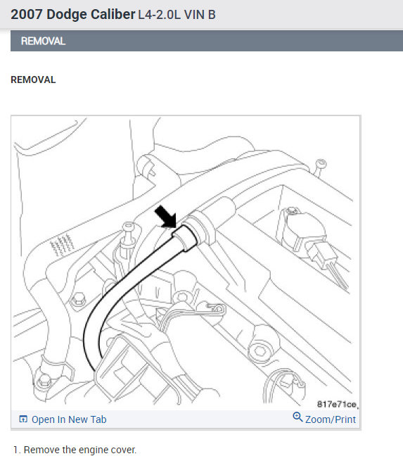

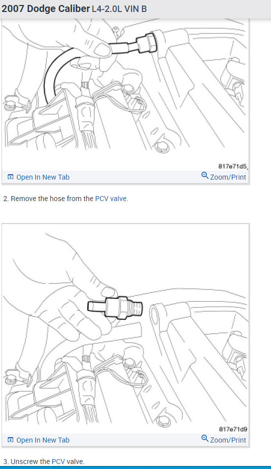

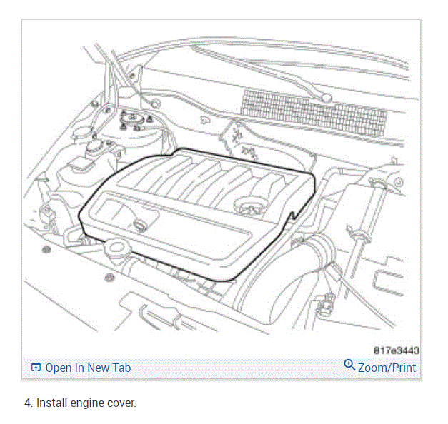

If the PCV is not connected, there will be a large vacuum leak. That is likely the cause of the idle issue. Have you repaired it?
I attached the directions for installing a new PCV. Let me know if you have done this.

One of the common causes of surging is due to vacuum leak.
As you mentioned that the PCV valve blew out, you will have to replace the valve as well as the hose (if it has any cracks).
That should fix the surging issue as the vacuum leak will be fixed.
https://www.2carpros.com/articles/engine-surges
I have attached PCV replacement instructions for your reference.
