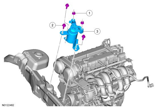

How many engine support or mount it has? I've been searching on many internet sites and owner manual can't figure it out.

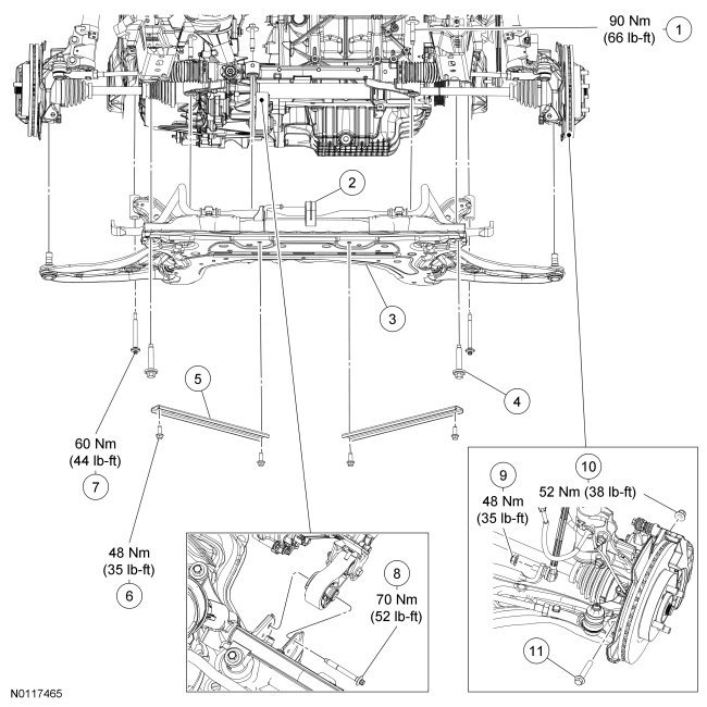

The main supports are on the front and the rear transmission mount, the mount on the front of the sub-frame is for torque and not weight, so 3 mounts. Here are pictures from the repair manual:

Should I replace all of the or just the broken one?
Nov 6, 2019 at 8:46 AM
MASTERWRENCH
  • 258 POSTS
Typically you only replace the ones that are broken. However, I would inspect the others for signs of wear or cracking. If you find any of this, it would be a good a idea to replace those as well.
