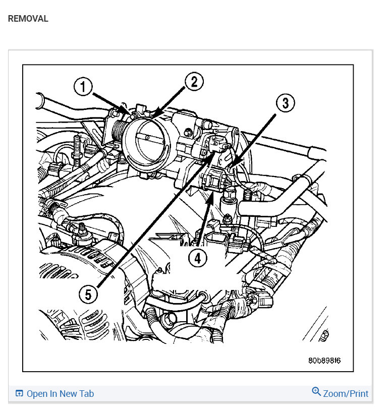

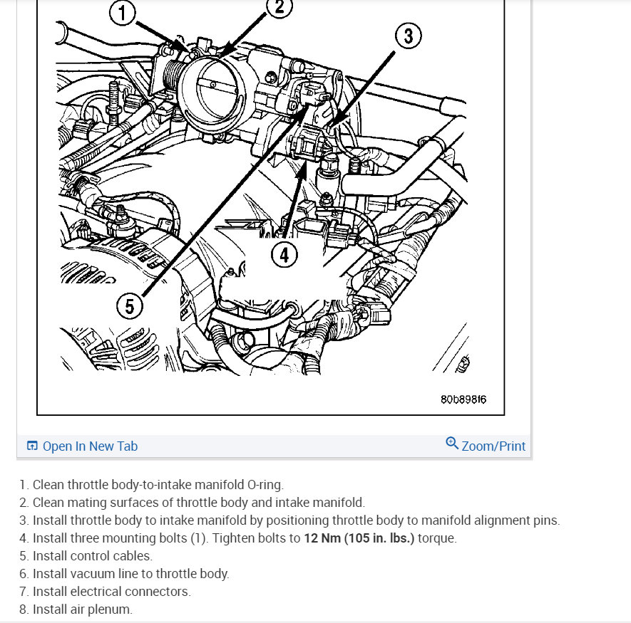

This can happen when the throttle actuator gets dirty and needs to be serviced. Here is a generic guide to help you see wat you are in for and specific instructions in the diagrams below to show you on our car:
it can also be a vacuum leak which is common please, do this check when the engine is cold.

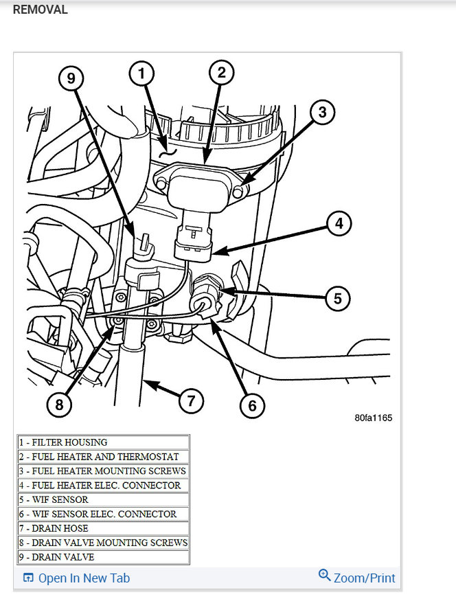

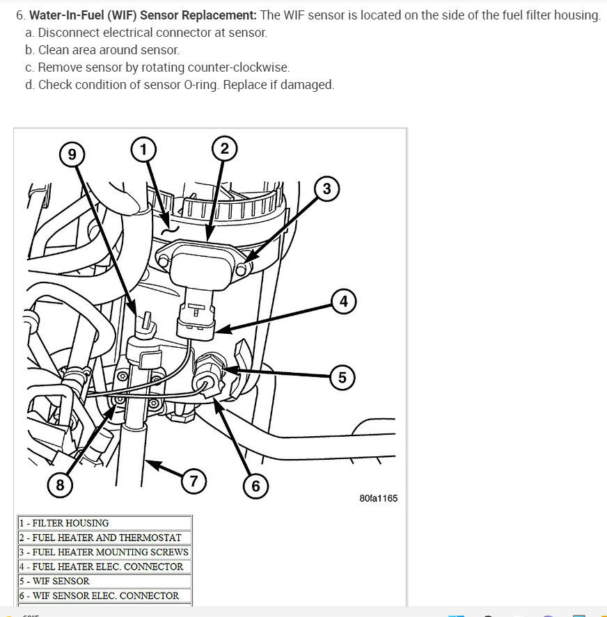

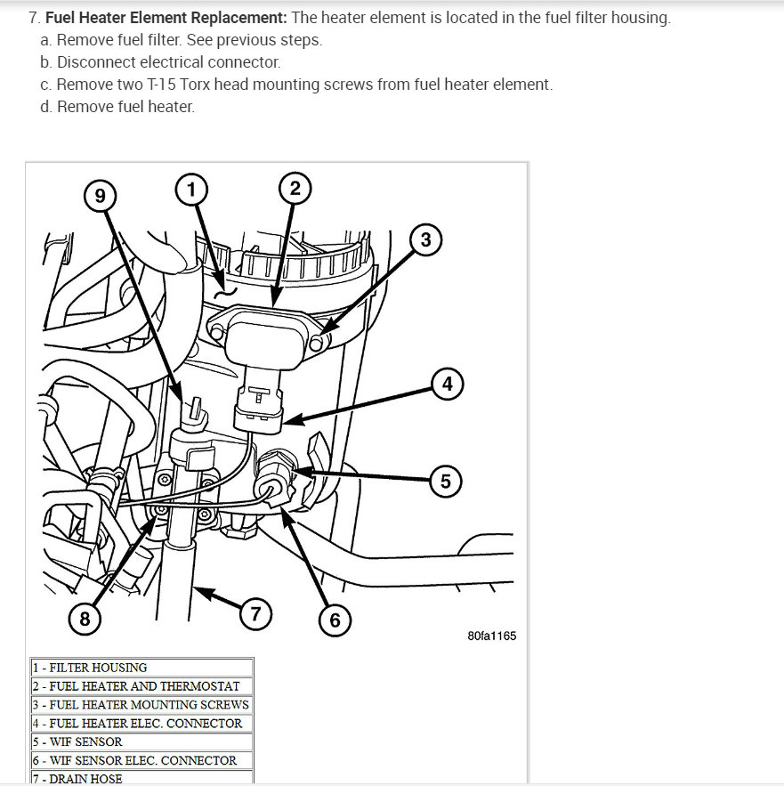

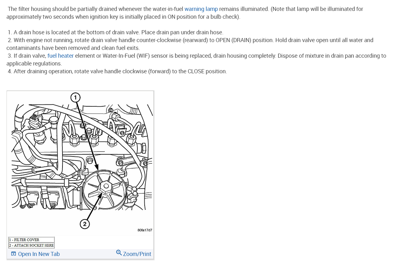

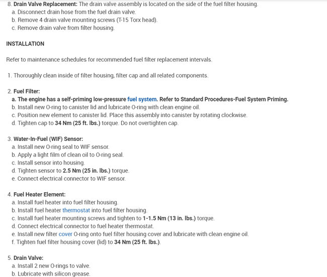

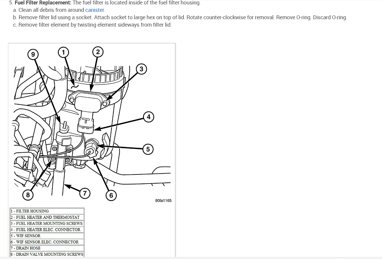

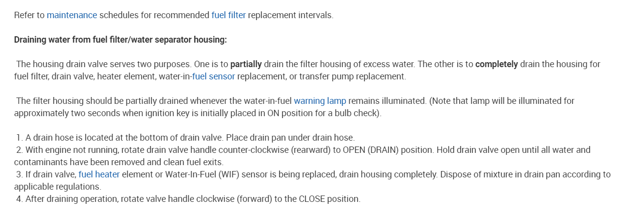

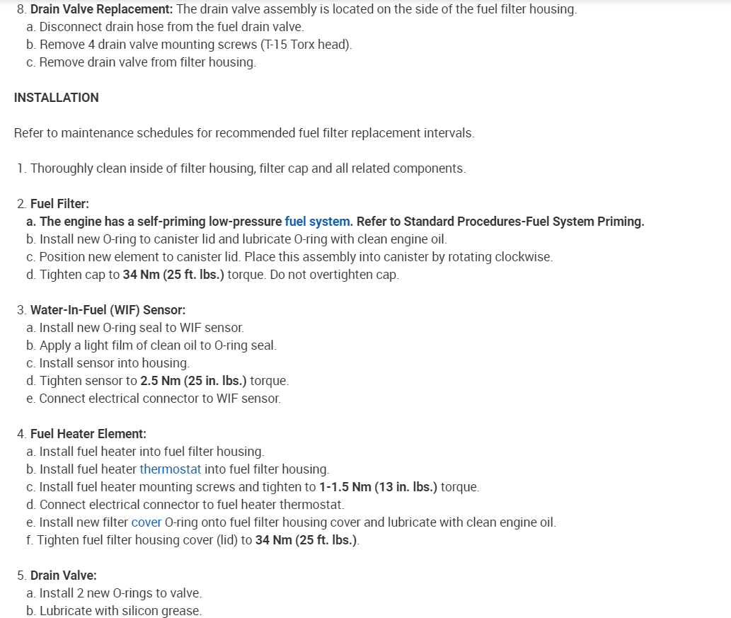

I would start by servicing the fuel filters; you could have water in the fuel. here is a video to help and instructions for your truck in the diagrams below:
https://youtu.be/6de-1mIpzi8
