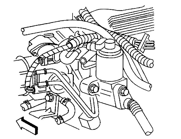

Start the car, runs fine, go to accelerate car almost shuts off. Let the engine throttle for a little while. Car runs fine. Happens on rainy and humid days. I have changed plugs and wires, was told to change the coil packs. They had rust on three of six posts. Ran the car again, same problem. Only code is an EVAP leak (small). What else could it be?

The first thing I would do is check the fuel pressure. Low fuel pressure will cause this issue.
Another possibility is the EGR valve. If it is partially open it will cause a cold engine hesitation.
Is the check engine light on? If it is, do you know the codes?

The only code is p442.

This is the description and diagnostics need to be done for this code.
This code has no effect on your current issue.

I finally found a pressure gauge. The fuel pump was bad, replaced it and the filter for $348.00 and the cars runs like new again
