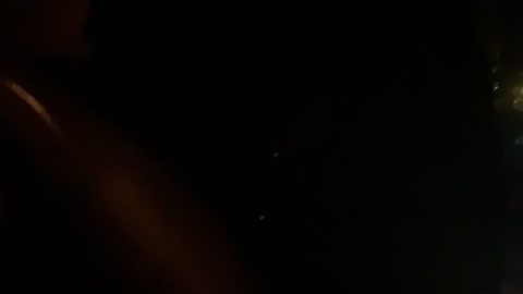

Here’s a video of how it acts of me starting it each way and the dash lights. If I start it normally it shuts off in 2 seconds. If I hold the key back for a few extra seconds it stays running.

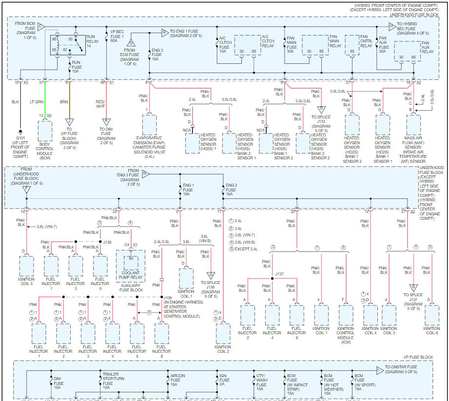

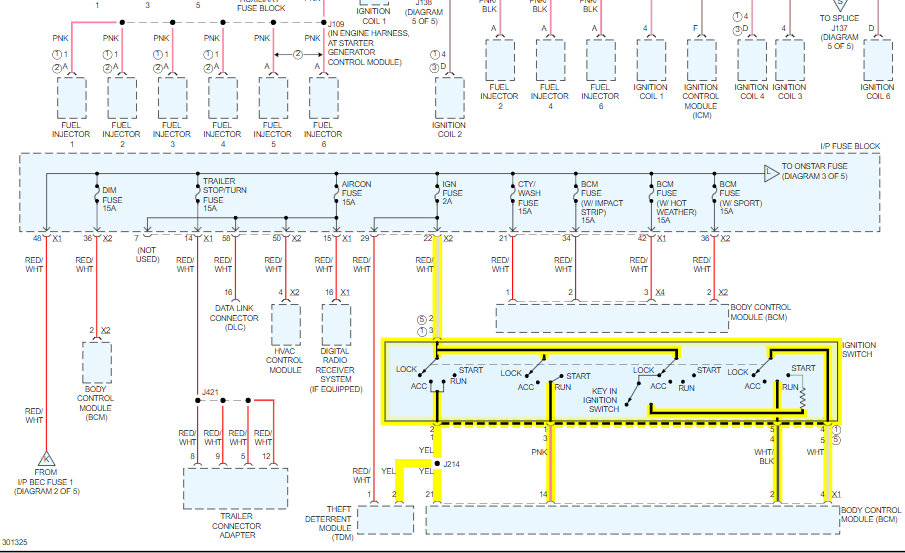

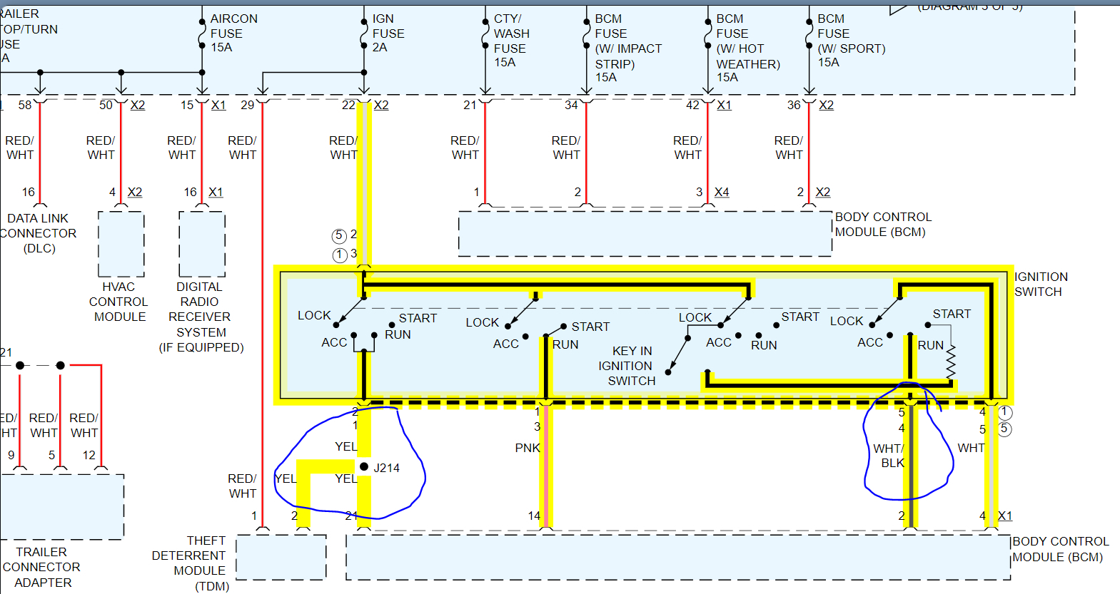

Good morning,
I attached a wiring diagram for you to view. I circled 2 wires that you need to check for power with the key in the on position.

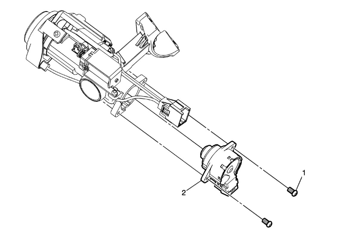

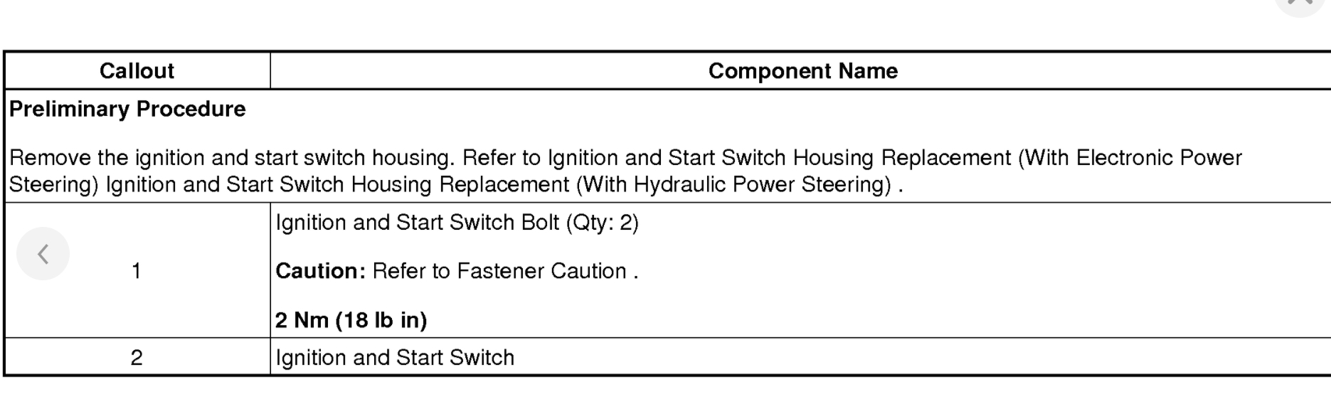

This sounds like the ignition switch is the issue. I attached the procedure for you for the replacement as well.
