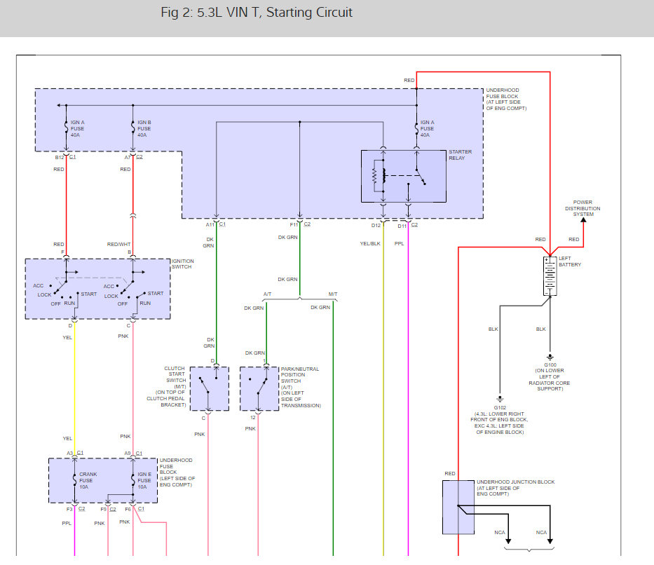

When key is turned from off to run, the starter engages without reaching the run position. I have changed the starter relay and the ignition switch. I could use some advice on why my starter is being powered in the run position? Thanks.
Jan 22, 2018 at 2:20 AM
  • 55,394 POSTS

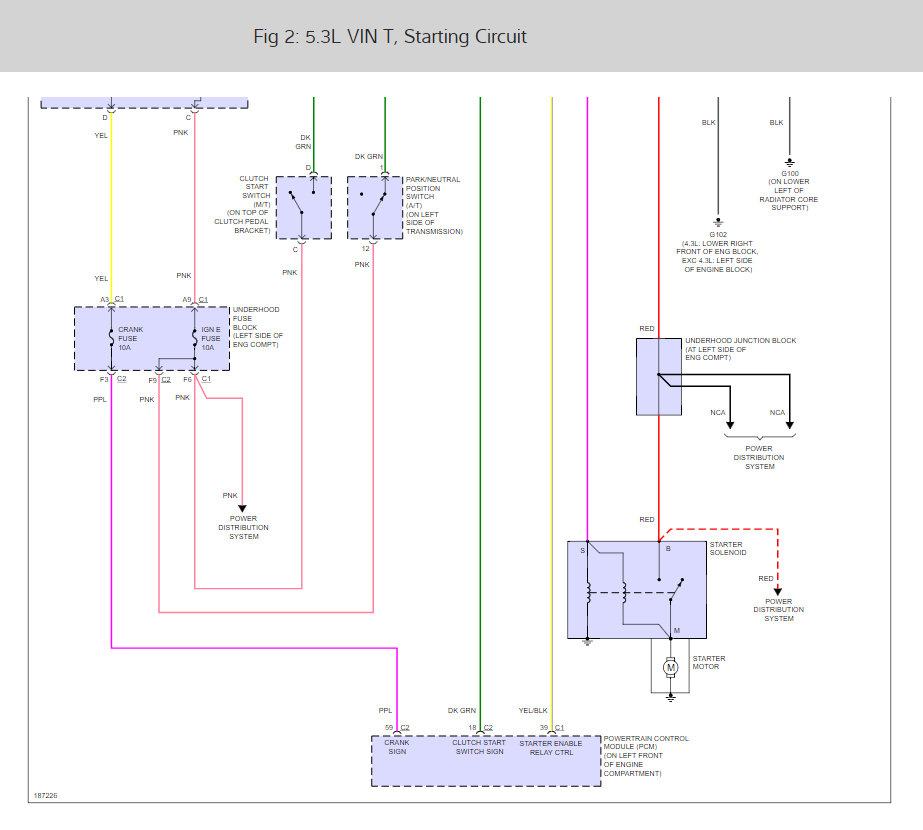

The only thing I can think of is the wiring is messed up somehow or the PCM needs to be replaced. Lets check the power wires first to make sure nothing is crossed.
Here is a guide to help you see if there is power coming from the ignition switch when it is not suppose to:

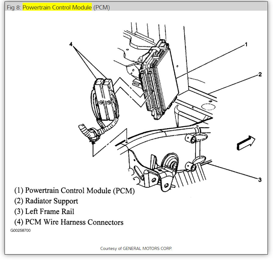

If there is not power and the starter engages it is a PCM problem and it needs to be replaced.
Below is the starter wiring diagrams and PCM location which you will need a shop to program for you.
