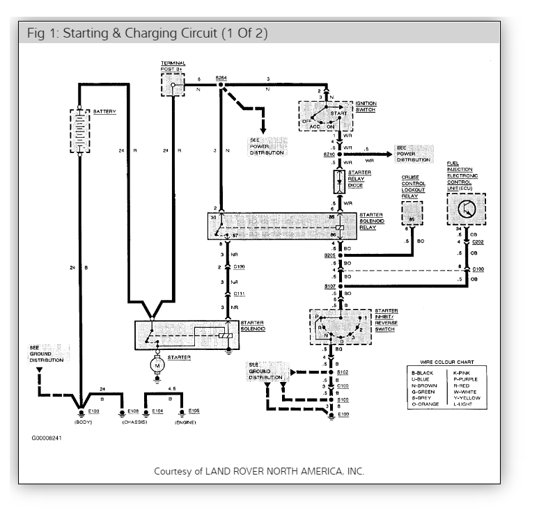

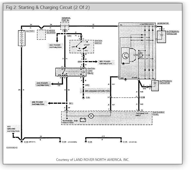

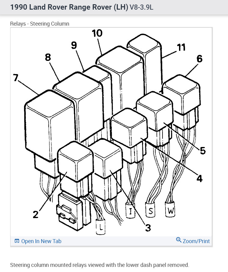

How to check the safety switch? It has four pins, I need the wiring diagram, and the location of the starter relay.

Hi Sevag,
Here is the start relay location and the starter and neutral safety switch wiring diagrams with a guide to help you test the circuits:
5. Starter solenoid relay .................... 6 - Main
