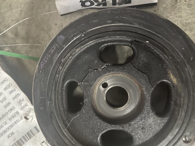

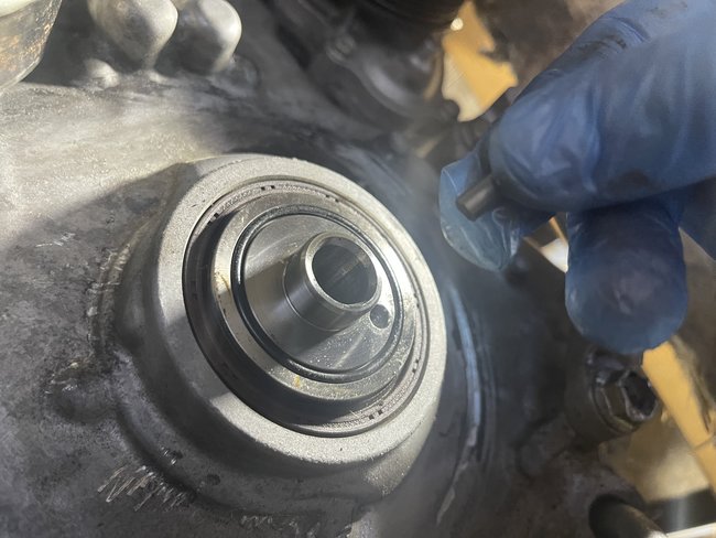

I got it in it. The harmonic balancer on the new engine has a crack in it so i removed it and will use mine. But i found that the small little pin is broken, is this a big deal?

It will need to be replaced. That pin helps hold the balancer in place to allow timing and belt drive without relying only on the taper of the shaft and bolt. They combing to hold it. The pin should only be a light fit so if you can get a small carbide bit to drill a small hole in the broken piece to might be able to remove it that way. I would drill a hole, then insert a small threaded screw and try to extract it.

Yeah it isn't going to be a fun thing to replace. The other option would be to use a drill guide and drill it out but that is a really touchy thing because and alignment issue will cause problems. Oh, and if you try to use a lot of heat you can damage the seal and the main bearing. What is the issue with the original engine?

Original motor was locked. Got a replacement for it and i guess from shipping or whatever the pulley had a crack so was going to install my pulley, and then found it was broken. No i wont use heat for sure.

Well, worst case would be to check the other crankshaft and if it's okay you could have it ground if needed and swap it over with new bearings, or if you can't get the pin out pull that crank out and have a shop try. They could also do a different option which would be to install a short pin to use as a locator pin and then drill a new one through the balancer and into the crank snout. That would do the same thing to give it support.

It holds the pulley from moving, if that pulley starts moving on the end of the crank, it chews up the end of the crankshaft and the pulley as well. No different than the camshaft sprocket keyway just inside the cover. They use a pin on those because of the seal being there, on other engines there is a key for the damper, all for the same reason.
