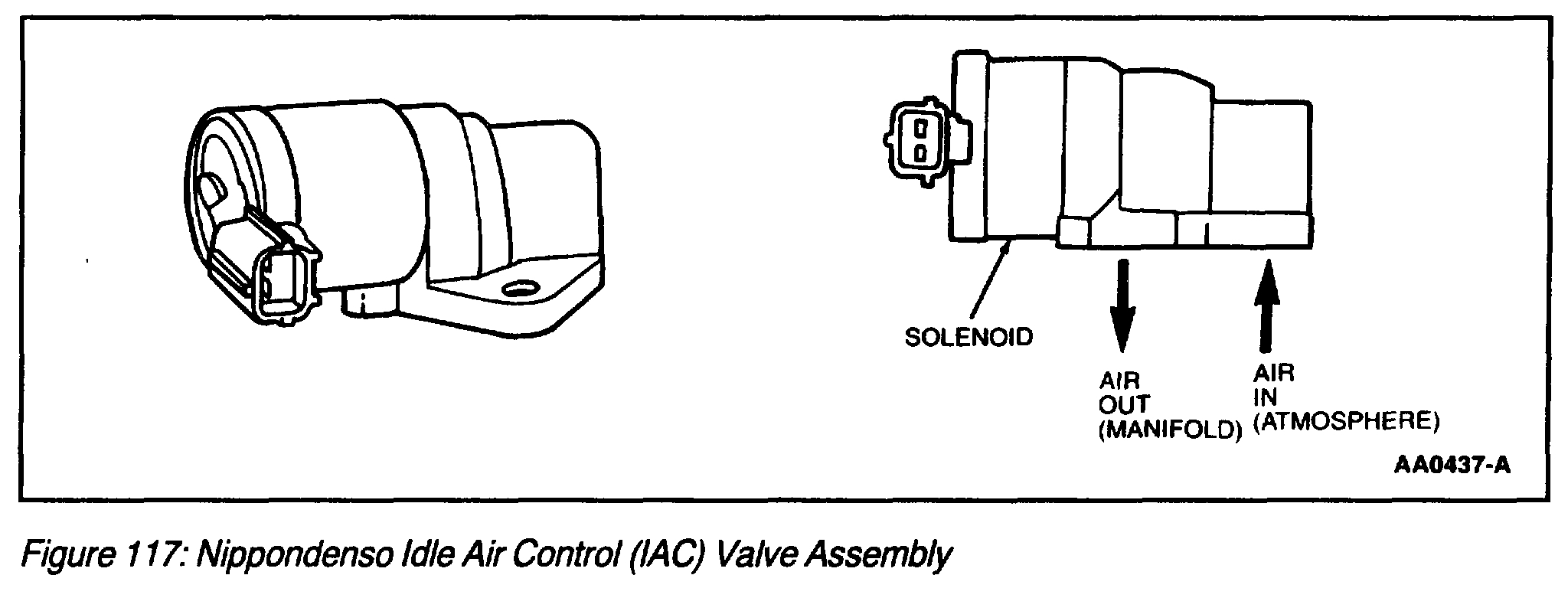

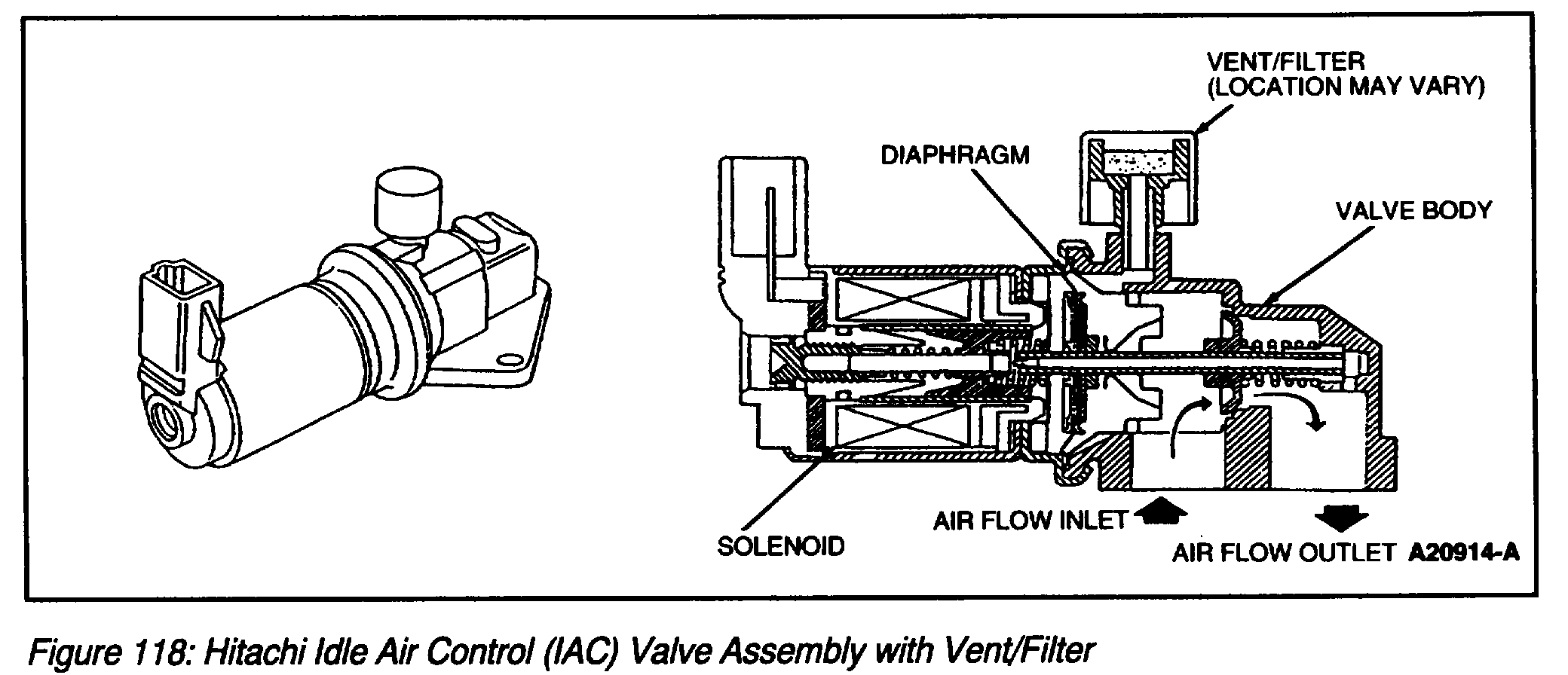

If you find there are no engine vacuum leaks, make sure the air filter is not plugged with dirt or debris. Next, the idle air control valve maintains engine idle speed. Here is a description of the component specific to your vehicle. Note that there are two different ones that were used. The first three attached pictures correlate with this description
______________________
Idle Air Control Valve
Nippondenso Idle Air Control (IAC) Valve Assembly
Hitachi Idle Air Control (IAC) Valve Assembly With Vent/Filter
The idle air control (IAC) valve assembly (Figure 117) and (Figure 118) controls engine idle speed and provides a dash pot function. The IAC valve assembly meters intake air around the throttle plate through a bypass within the IAC valve assembly and throttle body. The PCM determines the desired idle speed or bypass air and signals the IAC valve assembly through a specified duty cycle. The IAC valve responds by positioning the IAC valve to control the amount of bypassed air. The PCM monitors engine rpm and increases or decreases the IAC duty cycle in order to achieve the desired rpm.

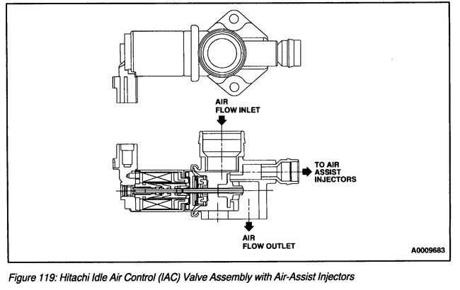

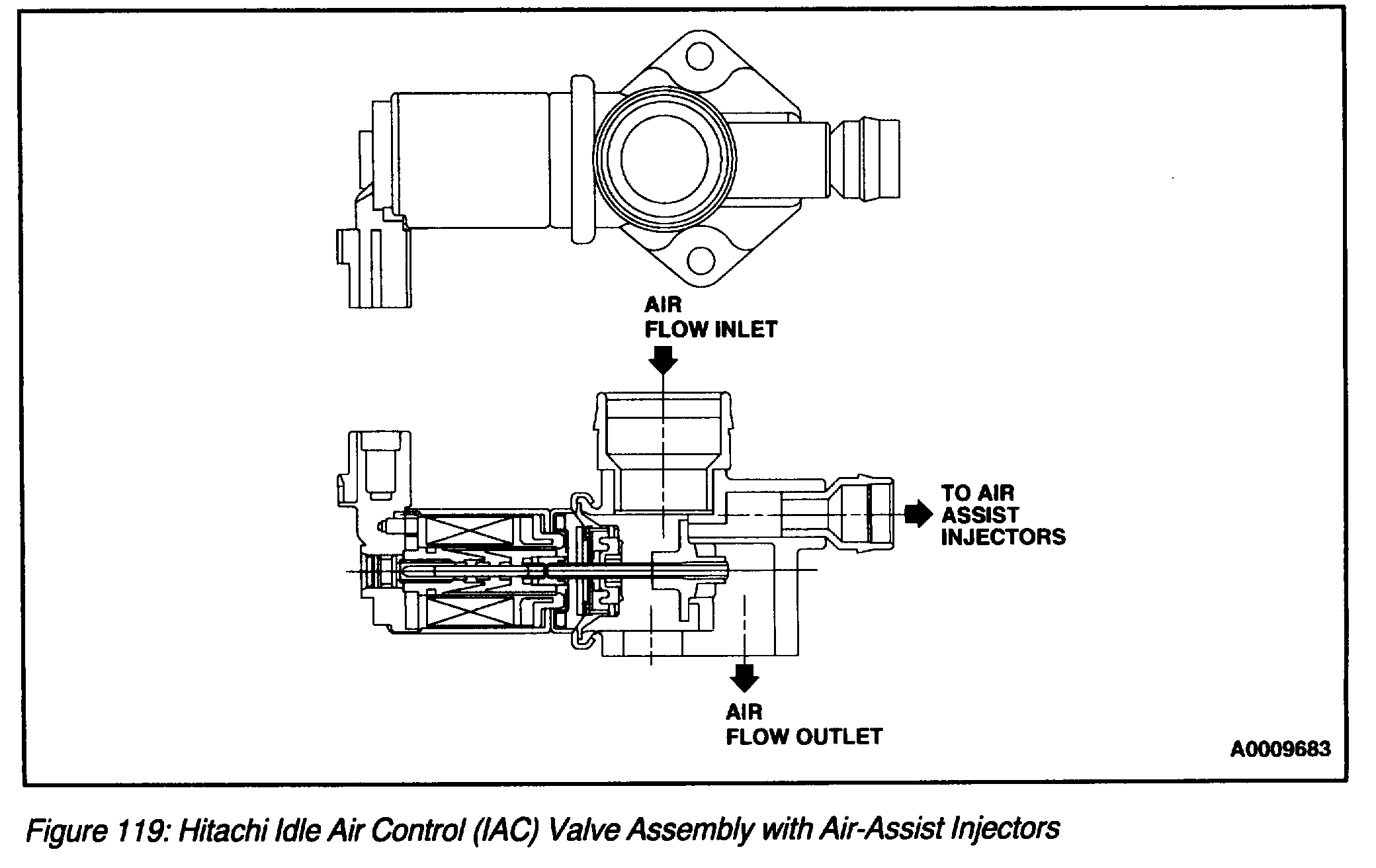

Hitachi Idle Air Control (IAC) Valve Assembly With Air-Assist Injectors
On applications with air-assisted injectors, the AC valve (Figure 119) also supplies a small amount of air into the path of the fuel injectors. The jet of air causes an increase in fuel atomization at low speed and light load conditions.

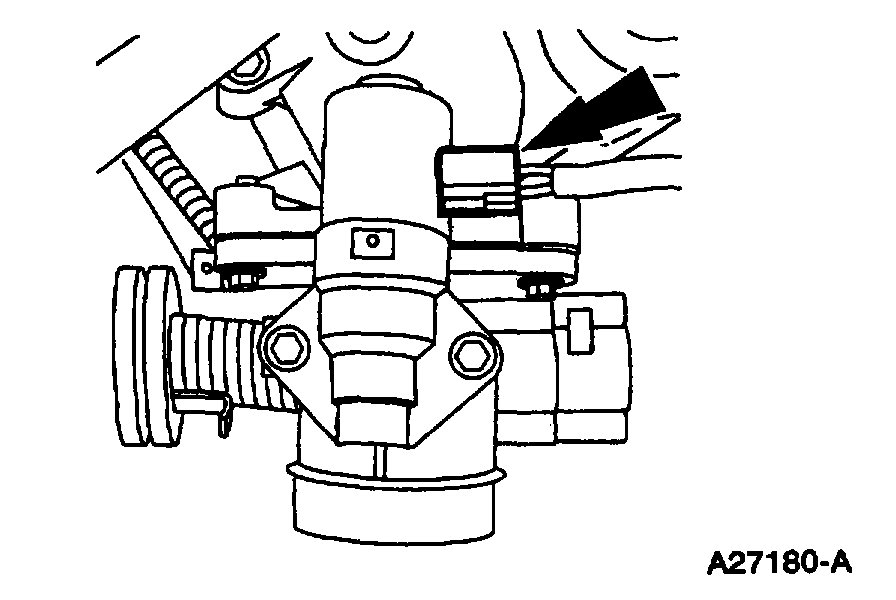

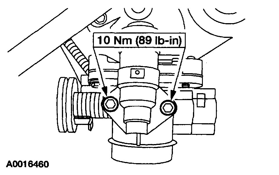

Here are the directions for removal and replacement of the IAC. The remaining pictures correlate with these directions. I am including these directions because if there are no vacuum leaks, I need you to remove the IAC and inspect it for excessive carbon build up and if it is functioning. First, here is a link that shows in general how one is replaced.
https://www.2carpros.com/articles/how-to-replace-an-idle-speed-control-motor-iac
The following directions are specific to your vehicle.
REMOVAL
1. Disconnect the battery ground cable.
2. Disconnect the Idle Air Control (IAC) valve electrical connector.
NOTE: Manual transmission shown, automatic transmission similar.
3. Remove the bolts and the IAC valve and gasket.
INSTALLATION
1. To install, reverse the removal procedure.
CAUTION:
^ If scraping is necessary, make sure not to damage the idle air control valve or the throttle body gasket surfaces or drop the gasket material into the throttle body.
