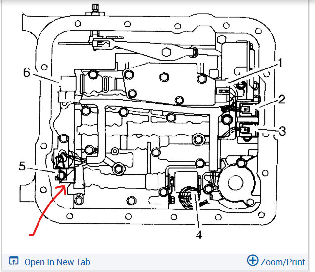

To me is sounds like the transmission or catalytic converter is having an issue. If the TCC is stuck, putting the transmission into gear is like dumping the clutch in a manual transmission without pushing the clutch pedal, the engine stalls. Is this what it seems like it happening? Here is a video to help to confirm the catalytic converter issue of not, also here is the location of the TCC solenoid so you can swap it out as well.

If you've ever owned a carburated vehicle and the idle was set too low which caused the engine to stall as you came to a stop, it's like that. I'll try the laser thermometer test on the cat and see if I can test the ohms on the tcc solenoid. I'm pretty sure I can command the tcc to engage with my scan tool. How could I tell if its actually working if I do?

Yep, there should be codes but not all the time, if you drive the car you should be able to command the TCC solenoid on and off and you should be able to feel the difference from one to the next, if so we can rule the TCC solenoid out. Also, I have seen the torque converter itself come apart internally and cause the engine to stall due to the clutch not releasing. Let me know how it goes.

I changed the fuel filter, for good measure and the engine stopped stalling when I put it in drive and also when I come to a stop. I took it for a 30 mile drive, 15 to destination, 15 back. I used the scan tool to command the tcc on while on the streets, but honestly, I couldn't tell a difference with it on or off. It did show in the live data that it was cycling between yes and no under "TCC Enabled" as I was driving and "Torque Converter Efficiency" showed 0.99.

Yep, I would double check the transmission fluid level and if it is okay the transmission needs a rebuild. The reason it stalls is because the torque converter is not disengaging which happens when the transmission is full of metal. Thanks for the video it helped.
