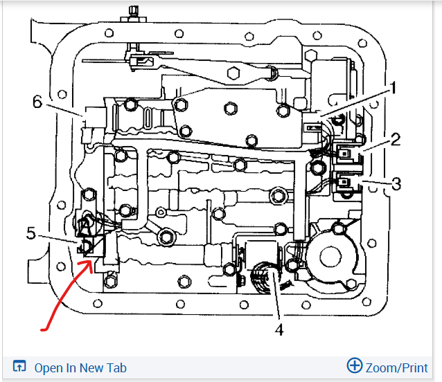

I have the 5.3 flex fuel engine. About a week ago, the truck started having an occasional issue where when you hit the gas, the engine would rev, but the truck wouldn't accelerate for a few seconds, like it was slipping. Sometimes it's like it builds up and then finally catches and launches you forward, other times it feels like it's in too high of a gear and won't downshift to the correct gear.
Then, it started occasionally stalling when coming to a stop as the RPMs would drop to idle. That has now turned into the engine stalling every time I put it in drive from park. If I put it in reverse, it's fine, but as soon as I drop it down to drive, the engine stalls. If I keep the engine running by feathering the gas then it will stall when I come up to the next stop. Placing the transmission in neutral just before I stop will keep it running and then back into drive with a little feathering to go again.
My first thought was fuel pressure so I replaced the fuel pressure regulator. Static pressure (KOEO) while the pump primes is about 48 psi, when it stops priming it's about 40 psi. Running pressure is also about 40 psi, pulling the vacuum line from the regulator while running jumps the pressure up to about 46 psi.
There were 2 pending codes, bank 1 rich and bank 2 rich, but no stored codes. I have a mid-level scan tool that is bidirectional and can do many active tests and special functions. I did a misfire count test, but all were zero. I also did a transmission slip test, which also was zero (it's possible I didn't do it correctly).
I've clean the mass air flow sensor and the throttle body. With there being no stored codes, I'm not sure where to go from here.

To me is sounds like the transmission or catalytic converter is having an issue. If the TCC is stuck, putting the transmission into gear is like dumping the clutch in a manual transmission without pushing the clutch pedal, the engine stalls. Is this what it seems like it happening? Here is a video to help to confirm the catalytic converter issue of not, also here is the location of the TCC solenoid so you can swap it out as well.

If you've ever owned a carburated vehicle and the idle was set too low which caused the engine to stall as you came to a stop, it's like that. I'll try the laser thermometer test on the cat and see if I can test the ohms on the tcc solenoid. I'm pretty sure I can command the tcc to engage with my scan tool. How could I tell if its actually working if I do?

But wouldn't there be a cat or tcc code?
Mar 16, 2026 at 4:24 AM
  • 55,214 POSTS
Yep, there should be codes but not all the time, if you drive the car you should be able to command the TCC solenoid on and off and you should be able to feel the difference from one to the next, if so we can rule the TCC solenoid out. Also, I have seen the torque converter itself come apart internally and cause the engine to stall due to the clutch not releasing. Let me know how it goes.

I changed the fuel filter, for good measure and the engine stopped stalling when I put it in drive and also when I come to a stop. I took it for a 30 mile drive, 15 to destination, 15 back. I used the scan tool to command the tcc on while on the streets, but honestly, I couldn't tell a difference with it on or off. It did show in the live data that it was cycling between yes and no under "TCC Enabled" as I was driving and "Torque Converter Efficiency" showed 0.99.
15 minutes of freeway driving with no issues. On the return trip, as I was getting on the freeway, halfway up the on ramp the engine rev'd almost to redline, but the truck wasn't accelerating anymore. I let off the gas and pressed it again and it was fine. No other issues on the freeway. I get to the very last red light before my residential street and as I'm coming to a stop, the engine starts to sputter like it wants to stall. The light changes and I go. Pulled into my driveway and again, sputtering like it wants to stall, although it didn't and I shut it off.
I did notice after I changed the fuel filter that the static fuel pressure would drop from about 40 psi to about 20 psi within 5 minutes or so, but then hold at 20.

Wow, thanks for the great video, it does look like one of the cats is not working correctly and could be broken apart inside which will make the engine stall and have low power rough idle sometimes. You may want to remove the unit for inspection, you are looking for broken up catalyst material. We have done many in the shop, here is a video to help.
https://youtu.be/CORe9JyrexI?si=tA-Lh9w7RnZwczrO
Also, if the transmission fluid is over filled it will cause the unit to slip as the fluid can cause aeration so I would drain that out to obtain the correct level, the spark plug looks worn out so good job replacing those. Please go over this guide and get back to us.

I tried that, but I couldn't hear anything loose inside. It hasn't stalled, or even stumbled, since changing the plugs. I did a drain and fill on the trans and corrected the level, but it didn't make a difference. I'm not sure what's left to check before saying it might just need a rebuild, it does have 170k miles on it and I don't know if it's the original unit or not.

The first clip is showing that under about half throttle, it acts normal. The rest of the clips are what happens when you give it more than half throttle. The RPMs climb to redline, but the truck barely accelerates.

Yep, I would double check the transmission fluid level and if it is okay the transmission needs a rebuild. The reason it stalls is because the torque converter is not disengaging which happens when the transmission is full of metal. Thanks for the video it helped.
