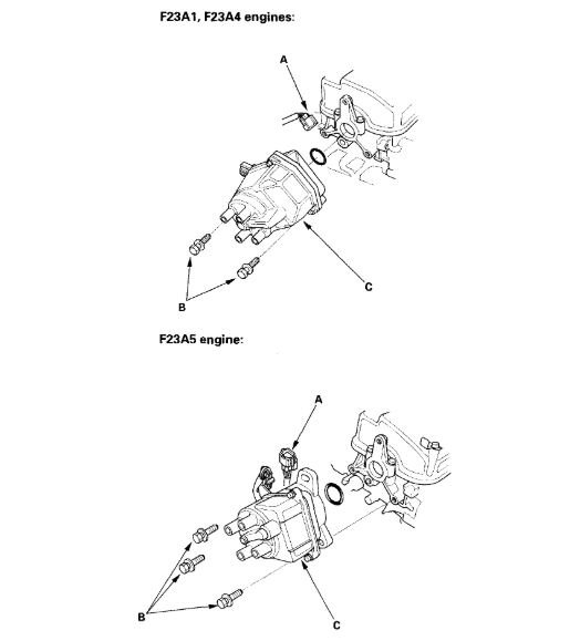

Engine stalls at idle after few minutes then will restart within three minutes. restarts easily and runs smooth at restart and first start.

When it does not start, did you check for spark and can you hear the fuel pump run?
It could be either. Spark is a more common issue.

Thanks for quick replay. It was fuel pump main relay.
