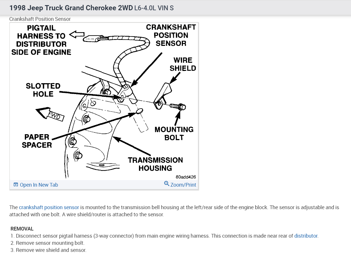

I had a five number five troubleshoot code on my computer for my vehicle that stalls when I'm driving and shuts off.

I am not sure of 5 number 5 code? Here is a guide to help you retrieve the trouble code so we can fix the problem:

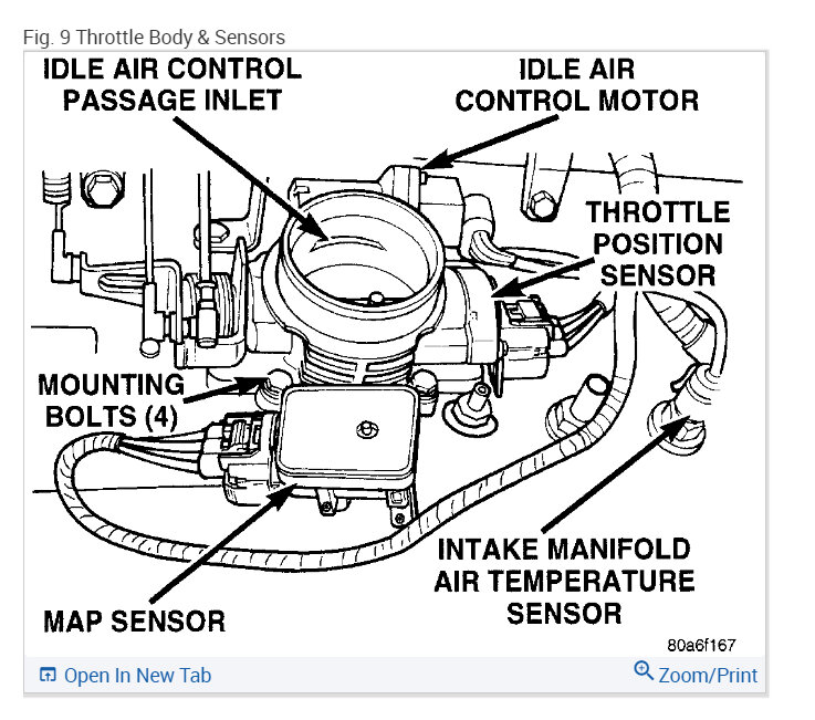

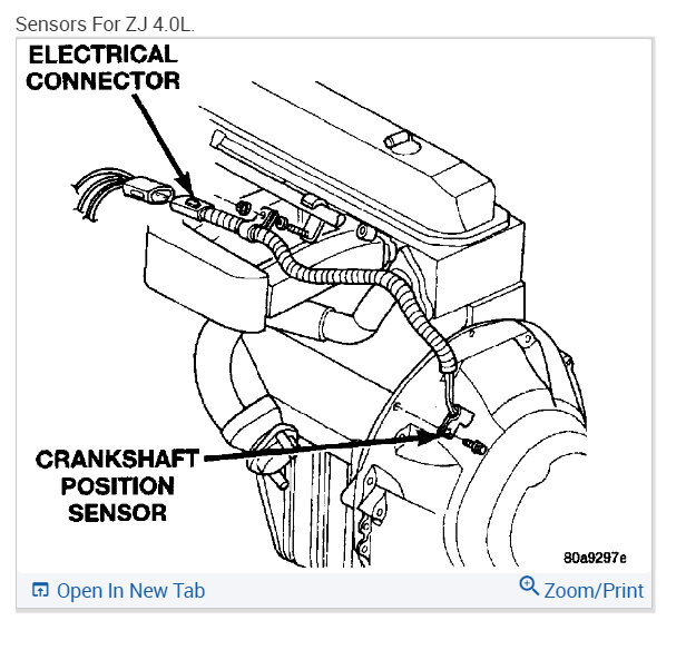

It sounds like you have a crankshaft angle sensor or MAP sensor that is going out.
This guide may help as well:
https://www.2carpros.com/articles/engine-stalls

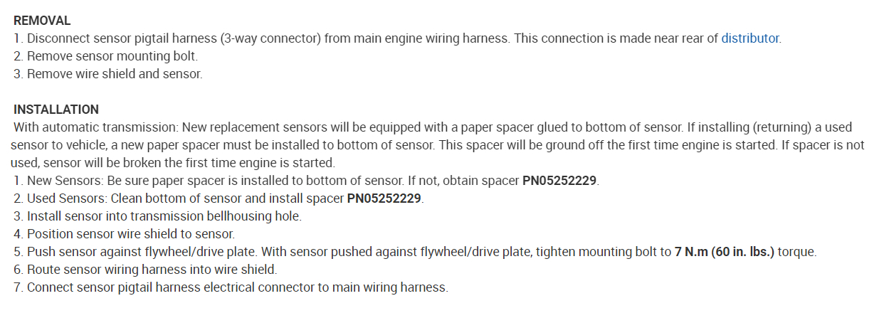

I have included the MAP sensor and crankshaft angle sensor location in the images below so you can check it out. Check out the images (below). Please let us know what you find. We are interested to see what it is.
