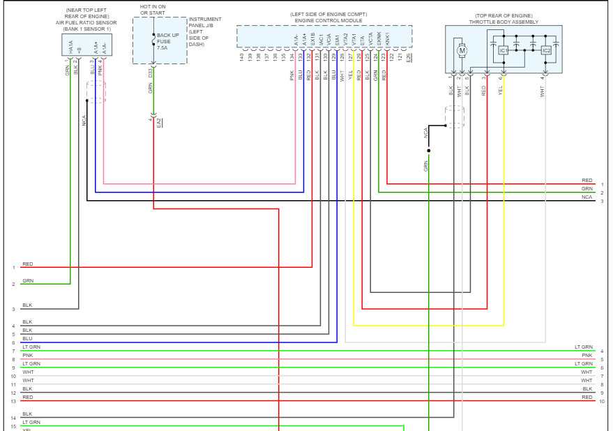

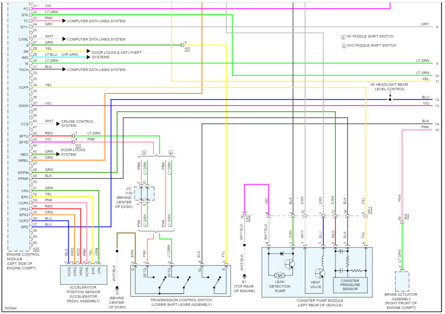

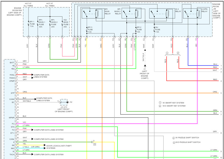

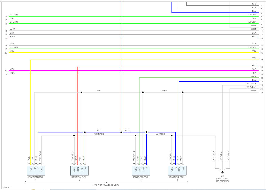

The Engine stalls after startup, the vehicle has been scanned but there are no codes. If ignition coil No 1 is removed, the effects on the engine performance won't be much. I have swapped the ignition coil but there is no improvement.
Could I the engine performance wire diagram to trace some of the wires?

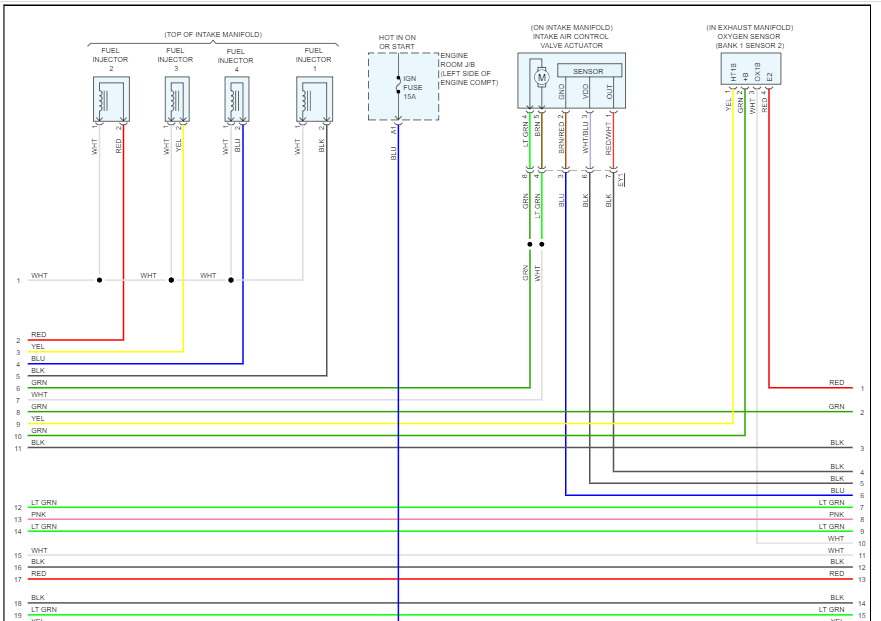

Are you sure there isn't a compression issue in cylinder 1? If you don't notice a change when the coil is disconnected, either it isn't getting spark, there is a fuel injector issue, or the compression is low.

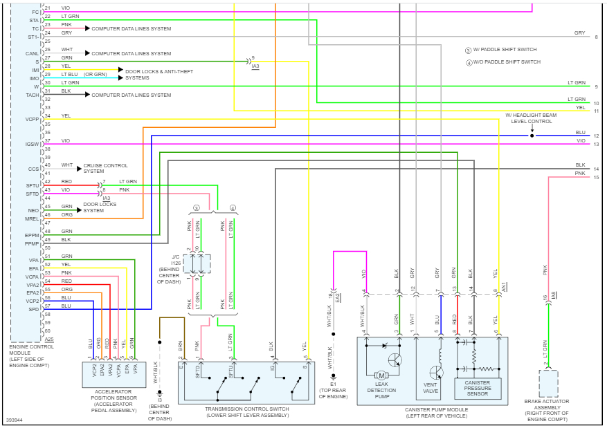

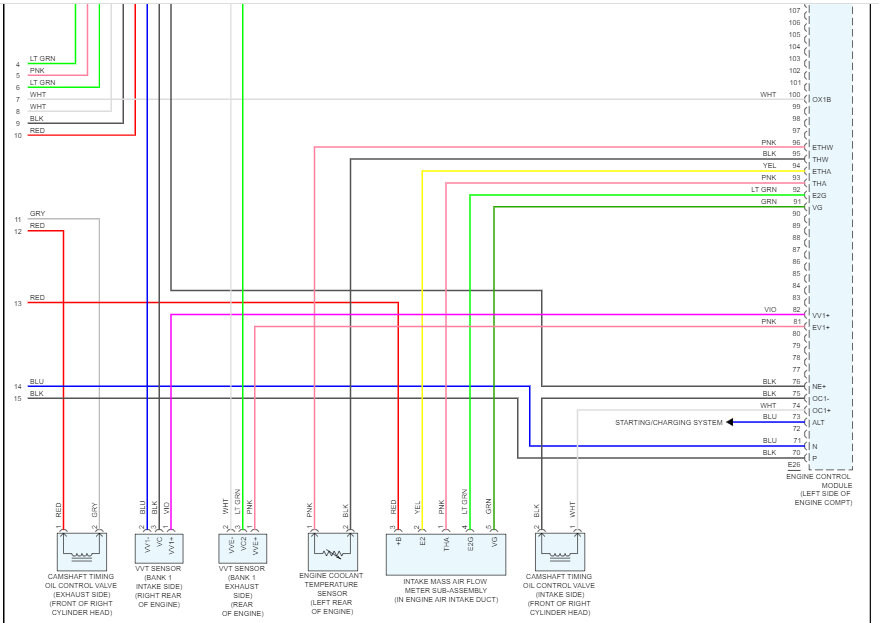

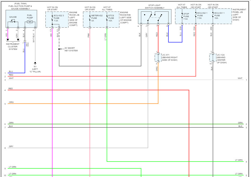

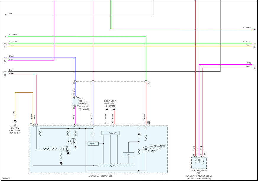

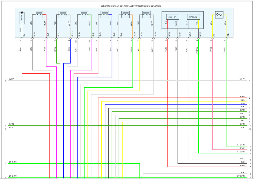

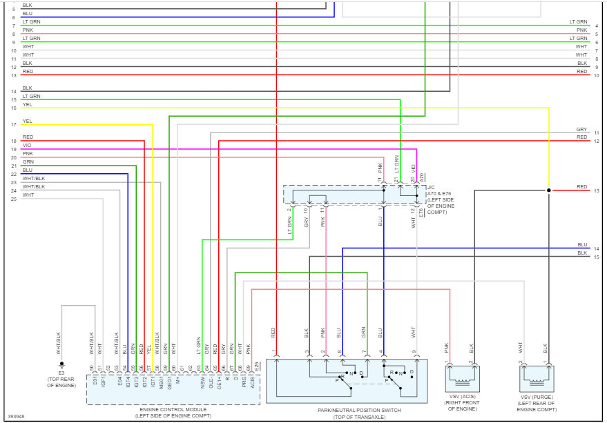

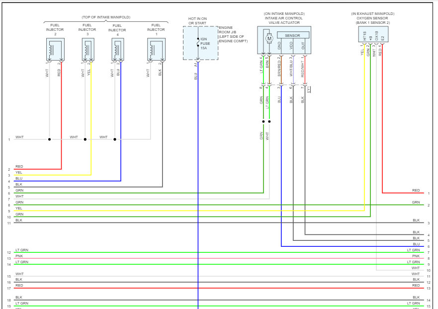

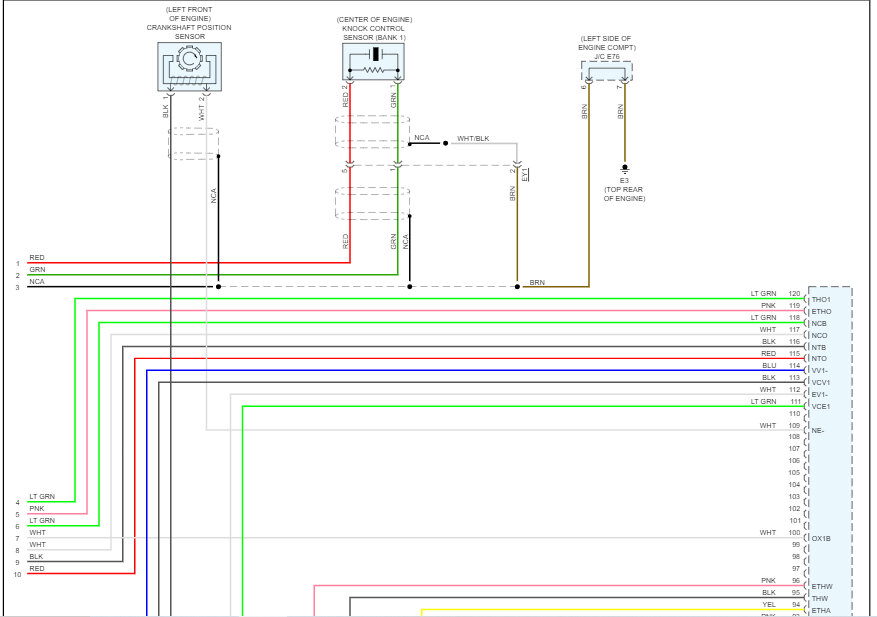

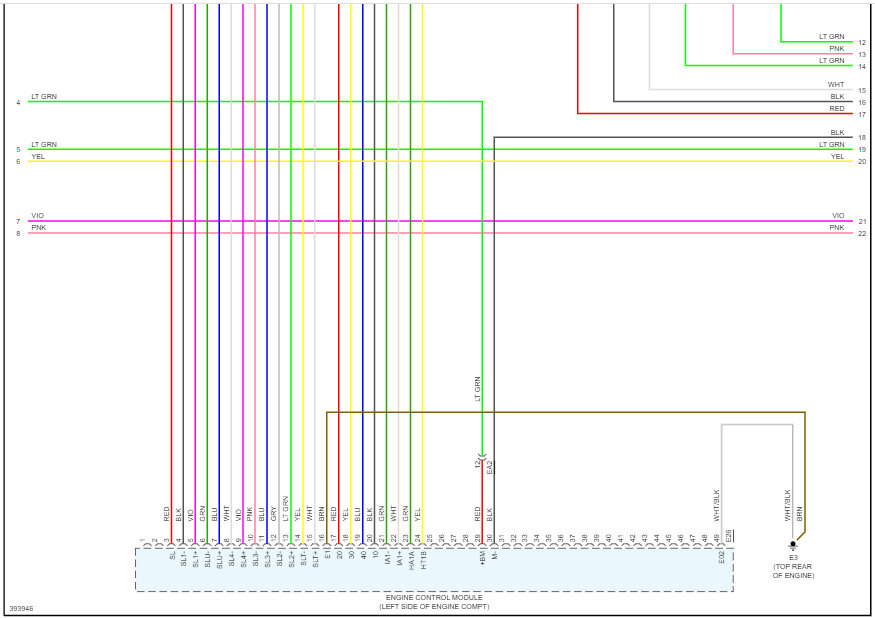

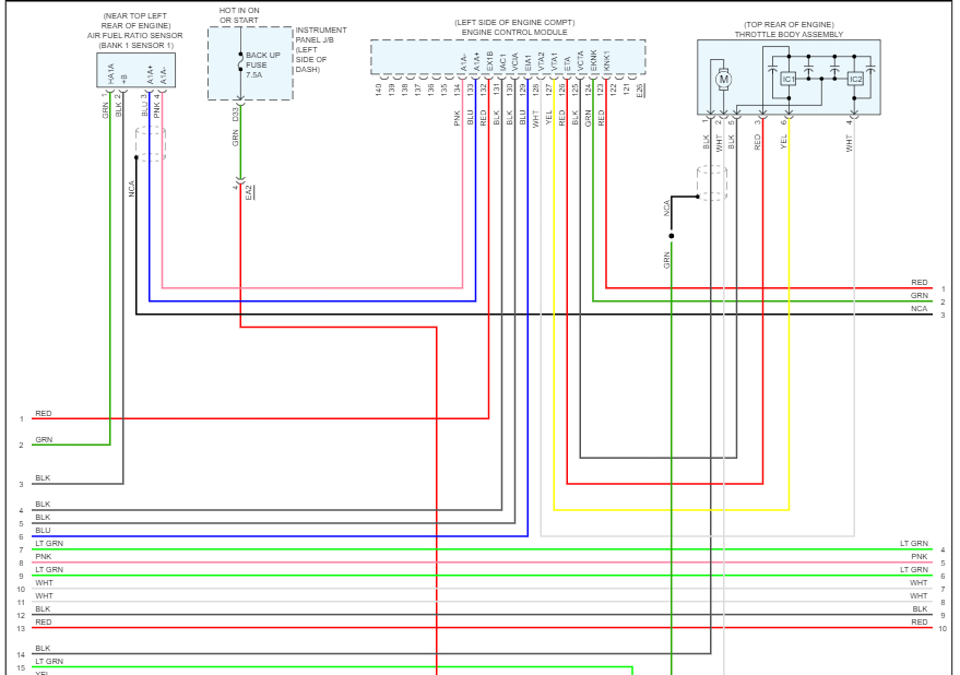

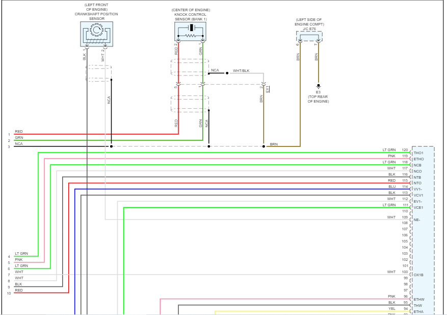

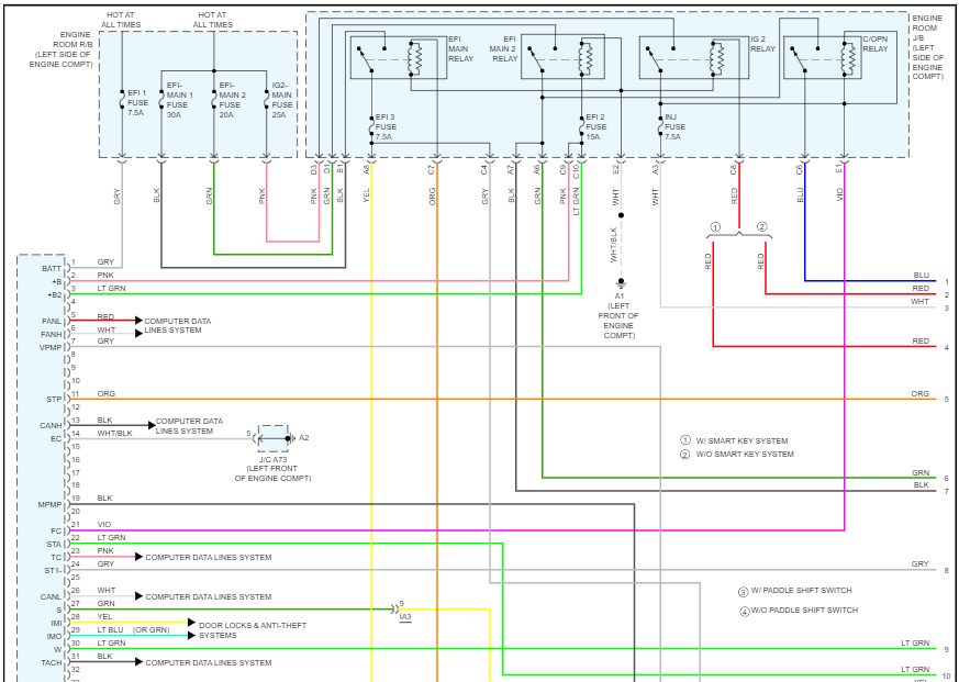

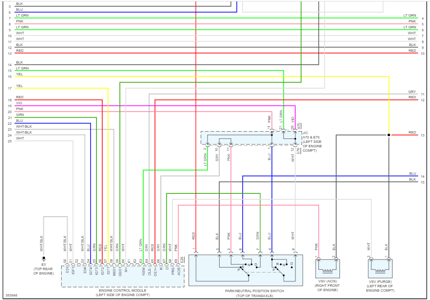

As far as the schematics, I'm not 100% sure which you are looking for, so I attached the powertrain management schematics. Let me know if that is what you are looking for.
See pics below. Note: The schematic was 6 pages long. I had to cut each one in half to make them readable.
