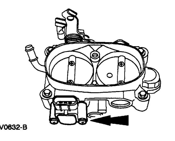

When car reaches normal driving temperature, engine will stall when put into any gear.
Apr 26, 2019 at 9:47 PM
Good morning,
The first thing I would do is to clean the throttle body of all carbon. That will cause stalling.
Beyond that, you need to have the system checked for codes to be sure there is not any other issue.
Does it stall in reverse as well?

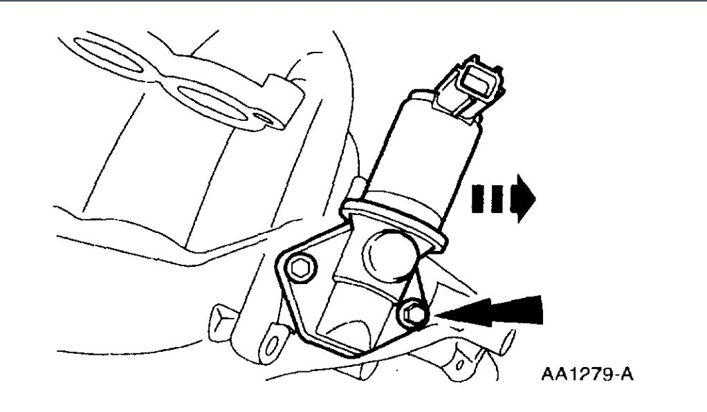

There is an idle air control valve that controls engine idle which may also be the issue but needs to be checked with a scan tool. Do you have a scan tool?

Okay, see if you can get a scan tool and check for any codes again and also see if you can command the idle air control.
Also, if you can give me long term trim readings as well.
