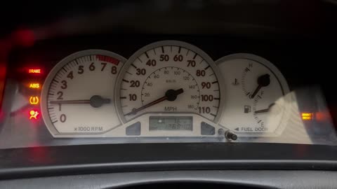

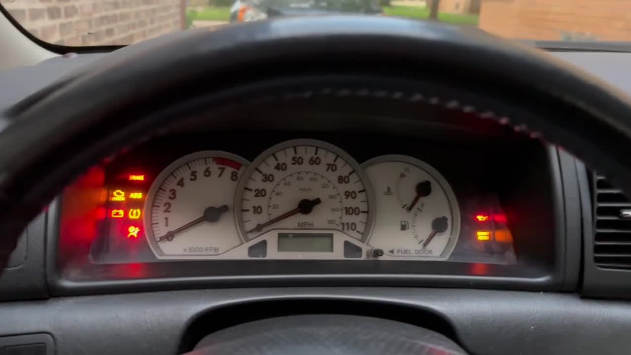

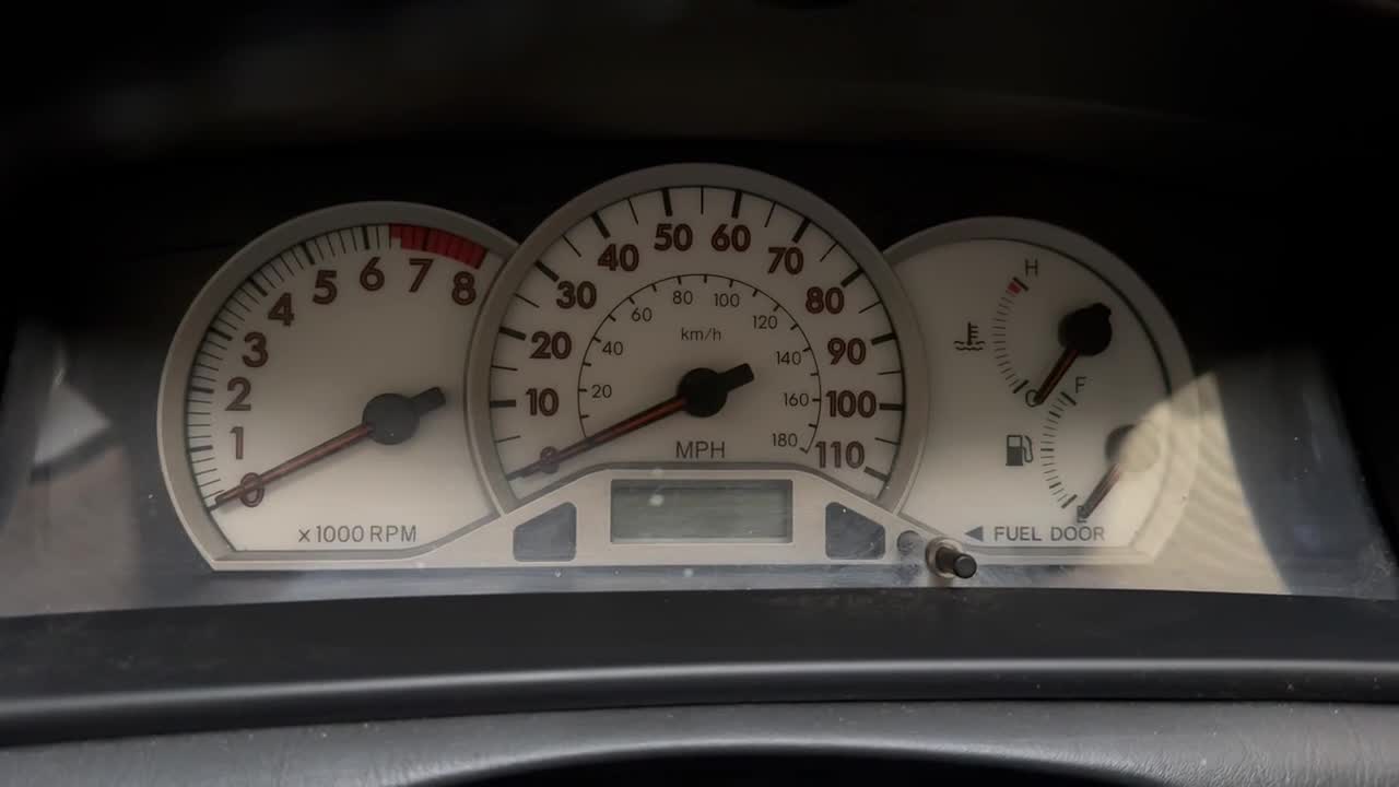

I had to turn the A/C on to shut off the engine in the first video. It does also grind a bit in reverse (second video) and when I put it in park, it shut off. The grinding in reverse has been for a while now, but the stalling in park is new this week.
Aug 7, 2023 at 11:02 AM
  • 55,064 POSTS

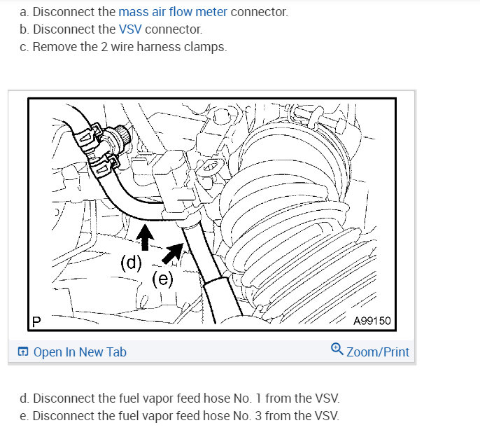

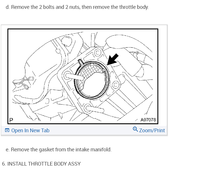

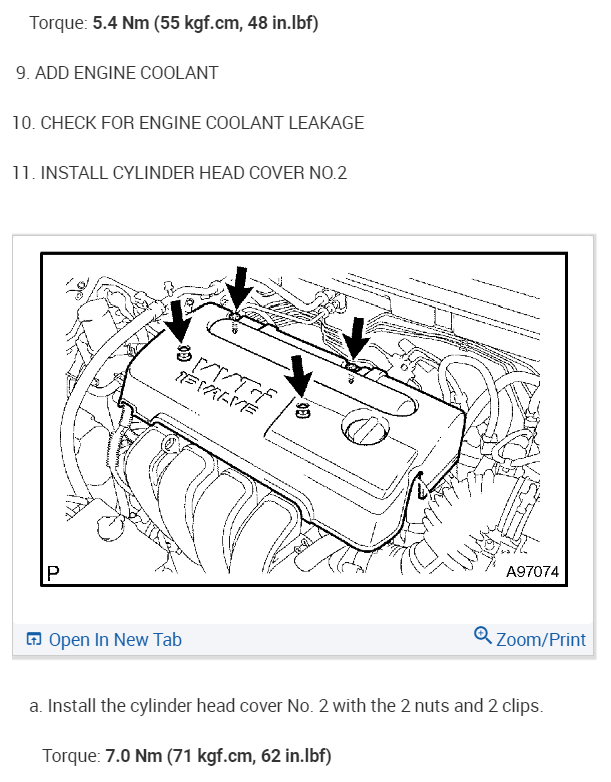

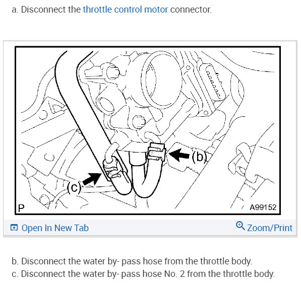

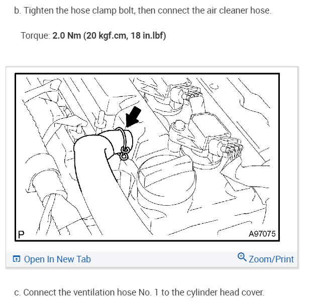

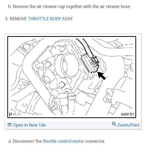

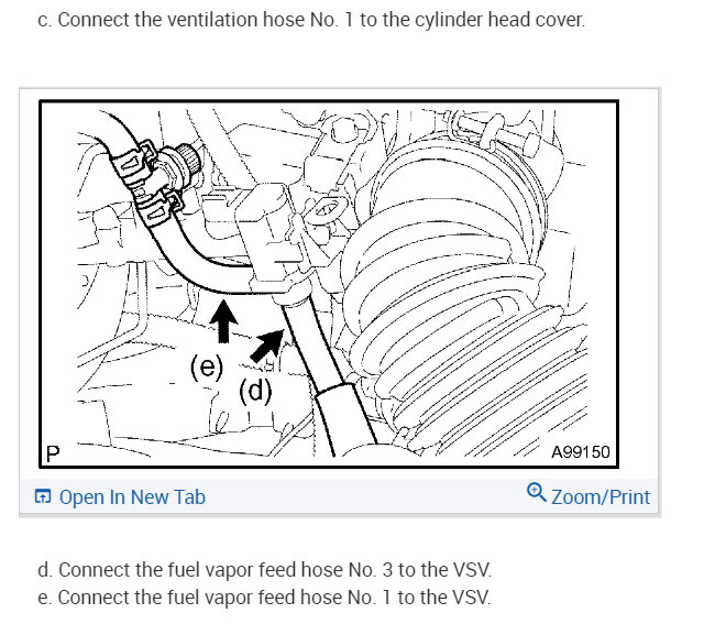

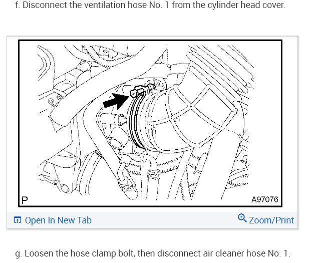

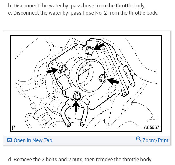

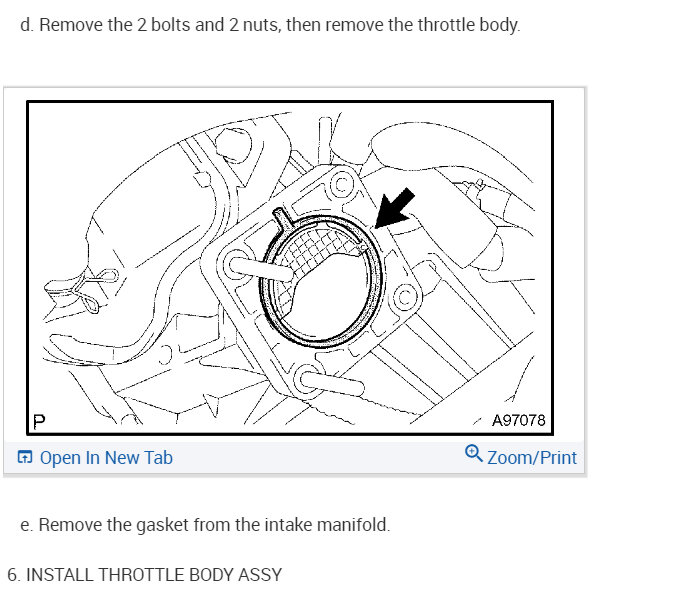

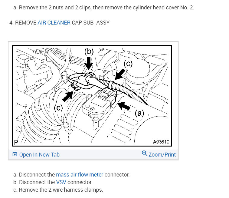

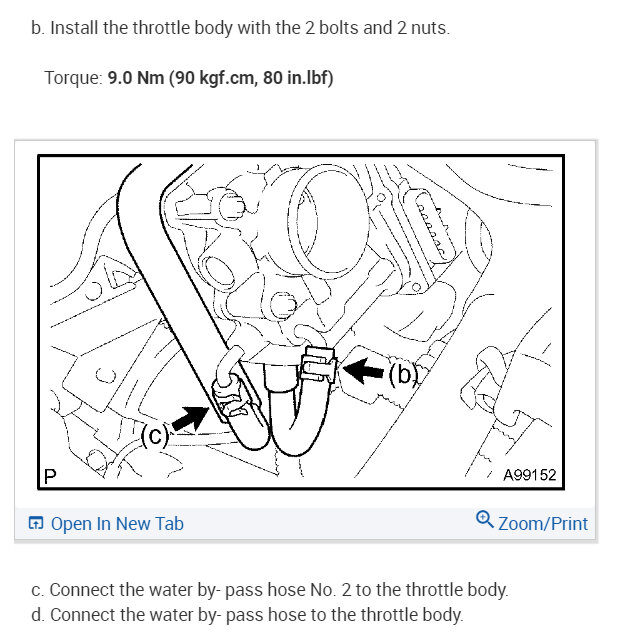

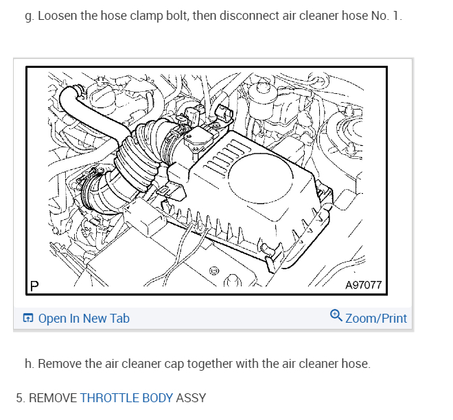

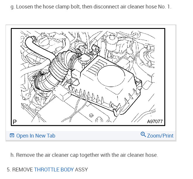

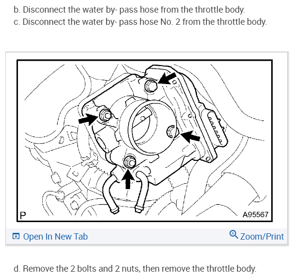

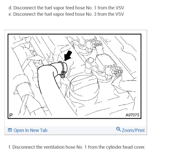

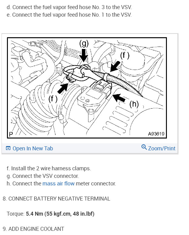

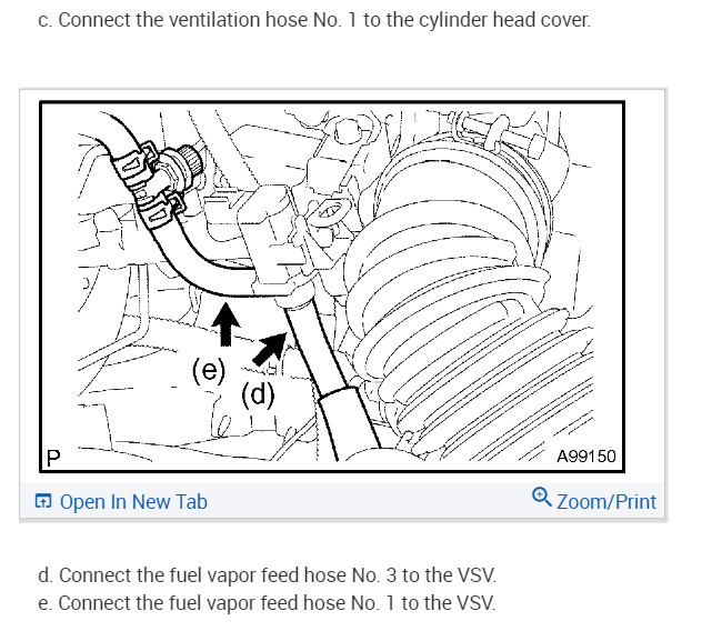

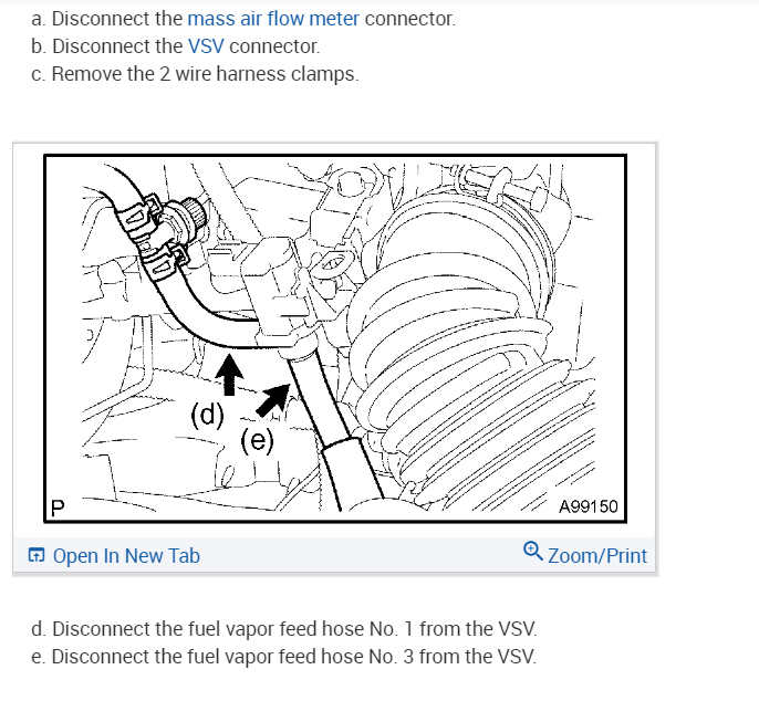

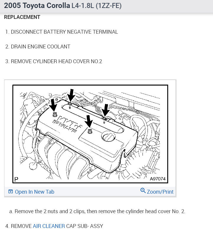

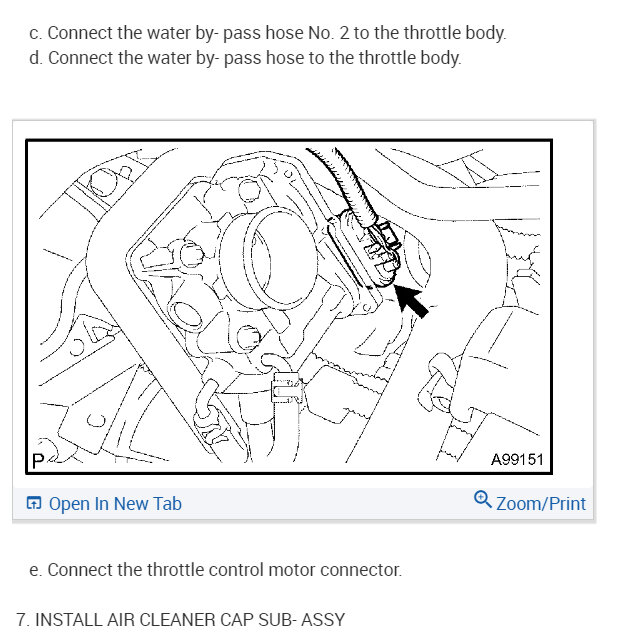

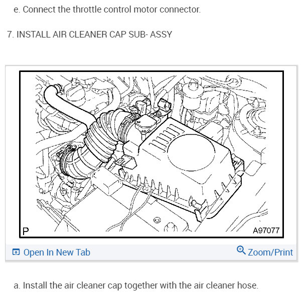

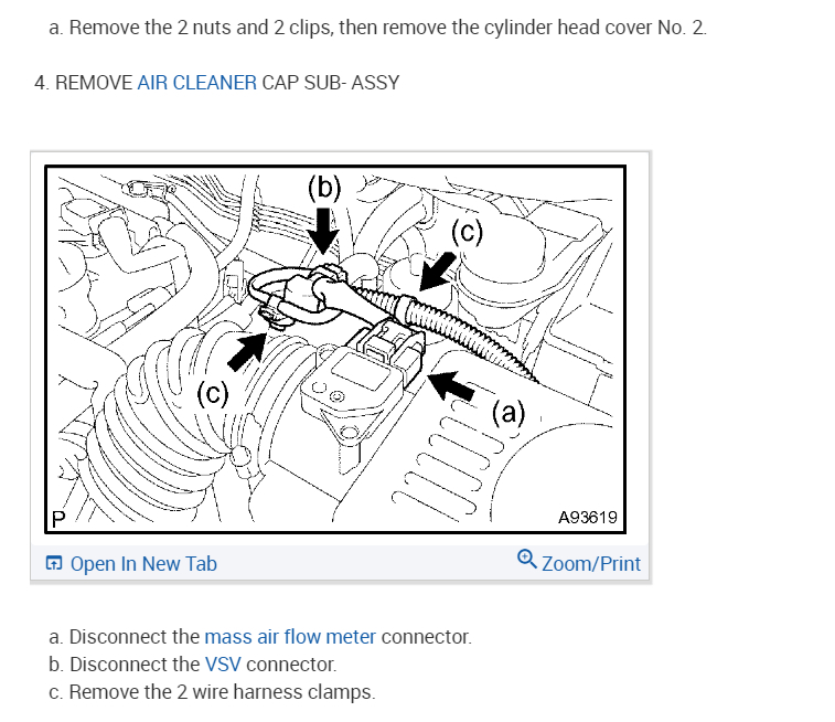

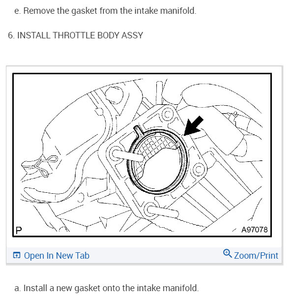

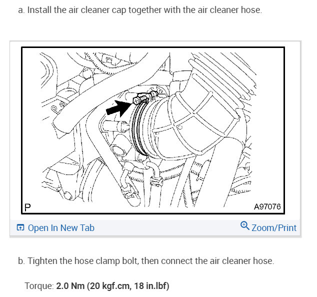

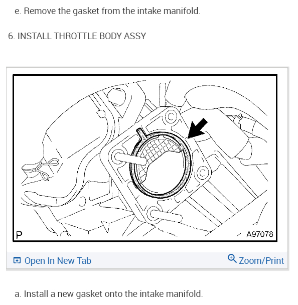

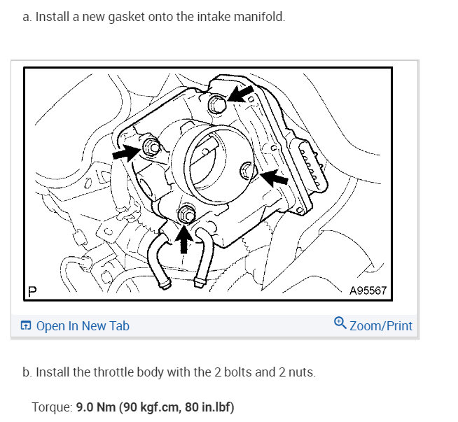

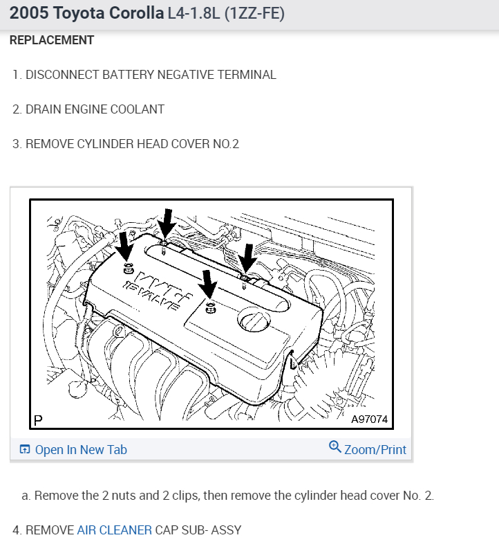

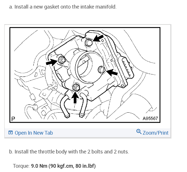

Thanks for the videos, they help. I don't think it is the torque converter which is good. It seems more like the throttle body needs service or you have a vacuum leak.
here are three guides to help us fix the problem with images below to help you as well:
and
And use guide when the engine is cold only:
Check out the images (below). Please let us know how it goes.
