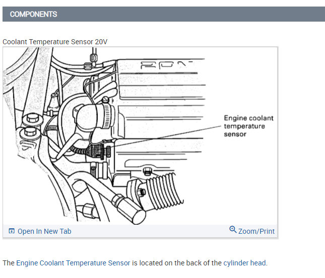

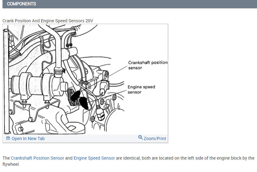

We will probably need more info in order to diagnose the issue.
For a no start scenario it could be simple as battery, but also can be fuel or ignition related.

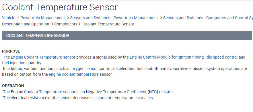

I have seen faulty coolant temperature sensor preventing a engine from starting or stalling.
Also crank sensor could be another possibility.
Do you know if your check engine light is on?
If so what are the codes?
