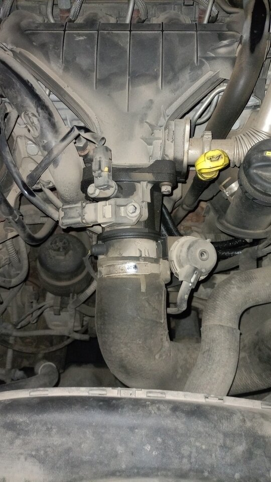

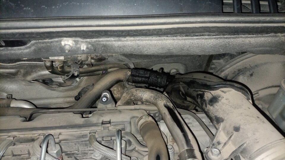

Hello. Can you please help me with my vehicle listed above 2.0 HDI, 136 HP? It has a rough and uneven idle, sometimes engine stalls (mostly when cold). Also, I'm sending you some pictures of oil leaks, which I don't know where they come from. I would appreciate any help. Thank you.

Looking at the pictures of the oil leaks it looks like the oil is seeping from inside the intake system out of the joints. This could possibly be caused by excessive oil bypass on the turbo or a possible issue with the crankcase ventilation system (PCV)
Being a diesel, this in turn can cause excessive soot to build up in the intake manifold and throttle body which could be causing the uneven idle and stalling.

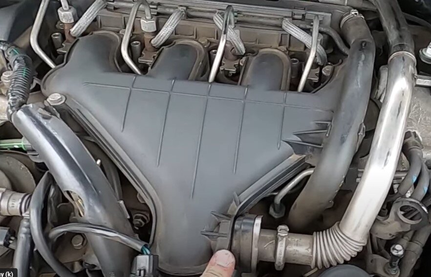

I would suggest to remove the intake pipe to the throttle body and have a look inside towards the butterfly.
A video:
https://youtu.be/YFVyhrC40eY?si=LsUUvMnrVxto_T-Y

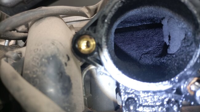

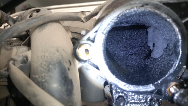

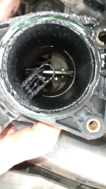

This is what i found when I opened the intake pipe and throttle body. I assume it is not good. What should I do?

Thanks for the images. It looks like crankcase ventilation may be dirty or the engine is starting to wear. Also, the MAF sensor in the image I would replace because the sensor wire is contaminated.

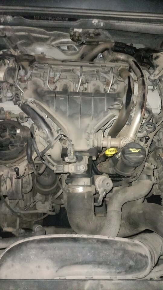

There is some oil leak in the engine bay of my vehicle listed above 2.0 HDI, 136 HP. I'm sending you some pictures of the oil leaks. Can you please tell me where this comes from? Thank you.

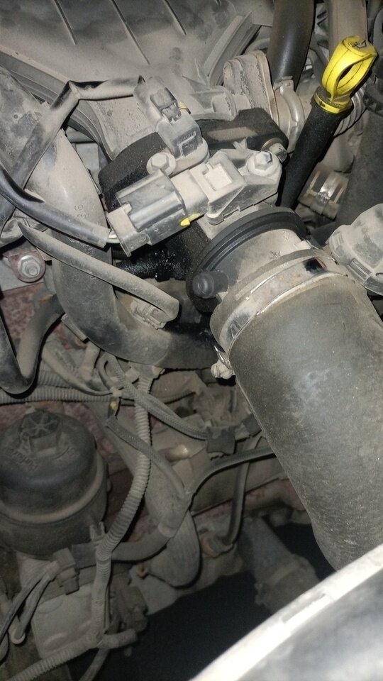

Here's some pictures from the oil leaks.

So, you think that the MAF sensor causes the rough idling and stalling? And how can I repair the oil leak, where should I look first, maybe turbo charger?

Cleaning the MAF sensor will not help, it must be replaced. I would remove the exhaust of inlet pipes to the turbo to check the endplay of the main shaft. Also, check the breather and crankcase ventilation system.

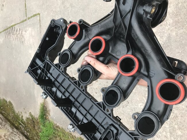

Do you maybe have a video or guide for taking off the inlet manifold of the Citroen C5, so I can clean it? (it's the part shown on the pictures I'm sending it to you). Thank you.

That looks good, I assume this is after you cleaned it? No videos to be found on the subject, sorry.
