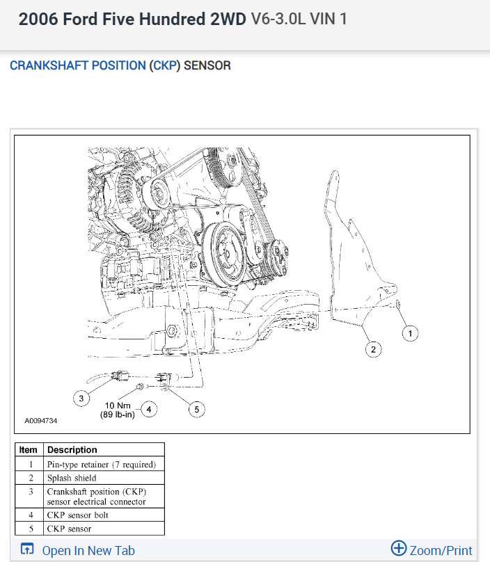

I replaced the valve cover gaskets and ignition coil o-ring. And the cover starts and idles fine however stalls when driving, I didn’t annotate but I think I lost oil pressure while driving. However I suspect a possible vacuum leak, I ensure my EGR was reconnected, all electrical connections, fuel lines, throttle bottle. Not sure where else to inspect.

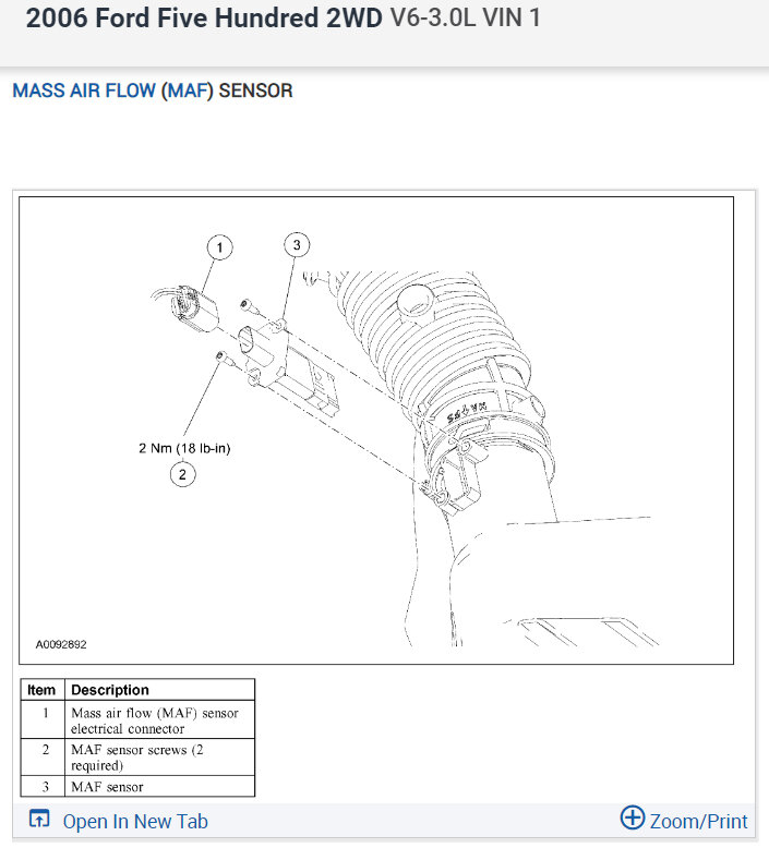

I have seen the MAF, and crankshaft sensor fail intermittently and cause this issue. But we should run the codes to see if any are stored.
This guide can help:
Here are the locations of these sensors so you can check them out. Check out the images (below). Please let us know what happens.

No codes are populating but I ensured the MAF is operating properly.

I got the car running now, appreciate the help. I replaced the crankshaft position sensor and found my fuel rail pressure sensor was loose.
