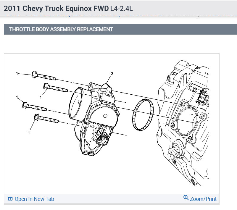

Only at idle runs fine if gas is pressed if driven too long like this the screen reads reduced engine power, but no change to RPMs, no change to speed or power. code read intake air temperature sensor, so i replaced it and the problem was not fixed. Also, cylinder 1 is running lean timing chain was just replaced due to broken guides, VVT solenoids both have been changed. i didn't notice the problem until after i changed the solenoids. I hope you can help.

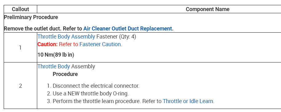

First make sure the engine oil is clean and full, next run the codes and give me the code numbers, then I would service the throttle body because it sounds like the vehicle is in limp mode.
Here is a generic guide to help you step by step with instructions in the diagrams below to show you how on your car:
