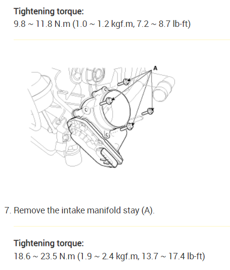

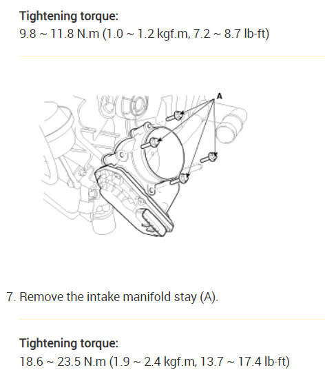

This is common when the engine has a vacuum leak or the throttle body needs to be serviced, here are 2 guides to help a us fix it. Can I ask if the check engine light is on?
and this guide can help you service the throttle body if you have not had it done with diagrams below to show you how on your car.
Check out the images (below). Please upload pictures or videos in your response of any problems so we can see what to help you with.

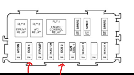

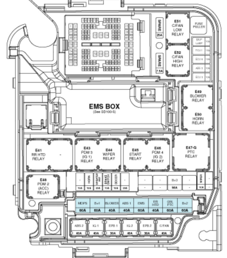

Were there any DTC's? Do you notice anything else that is not working? The first thing i would do it check all of the fuses, here is a guide to help:
Also, please follow the guides in the first response to help with the stalling. Check the fuses with the ignition system on. Check out the images (below). Let us know how it goes.
