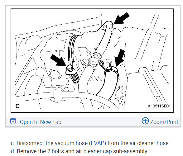

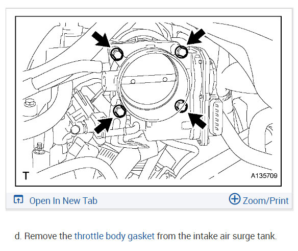

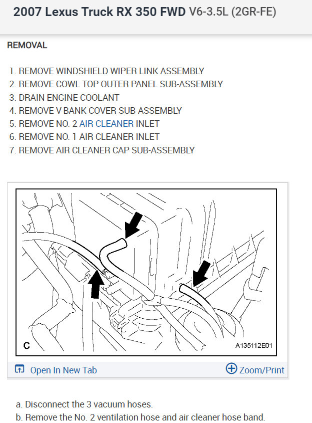

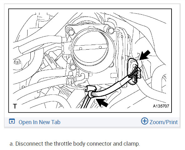

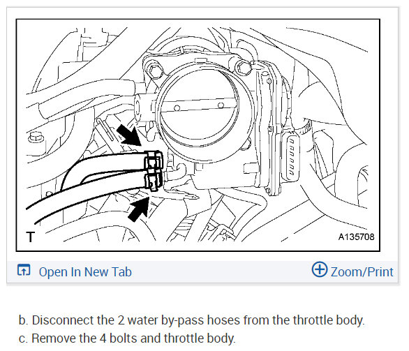

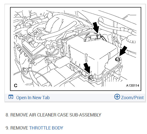

Stalling at idle is a common problem, most of the time it means the engine has a vacuum leak or the throttle bore needs to be serviced.
Here is a guide to help you understand what's going on:
Can I ask if you have a check engine light on? If so, you will need to run the codes to see which ones are stored, which can help us fix the problem.
Here is how to remove the throttle body so you can clean it. Please go over the guides and check out the images below.
